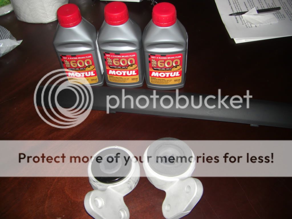

Bought some brake fluid and my bumper trim piece and fcabs came in today
Prob doing the brake flush and the fcabs this weekend. Will be around some of the Ocho NC Peeps.
You think 1.5L will be ok for the flush? I keep seeing on the forums to get 2L just incase.
