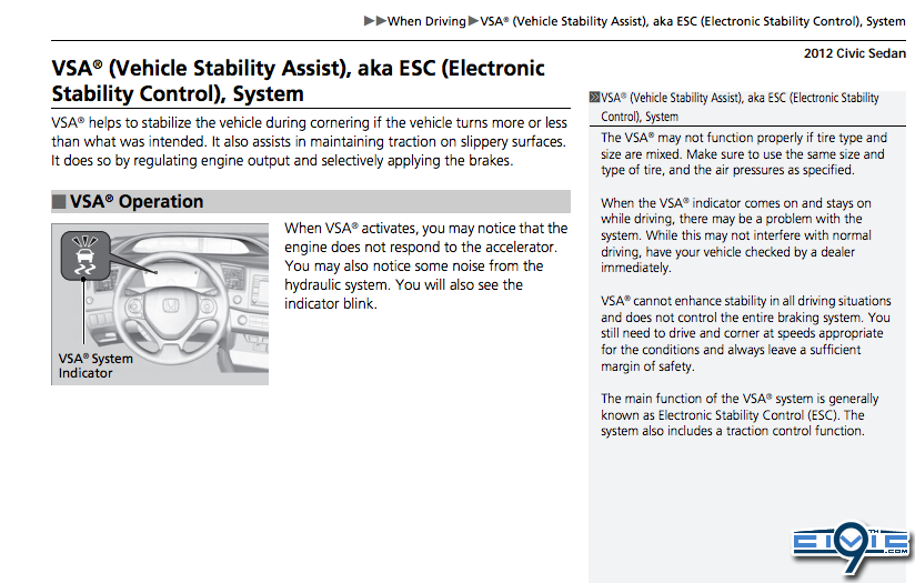

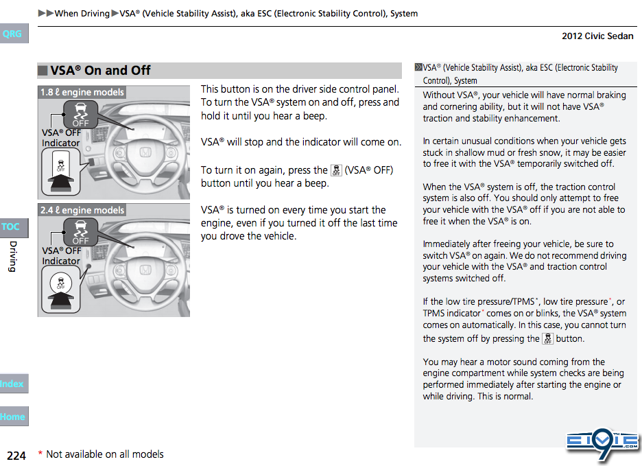

I have a question about this...... When turned off, does it effect the abs ? I can't find anything that says it's got anything to do with it........BUT.
vsa works by applying the brakes to specific wheels & cutting power...
webby I read all that last night, and it says it controls the braking and gas to the wheels........ I'm wondering if it effects ABS as well if its off.
What you posted is good info, but 'd like to know about the abs, I'm guessing we can't cancel abs ever.......
