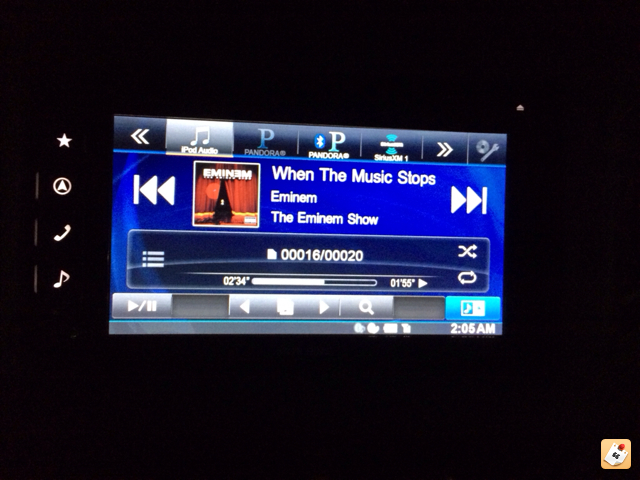

im looking for a good double din unit that looks clean has a responsive touch screen and aux as well as ipod inputs. just cerrious what you guys are running.
Alpine ine-920r
im thinking im gonna go with the pioneer 3500bt and run typ rs all the way around
part one of my system and my decision for my head unit.
