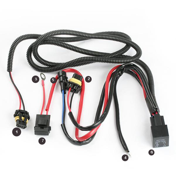

This is the wiring you want to get....
They go for pretty cheap. I would buy one if mine didn't come with one.
It is just a HID wiring with a relay. 1 and 2 would go to each ballast. 3 goes to power/battery. 4 goes to a ground. 5 goes to the drivers side stock light plug. 6 is the relay. 7 is a fuse.
