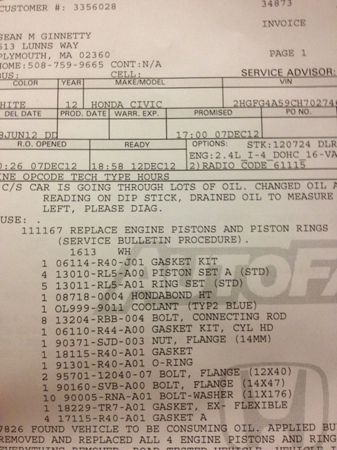

My pistons and rings are being replaced
Hmmm not feeling to good about this. I haven't had any problems, my mechanic hasn't said anything to me, but I do fall in range with this one.

My dealer basically went on my word, which is here say to them. I told them that at 4700 miles my dipstick just barely had anything on it when the car was warmed up, and that after changing it then, at 7800 miles the dipstick had fallen from just over the upper mark to just above the lower mark, both when warm. That was enough for them to look at it and stick a bore scope into the cylinders.
I don't know what they saw with the scope, but I'm wondering if Honda NA's stance has become, "if customer complains about oil loss, and car is in the TSB range, just scope it". I also don't know what the saw with the scope that made them decide this course of action, but when I get the full scoop I'll post the info.

I got the car back last night. The whole car just feels different. I know I have to keep in mind that it needs to break in all over again. It feels "tighter" like it doesn't want to rev, but I kept it under 4,000 rpm the whole ride home anyhow. It feels like power is down, and it has a bit of a different sound to it. I'm hoping things turn back to normal after I let it break in for a while.
As for the rev hang, I got the classic "we found no update for your car" response. To make it worse, the hang seems to be worse than ever. If you shift at over 3,000 rpm, it hangs for a solid 3-4 seconds now, where it used to seem more like 1-2. It's like I need to relearn how to shift it all over again. I have no idea what they could have done that would cause it, so maybe it was that bad before and I was just used to it.
