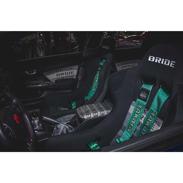

I know green Takata strap 4 points and recaros look awesome.
4 point harnesses do not keep you in the seat properly and you can and will submarine out from under them. That means getting smooshed into the dash and steering wheel. A full 5-point harness should only be used with a helmet due to the roll cage/harness bar mounting points. The stock seatbelt is really the way to go. The only reason I know this stuff is cause I wanted to do a swap also. It was too much trouble and risk in the end. No one plans on crashing. Just be aware of what you're getting into. Most bolt in harness bars are not strong enough to withstand the forces in most impacts. They bend and break. The 4 point harnesses also tend to "pull" the wrong direction and can cause some bad spinal injuries.
