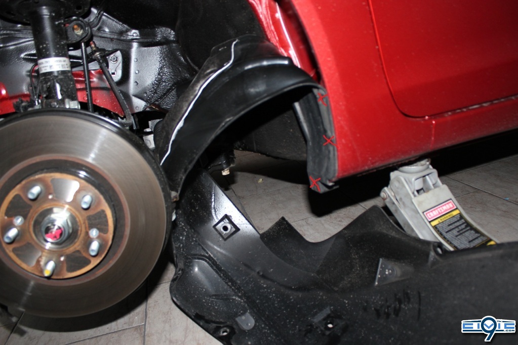

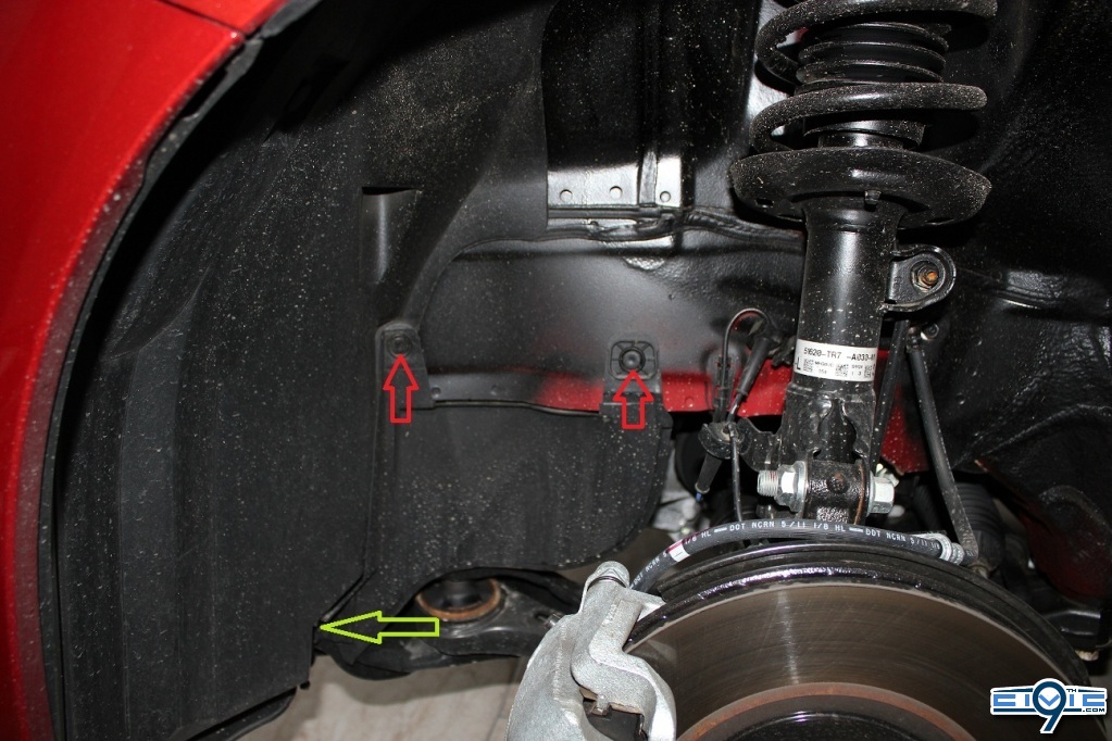

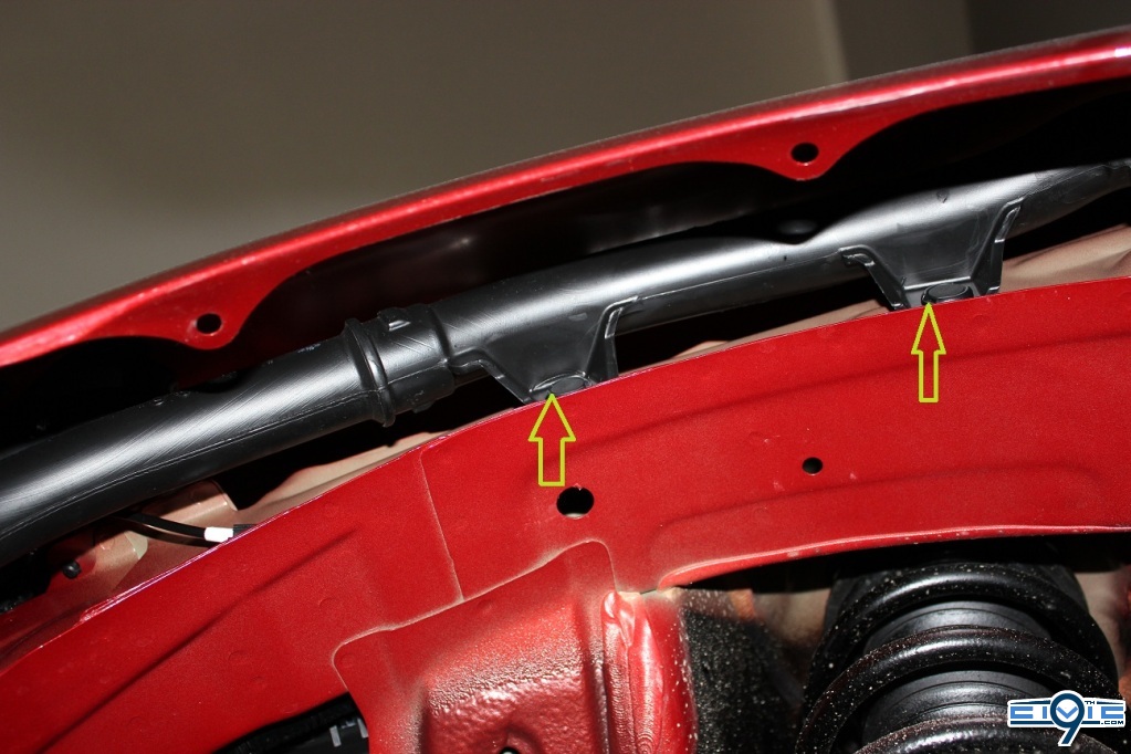

5. Use flat head to gently pry the middle piece of the 2 plastic retainers and fold the flap down. Where the green arrow is pull the little tab out of the wheel well shield
6. Gently pry all of the middle pieces from the rest of the retainers in wheel well shield (do not pull out the 3 that are x'd in red). I didn't get a pic but there are 3 more retainers that you need to remove under the bumper. Then fold the shield under the brake disc.

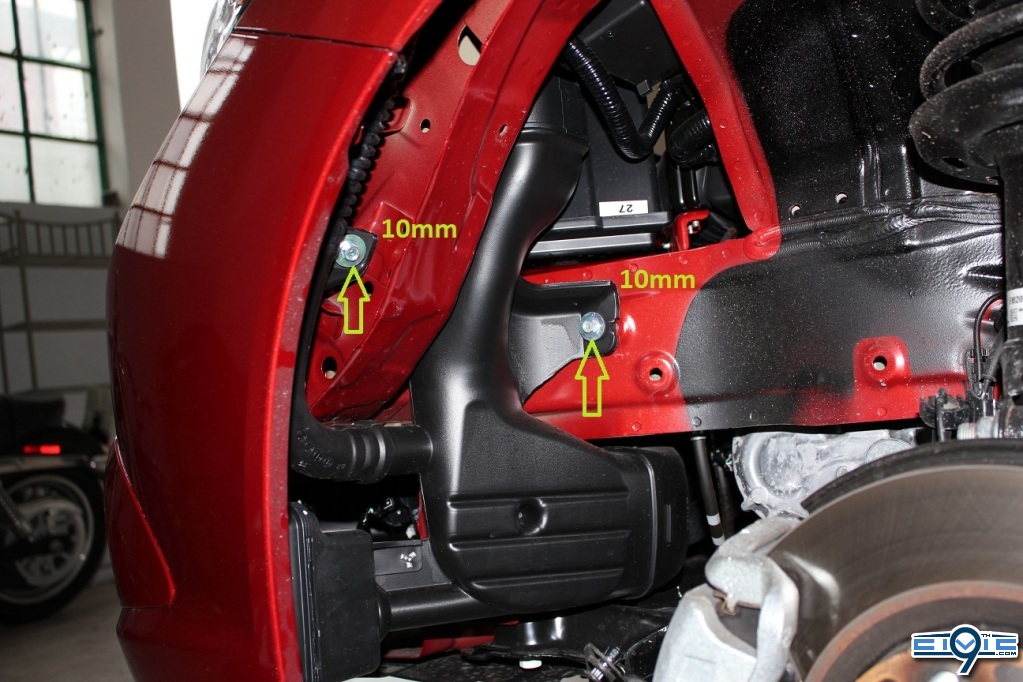

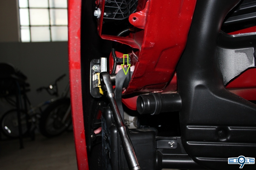

7. Remove the 2 10mm bolts

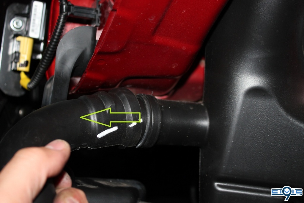

8. Remove the 2 retainers from the "snorkel"

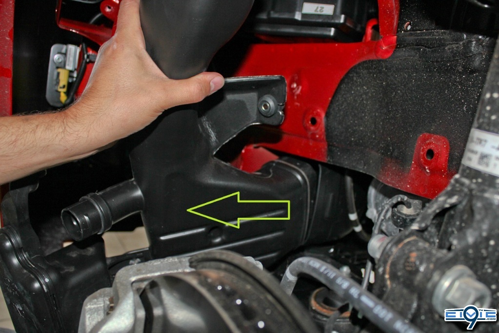

9. Remove "snorkel" from resonator box
10. Remove 10mm bolt hidden behind the plastic piece
11. Wiggle resonator out and down

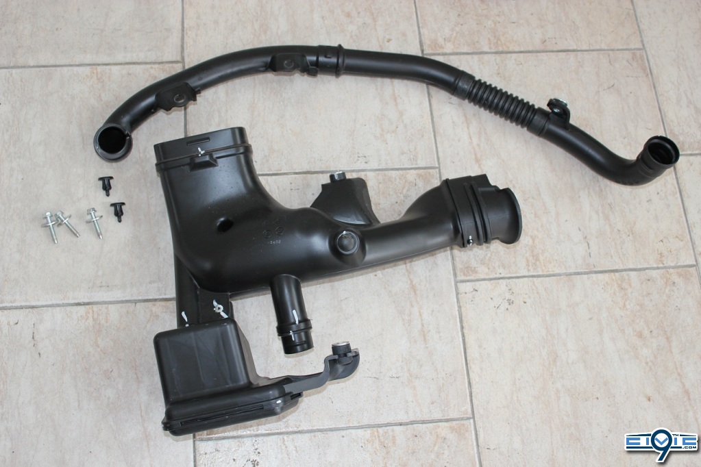

12. Here is what's left. Holy ground wires!
13. These are the parts you should have left over.
