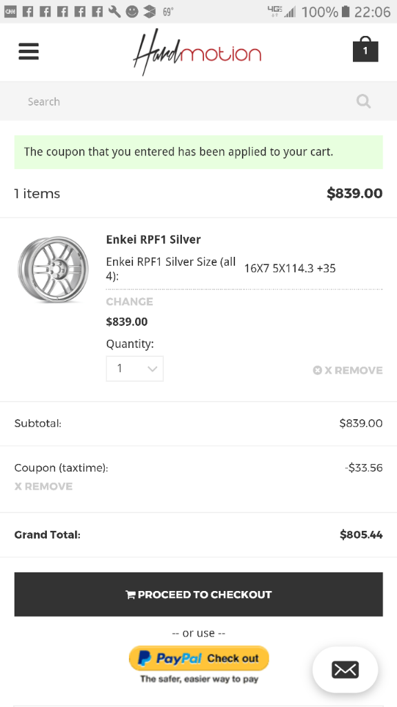

So I'm looking at these since HARDmotion is having a sale this month. Looking at 16's since I can reuse the stock tires and I won't be taking the car. It's my daily and I want to add some style to it. Does anyone have pics of 16's on their car and the specs? It'll give me an idea of how it'll look. Thanks in advance!

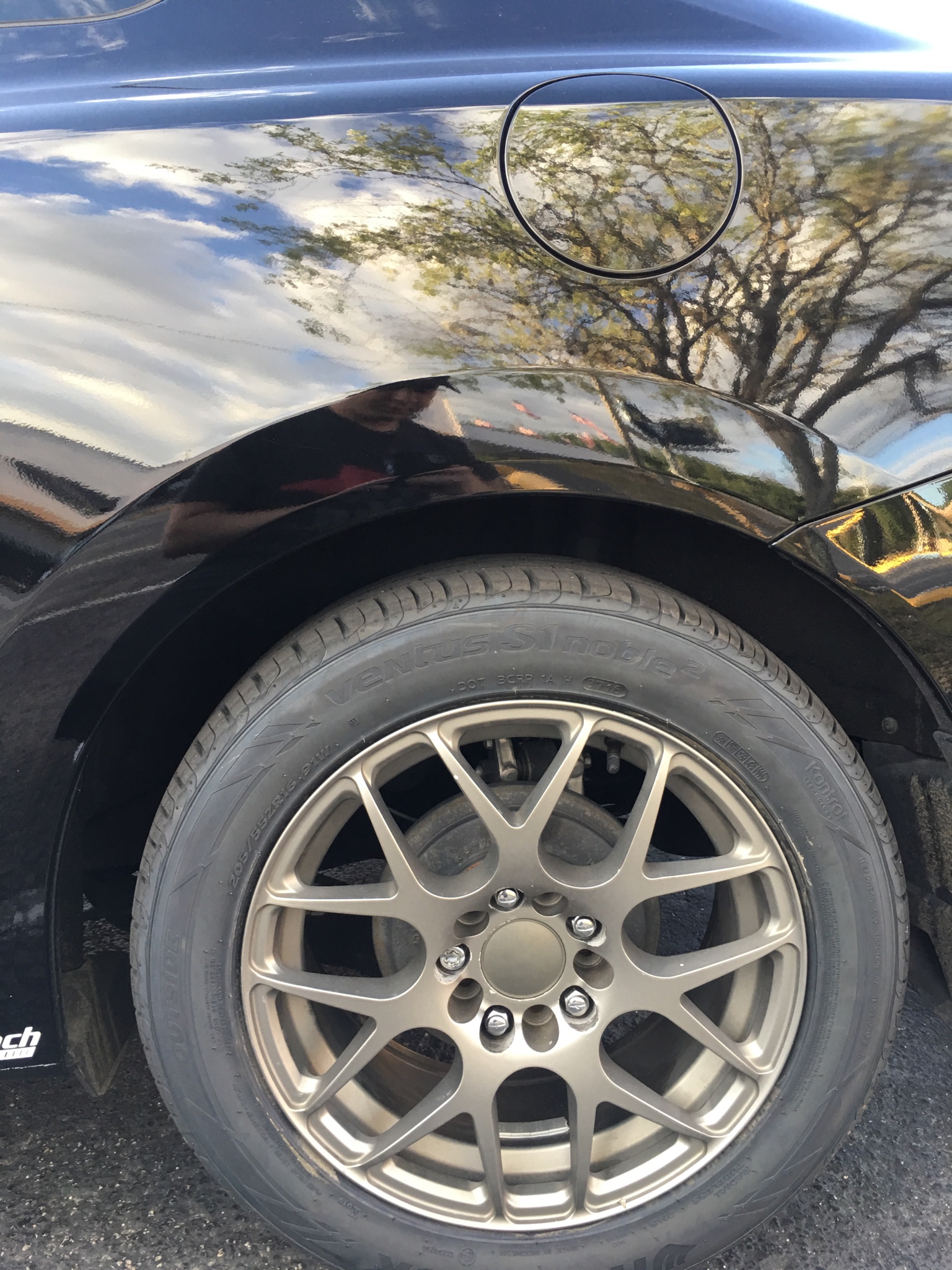

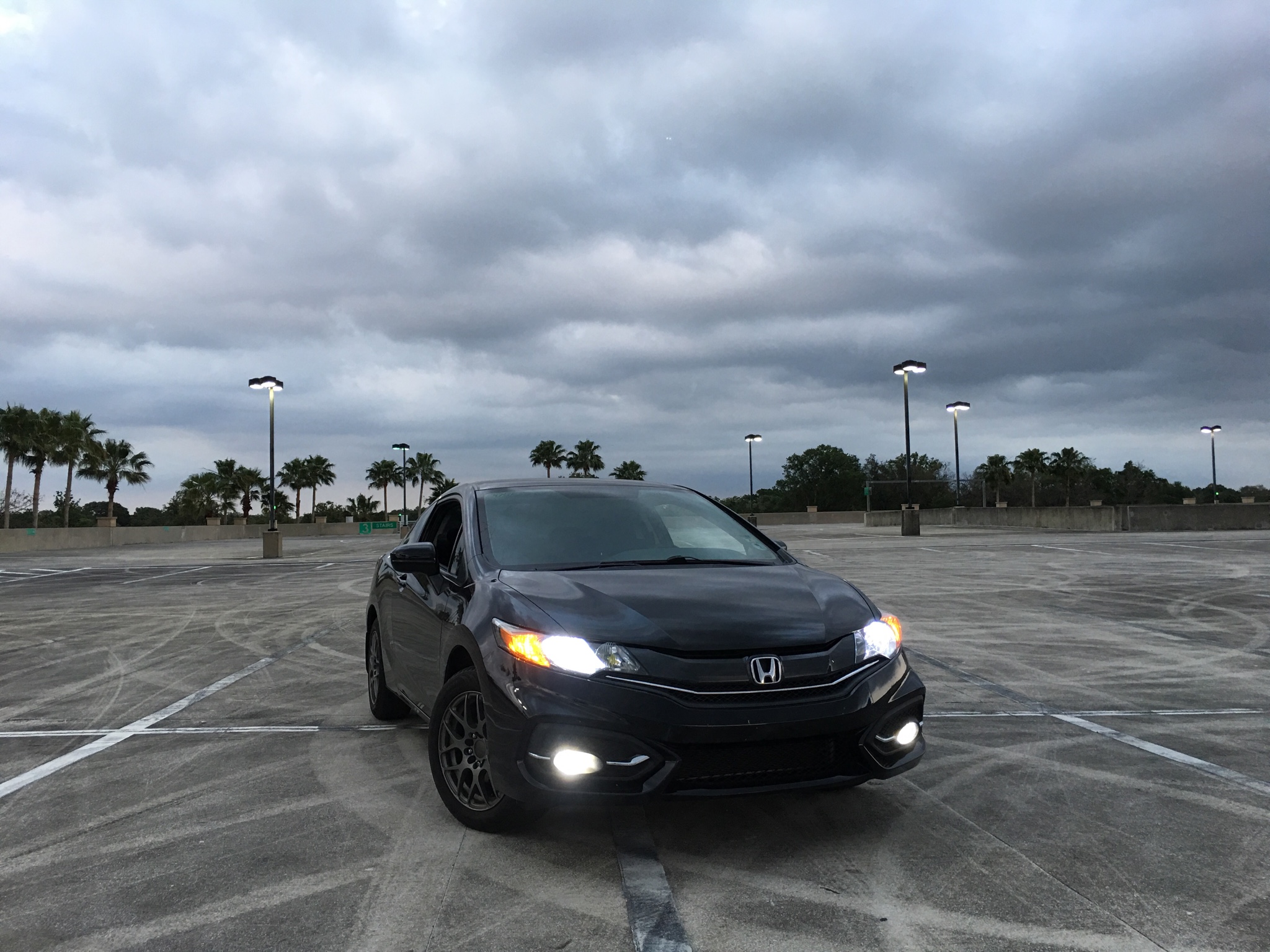

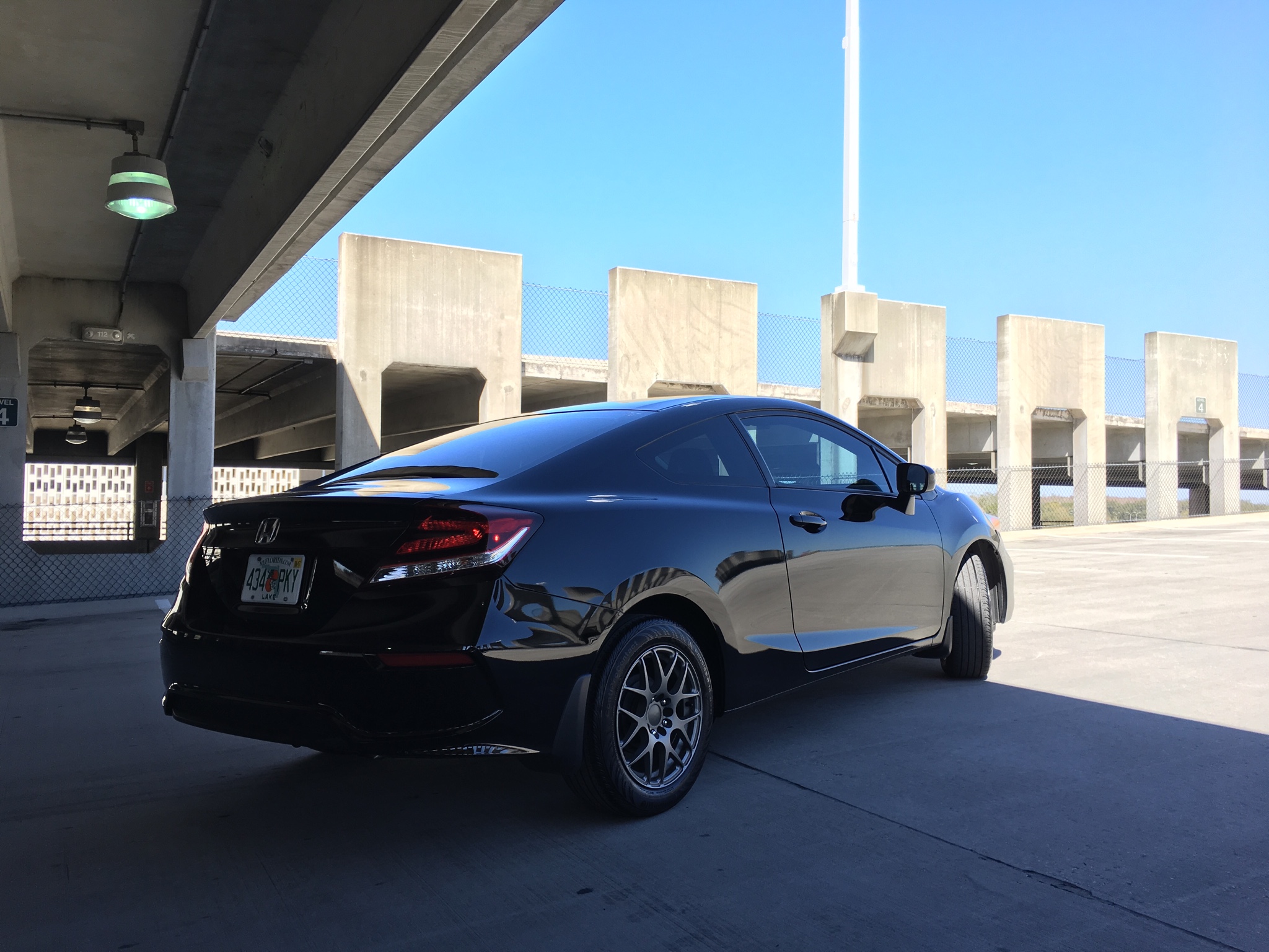

These are some pepboy rims (They were cheap and better looking than the stock hubcaps, leave me alone [emoji23][emoji23]), 16 inchers with the OEM tires. However it is on some Eibach springs.

No hate here, I'm lowered on truhart springs 2". I think this may have convinced me. Got a side shot?

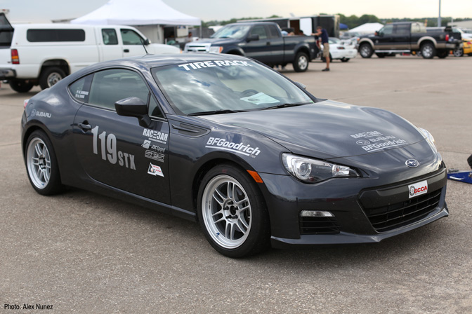

These are 17x9 on a Miata. Just know that due to the design of the wheel, the rpf1 tends to look smaller than it really is due to the lip design. So with a 16", you'd be an inch smaller than how this looks.

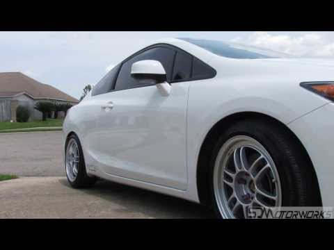

Here is a 16" - note the length of the spokes etc. The wheel design just tends to make them appear smaller than they really are. If you're good with it, by all means take advantage of the sale.
Be aware of how different this wheel looks in anything other than a 9" width. Ignoring diameter these wheels looks very very different depending on the width. Everything up to an 8.5" wheel width has the bubble face. They clear big brake calipers well but the 9"+ width is usually the one people see pics of and want.
Bubble face vs flat face.
9" width: Flat face
17x8" on a Civic: Bubble face.
EDIT: My .02 worth.... do it right, do it once. Save up and buy at least 17" wheels and tires. My personal recommendation is 17's on the coupe and 18's on the sedan. The larger body size of the sedan looks better, to me, with the larger wheel. Especially a wheel that already looks small as Webby pointed out.

Thanks that's what I assumed. Might be pulling the trigger on these soon...more to follow
