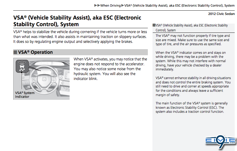

    I'm going to lay it out plain and simple. I installed winter tires and wheels on my 2012 Civic EX. Since I did not put TPMS sensors in any of the wheels, I get those nice 2 lights that light up and the iMid yells at me. Here is my question. Is there a way to turn off the traction control since there are no TPMS sensors on the car? I was driving during very slick conditions and with it on I felt like I had less control of the car. Did not like one bit. I have tried starting the car and holding the button down for a few seconds before doing anything else. That has not worked. I have tried turning the power on, holding down the button for a few seconds and then turning the car on and that has not worked. Is this even possible?

    Traction control cannot be turned off when the tpms warning light is on. The two systems are linked. The only way to turn traction control off is with the sensors on the wheels. The traction control is limiting the amount of power to the wheels.

    I'm just guessing here till someone chimes in that might"know", but I wouldn't think the TPMS has anything to do with the TC . According to the manual the TC comes on when you start the car(no matter if it was on or off when you last turned the car off. So starting the car it will be on, and to turn it off you hold the button down for 4 min till you hear it beeb.... now it's off.

  5. webby
    • 2017 Toys For Tots
    webby Administrator
    Messages:
    47,791
    2nd image I posted above ^^ 2nd to the last paragraph on the right hand side of that image.
    "If the low tire pressure/TPMS..."
