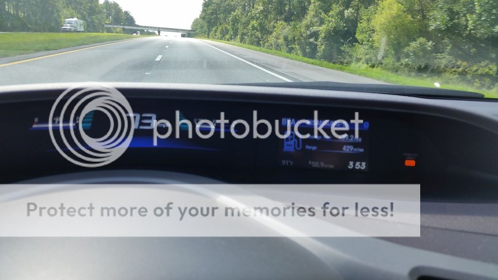

I have a 2012 EX.... The only way to see what your car can do is to get on a road where it's continuous flow. Fill your tank and reset your mileage counter, right at the highway entrance and go about 100 miles, then U-turn it back. Using the conservative methods you have been using...... You can run the AC (I've gotten a high of 48.9mpg with mine on). Check your tyres pressure(located on sticker in driver door jam).
