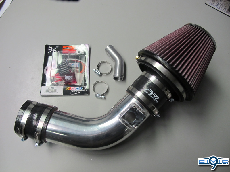

Not sure about other intakes, but it is noticeable with a 3.5" PRL SRI.

There is definitely a noticeable changeover and a mean growl to it (it tends to drown out my Full-Race Downpipe and exhaust). That being said, this intake requires FlashPro and a tune.

It's a 3.5" intake so you'll need to tune it since anything bigger than 3" without a tune will not run right, or at all.

Unless you get a 3.5" intake, you will not see gains over stock from any other intake...and possibly a loss in power. I believe the K&N is one that results in a loss of power.

The brand is not the issue. The intake size is.
