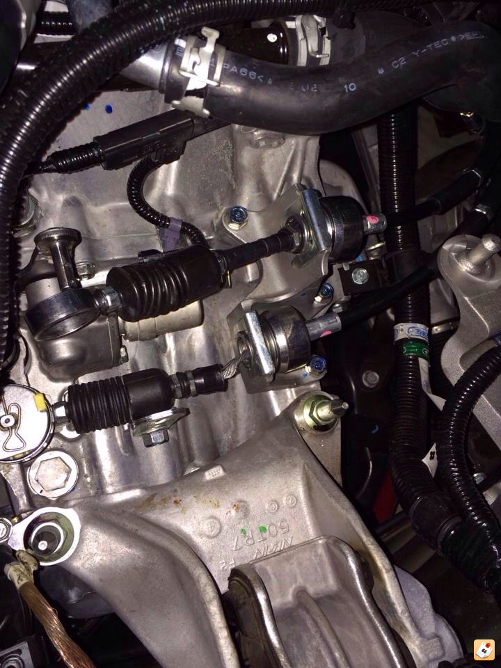

How did you bend them?
Shifter cable bushings, the number one result of not installing them carefully :giggle:
Hopefully aftermarket will bring better ones eventually, thanks for the insight, it's helping me
Contact Hybrid Racing, IIRC the 8th gen cables fit the 9th gen. They offered me a set when I bent my cables but I passed. They are pricey though.
See I think that was the problem with mine , they put an aggressive Angie on the cable and there too tight,
Yeah those are bent cables. Not fun to drive around with lol. If you end up looking into the Hybrid Racing cables you don't have to fiddle with the bushings as they're built in, unlike the stock cables where they can be popped out.
So the same happened to you ?
Yeah, twice actually. Once a couple years ago but I was able to get them replaced under warranty. And a couple months ago I wanted to try cable bushings again I bent one of them very slightly, so I just decided to replace the cables and do away with the stiffer bushings. Which bushings do you have?
