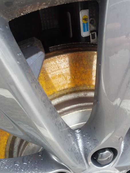

Don't worry about the imprint. It'll burn off in one or two good stops. It's most likely just surface rust. Most rotors have a really high iron content and will "rust" overnight. High performance polished rotors tend to oxidize really quickly. That imprint is just where the pad protected the rotor from ambient moisture. My brembos turn completely orange overnight if it rains hard. Comes off when I back out. Looks bad but isn't an issue. You're just seeing a high quality rotor do its thing. OEM rotors balance looks, life, noise, etc. It's a big change going to a super high performance setup. Lots of new noises and things to get used to.
8 hours or less parked in the rain does this to my rotors:
capture1-jpg.20033
