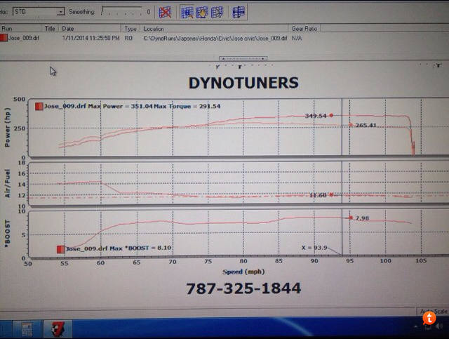

Edyno I do believe arw accurate. But someone hwlp me with the numbers.
Downhill would make it read high or low?
Increased weight would make it read high or low?
Lower temps would make it high?
How does humidity and pressure affect the edyno?

if you increase the weight on the program. it will read high obviously because it thinks you moved a 5000lbs car as fast as a car that only weighs 3000.
I'm not positive but pretty sure that: downhill would read high because it's easier to go downhill. Lower temps read higher 'cause denser air, high humidity = denser air too. But higher altitude = thinner air, so lower number.
