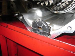

Last week, one 2011 Mustang owner stopped by the dealership while they had his MT82 transmission cracked open, and took a picture of second gear. Bits of the gear had shorn off and were collected with a magnet from the fluid pan. The owner said the car had never received rough treatment:
The synchronizers themselves show some wear but are not really that badly torn up. The blocker rings (you can see one in the picture (the brass part)) are in relatively good condition so the gears and synchro's should be speed matching fine. This leads me to believe that the problem is a combination strong Synchro's and soft metal on the gears. So in other words, I think they are breaking from torque loads that soft metal in the gears can't handle...
Other shade-tree diagnosis has suggested the linkages were misaligned, but there's really not much even an owner with an engineering degree could do to fix the problem on their own. Ford itself may be stumped for an answer — one downside of relying on a global supply chain where engineering, manufacturing and final assembly happen on different continents.
