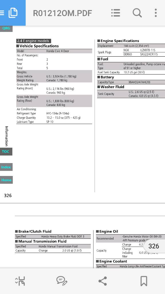

I had this done at the dealership and noticed they charged me for 3 quarts of MT fluid...is it 2 or 3...or did I get ripped off?
Per the owners manual 2.0 quarts exactly
