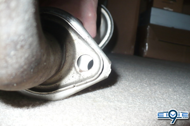

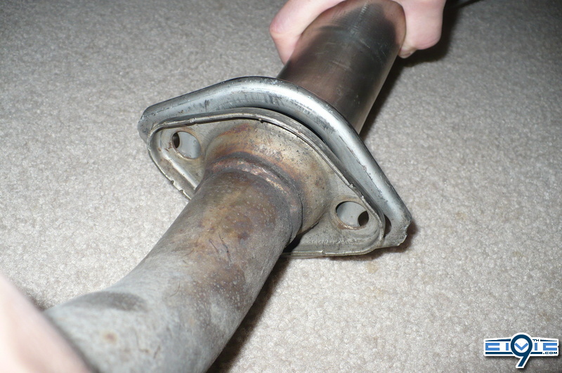

First off the flange on the end is completely the wrong size.
I had thought the possibility to drill the flange existed but as you can see that would require drilling into the area where the gasket sits, & there is not enough material to drill towards the outside either.
It's not even close. So what to do?

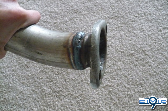

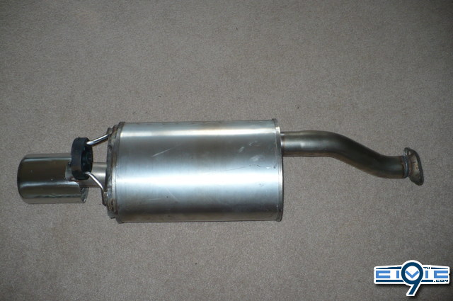

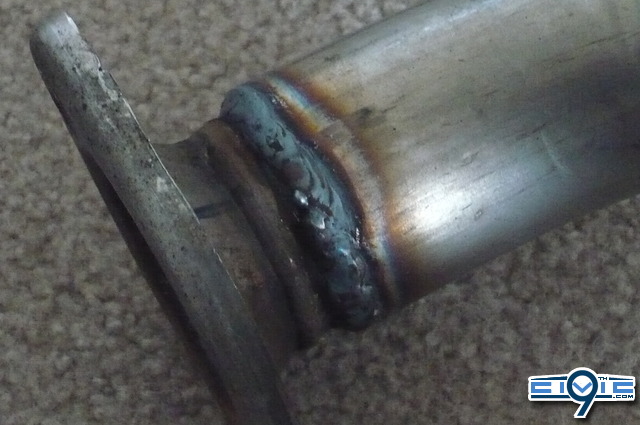

I took both mufflers down to the local exhaust shop and had them cut the flange off the current R18 muffler and cut the flange off the new Si muffler. Then they welded the old one onto the new one. They did a pretty nice job. I gave them a lot of freedom and said "just make it work." I didn't care where they cut/welded whatever.
Here's the results:
They managed to get it right on the end and only transferred the flange.They said it was a little tricky since it was so close to the bend.
Not the cleanest weld but they did it for me in an hour while I waited.
So now it should bolt right up to your R18. Reuse your old gasket and hanger. You may have to bend the tangs to get perfect fitment under the bumper. Also reuse your hanger. Thats the black rubber thing you see in the picture on the tangs.
