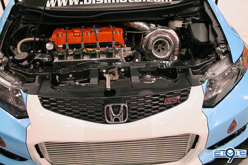

bisimoto hit over 1000hp on his, so I'd say it works fine.
dyno and full build thread here -
http://9thcivic.com/forum/threads/the-bisimoto-engineering-2012-honda-civic-sema-build-revealed….2919/
