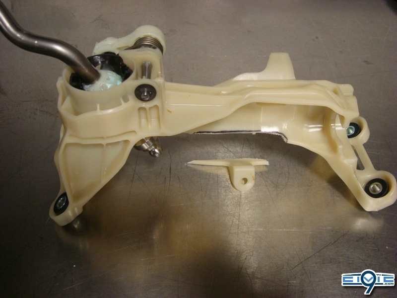

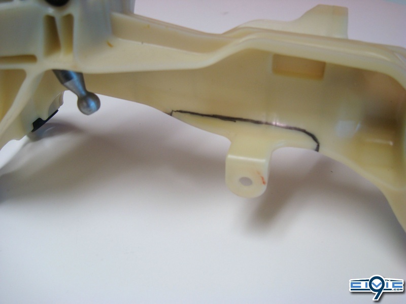

The cutting was hard at the beginning, because I did not wanted to take the whole thing out. However you can take the right side panel off, and use a Dremmel for cutting. Webby, can you pm me an email address where I can send you a couple of pictures where you need to cut, I tried uploading them, but the pics where too large.
reason you need to trim the shifter assembly because the short shifter shifts the cable down a bit and when you shift the assembly gets in the way.. the part that needs to be cut is just where part of the wiring loom connects.. its just there to keep things clean looking..

Here's a picture of what needs to be trimmed, however you do not need to take the whole shifter unit out. You can simply take the side panel from the Shifter Center Console off, and you can use the Dremmel for cutting.

Again, you don't need this piece at all, and what Joon Joon had previously stated, " Reason you need to trim the shifter assembly because the short shifter shifts the cable down a bit and when you shift the assembly gets in the way, the part that needs to be cut is just where part of the wiring loom connects. its just there to keep things clean looking."
