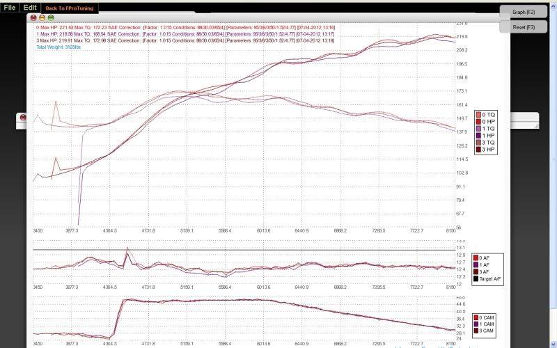

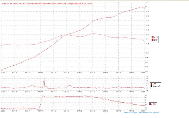

I'll use a member's dyno graph:
The car is using a Flashpro, Takeda 3" intake, ZDX TB (with adapter), RBC intake manifold, 3" dp, and 3" exhaust. And the car isn't fully tuned.
Latest eDyno. More torque, less peak HP. I have a new calibration to datalog, so if there's an update, I'll post it.
you can't post a dyno graph of an engine that has a slew of things done to it and saw look...it works...without having any basis for comparison...for all you know that same setup could make 230 whp with the OEM throttle body
testing is really easy...dyno the car without the part on it...install said part...re-dyno the car and see the results...i am very well versed in how dyno comparions are done and that peak doesn't always mean everything...but again..no solid, conclusive information at all that this part does anything that the company selling it says it does.
that graph you posted does absolutely nothing to back up the claim that this (1) part makes between 1-10 horsepower

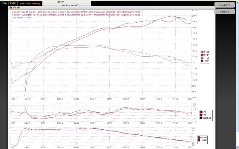

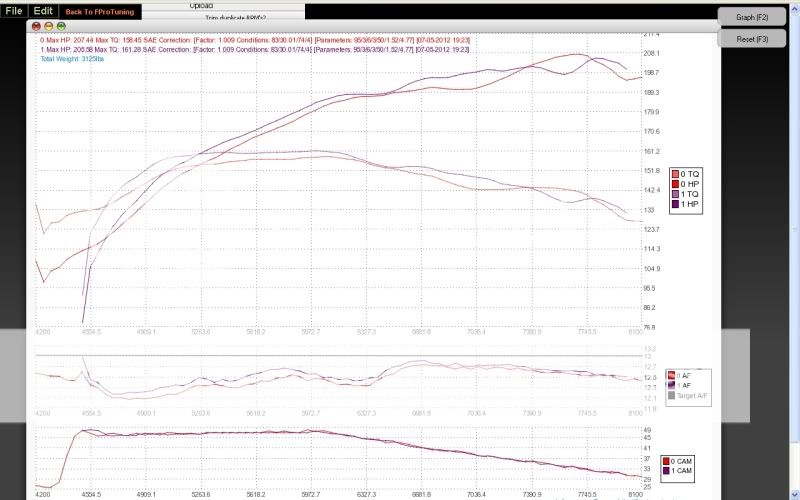

Comparing two different throttle bodies:
On a K20Z3 engine. J35 vs J37 (ZDX) tb (Using the same supporting mods and same J35 tune).
http://www.k20a.org/forum/showthread.php?t=105390
J35 Throttle body with 3.5" Intake:
J37 Throttle body with 3.5" Intake w/ same tune:
J37 TB w/ 4" intake same tune:
Thanks Dar Dar -- that is the actual first bit of real information that has been posted in this thread...
Granted it still doesn't back up the claims that Pro Civic has on their 80mm versus stock on a K24z7 engine but that is the information that a customer wants to see but at least you are finally understanding what I am getting at. Concrete Information !!!! Not some random text that sounds good to try and sell the customer a part that he may not actually even need.
