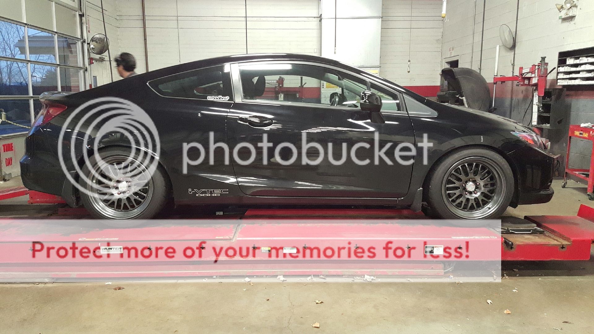

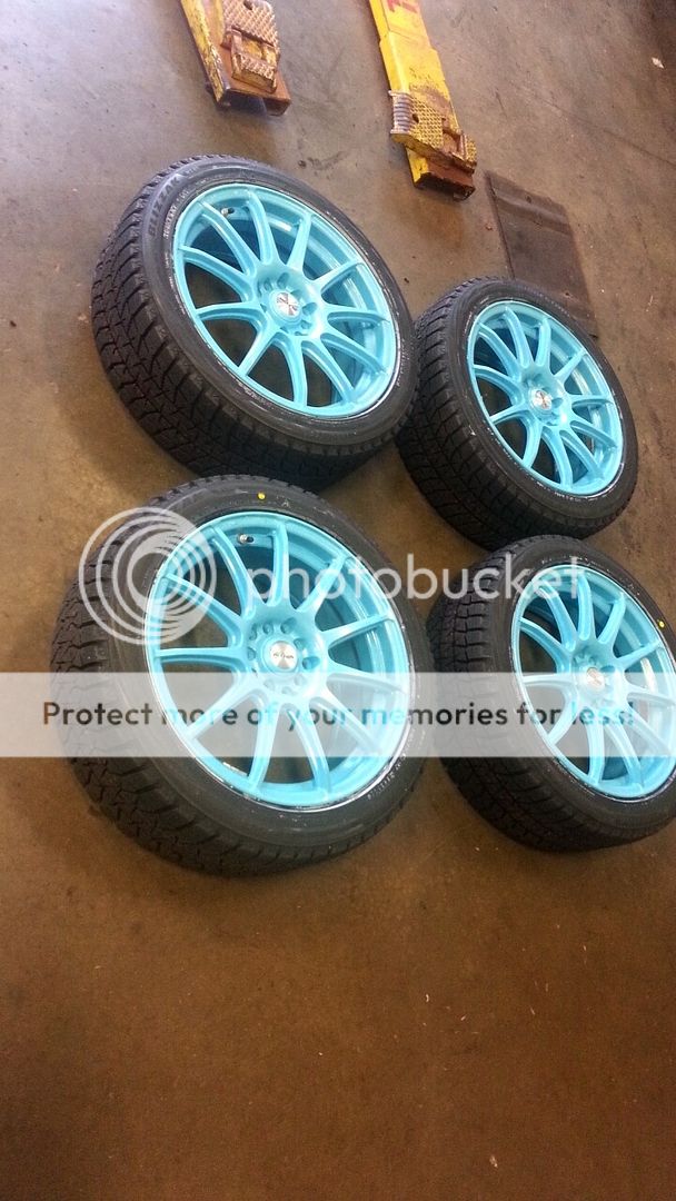

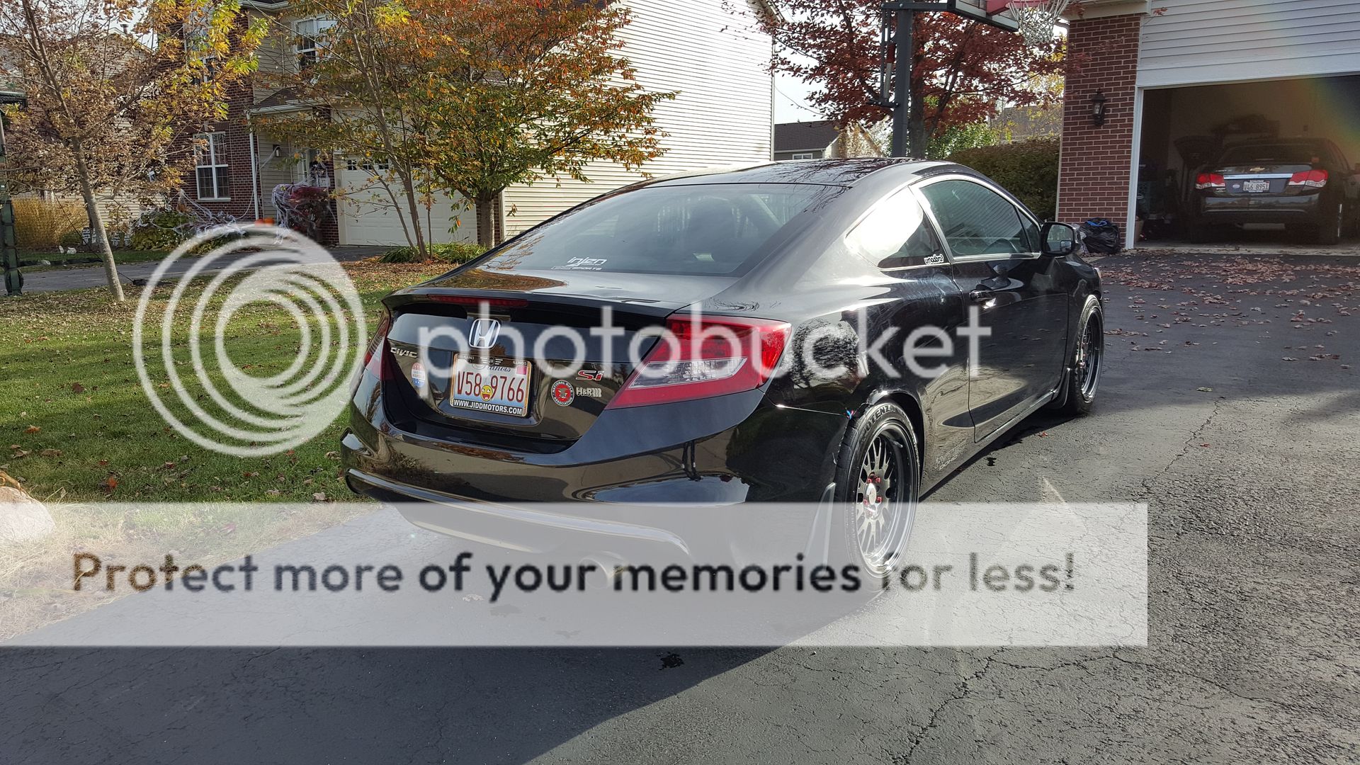

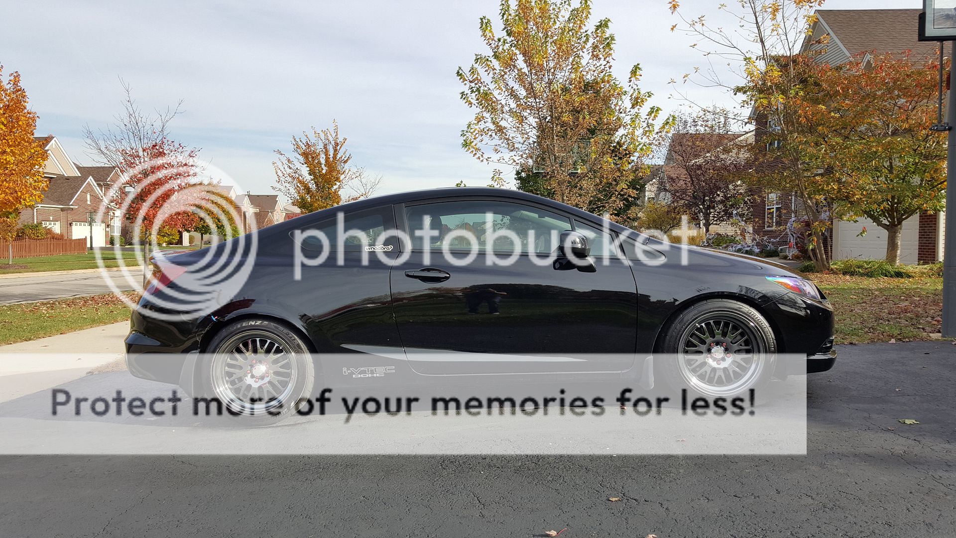

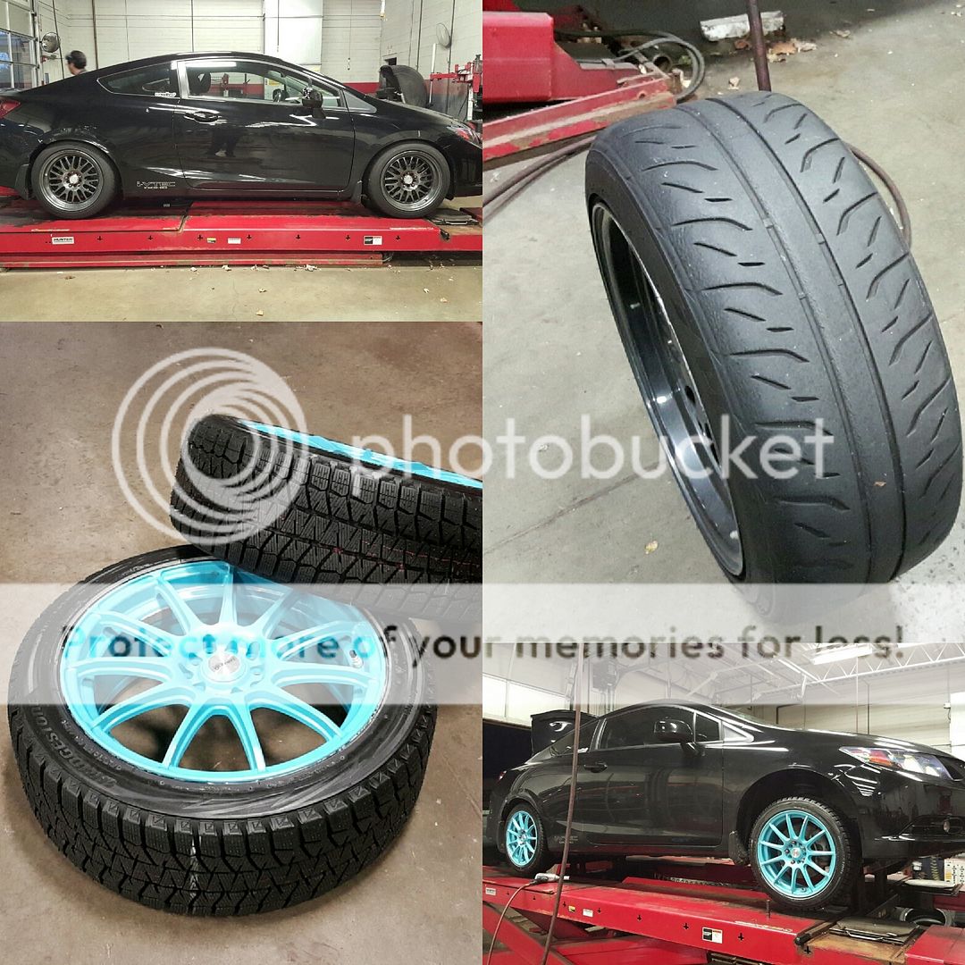

Got me a set of Maxxim Winner 17x7 +40 rims, i wanted tiffany blue... i guessi needed a little bit more green, oh well (exotic sea blue from home depot lol) and also got Bridgestone Blizzak WS80 215/45/17

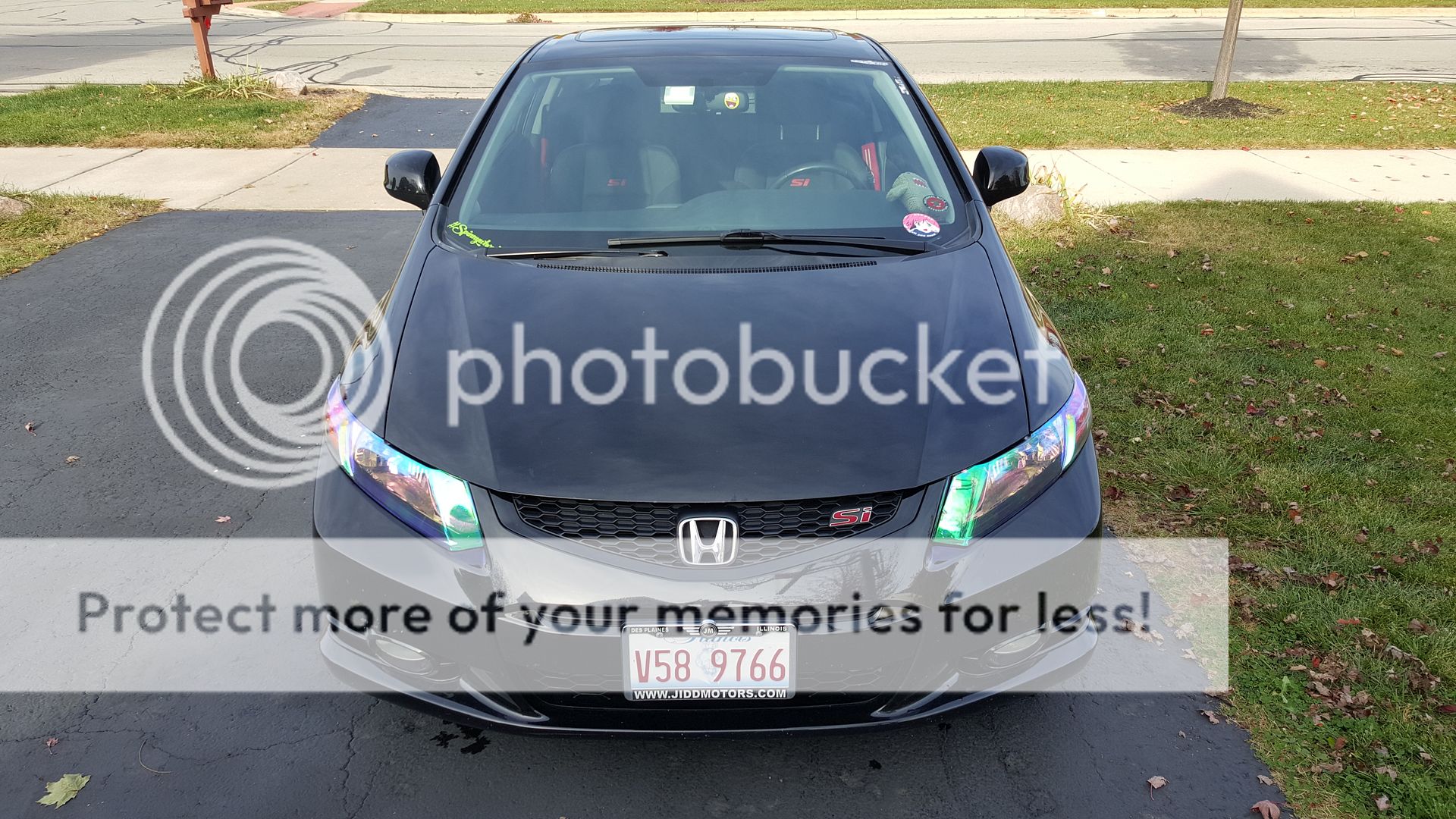

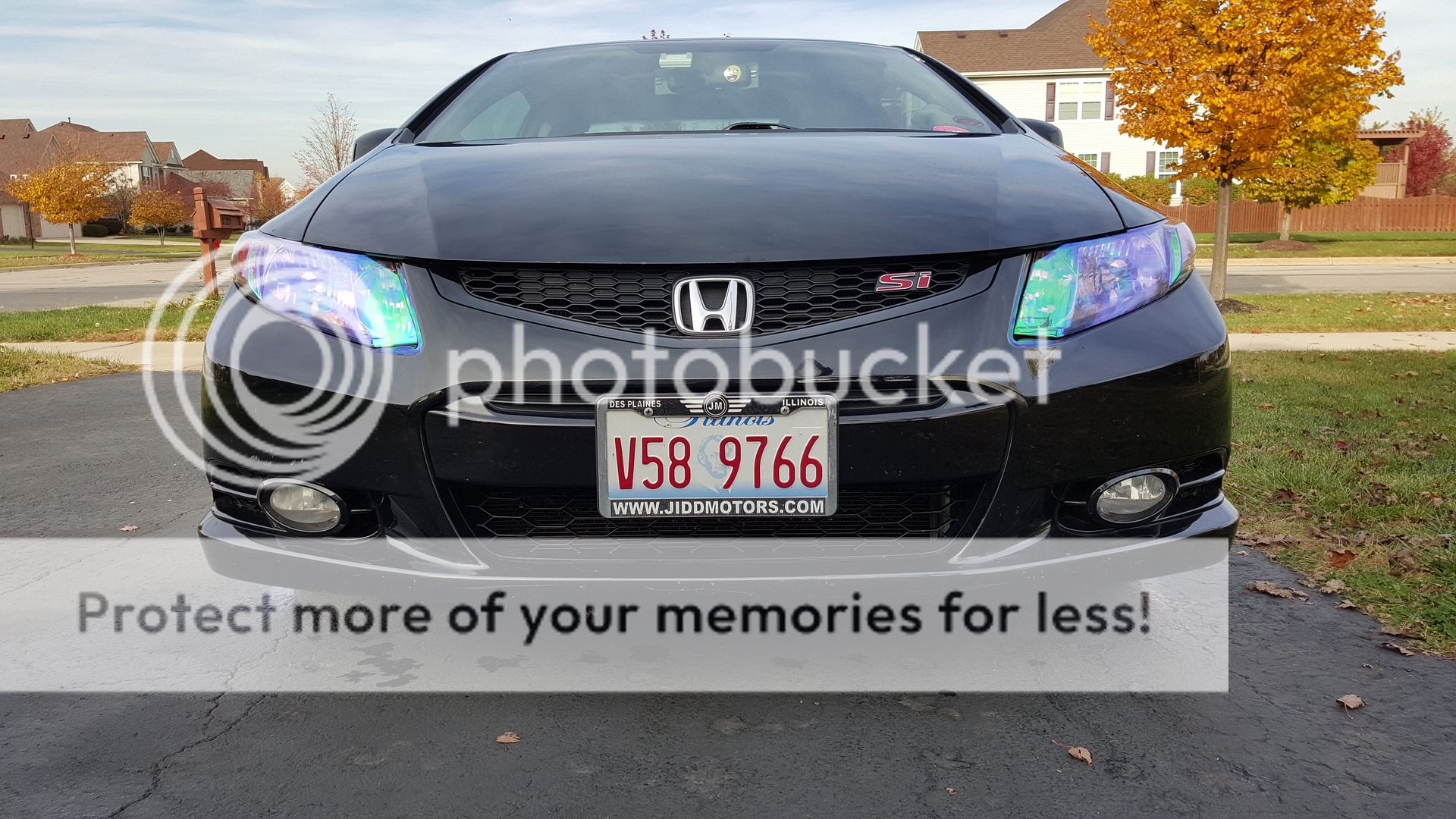

I also went to Frankies Window Tinting in lombard il, got light chameleon for headlights, 40% all around, and light smoke on tails.

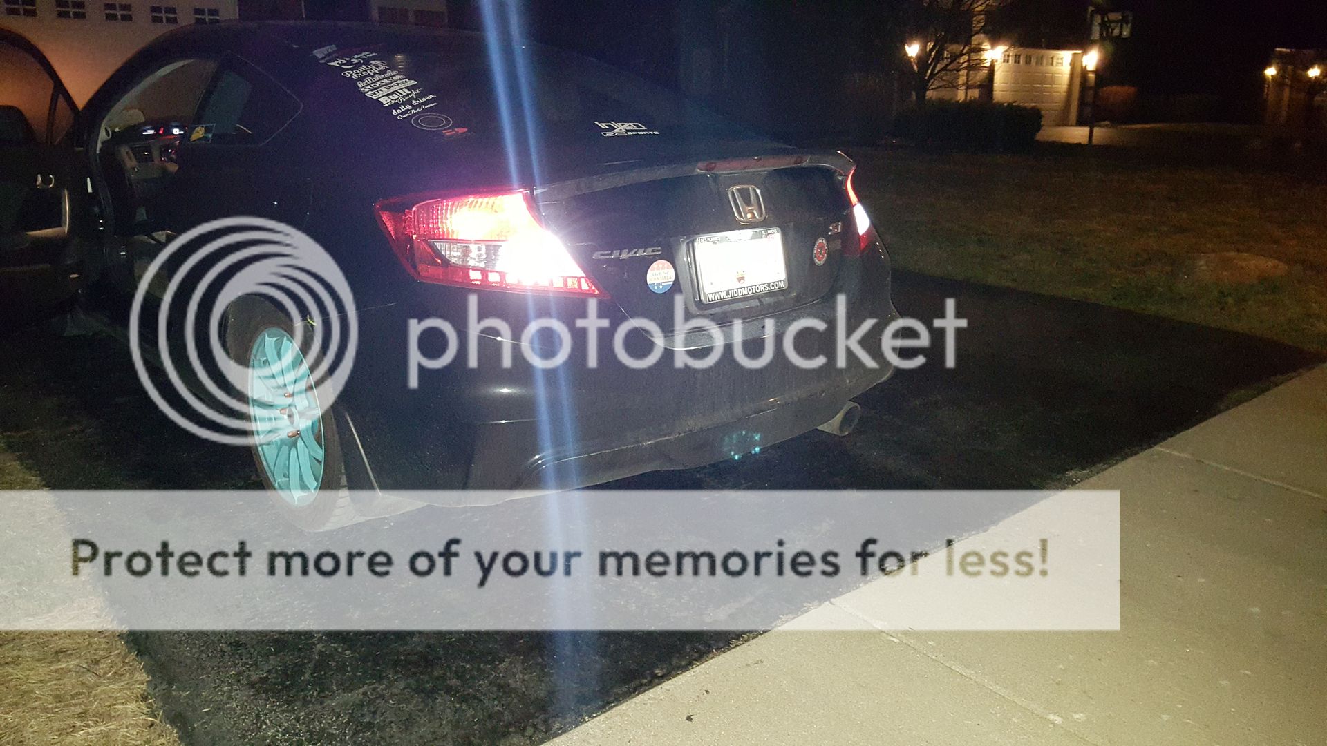

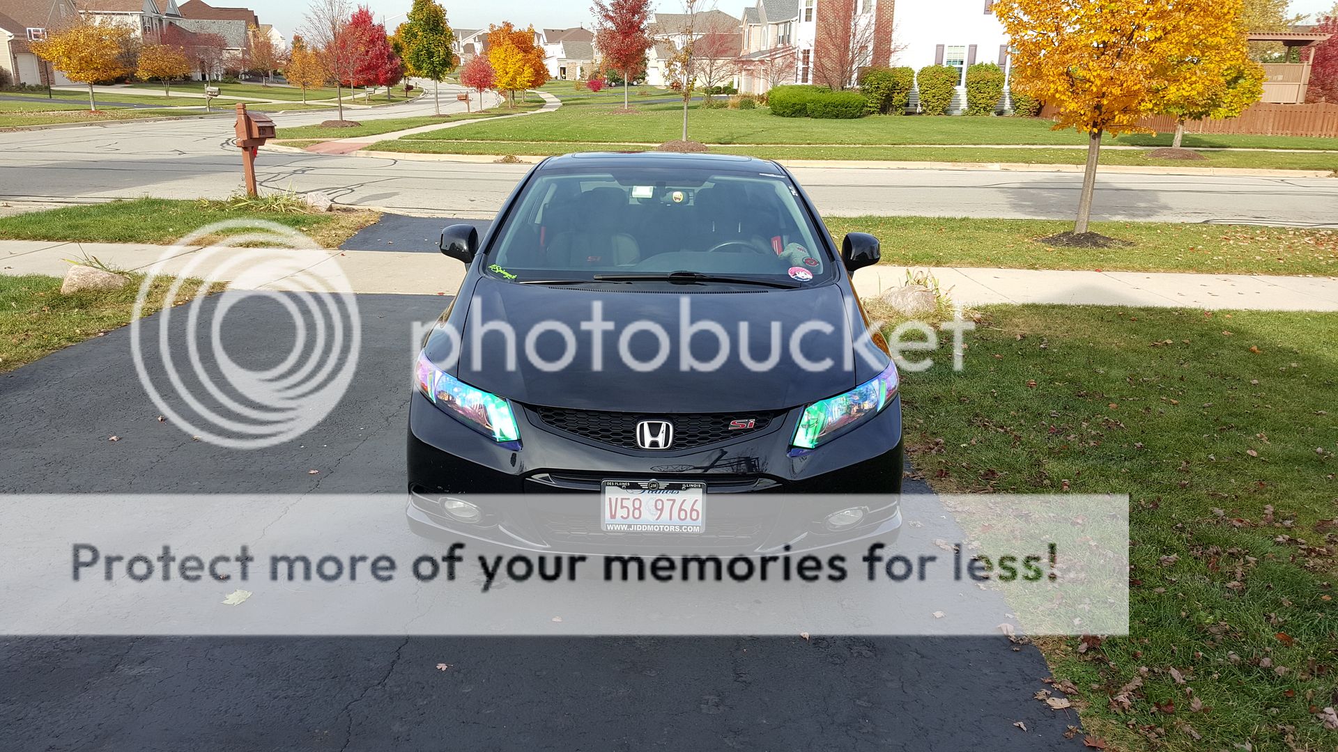

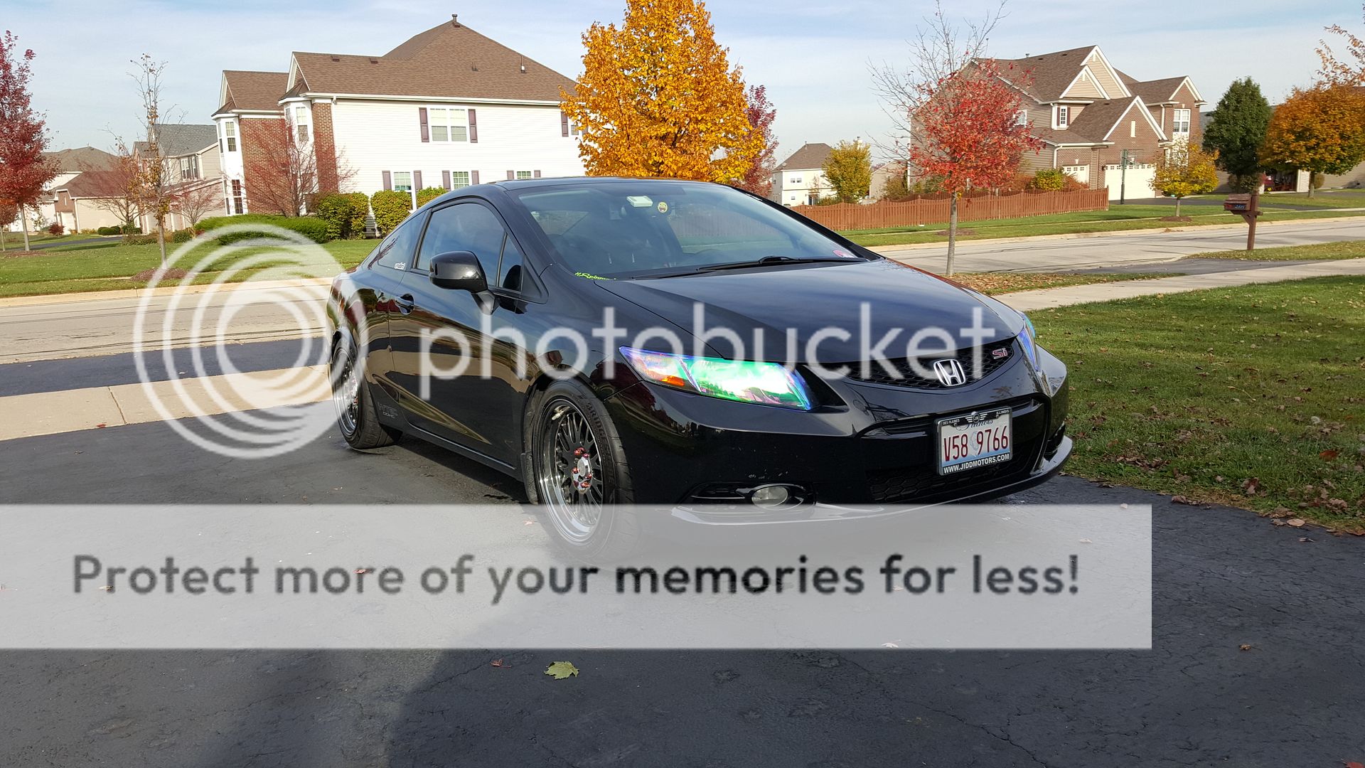

nice winter set. How do those lights look at night. Does it shine various colors on things?

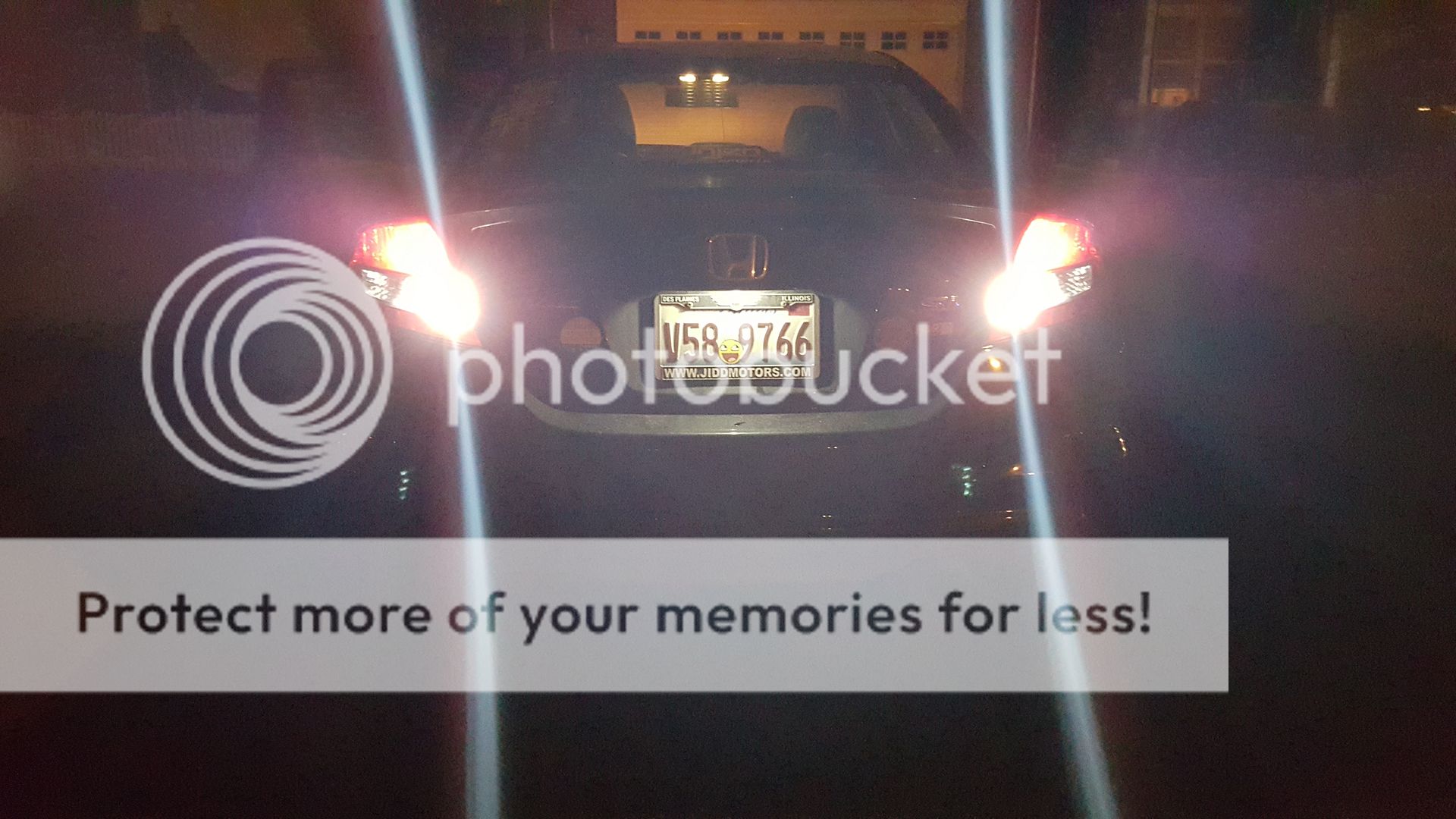

Thanks you, and it doesn't affect light output at all, i got 35w 6000k hids, they still come out very light blue, ill do a video eventually, it's hard to explain in words lol

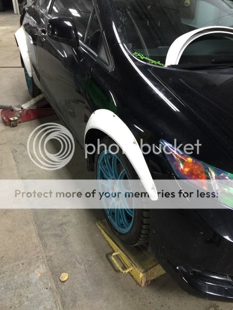

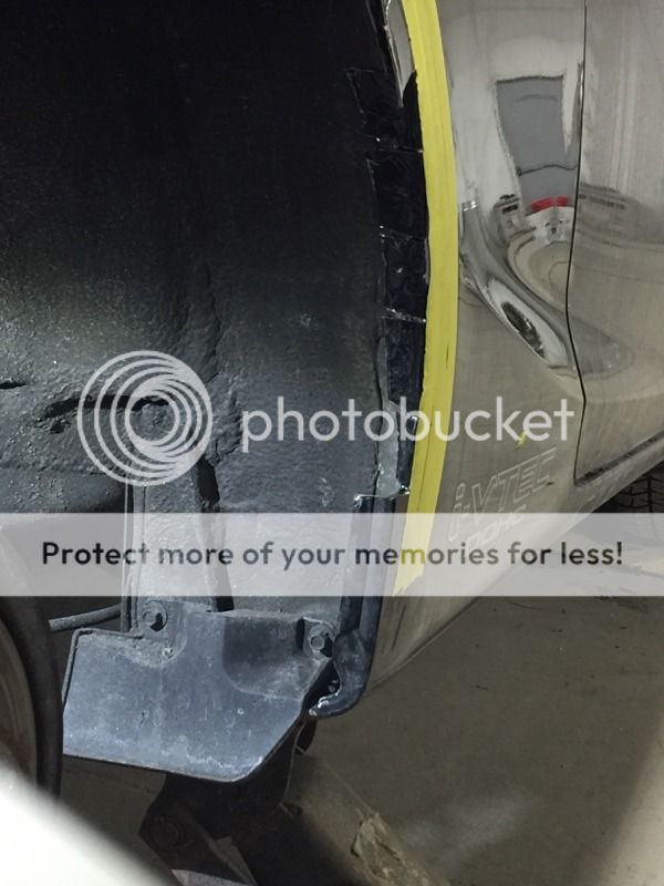

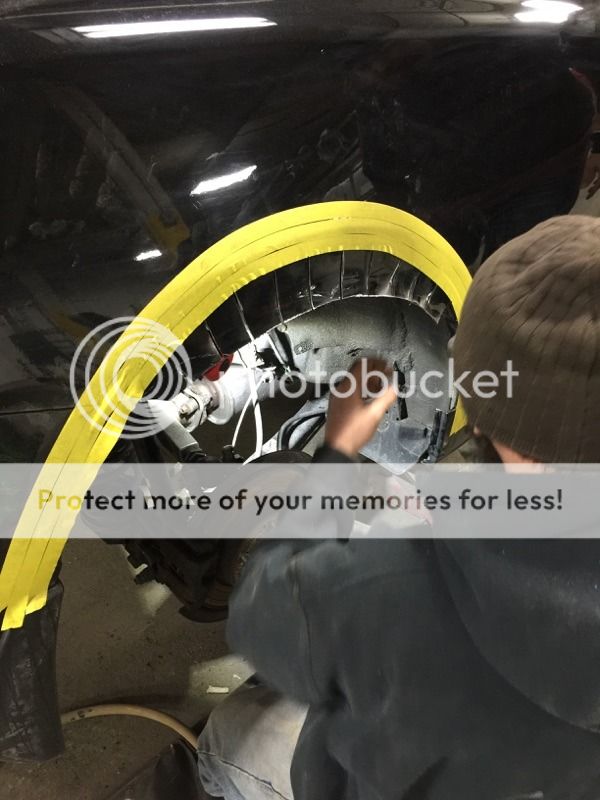

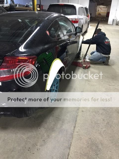

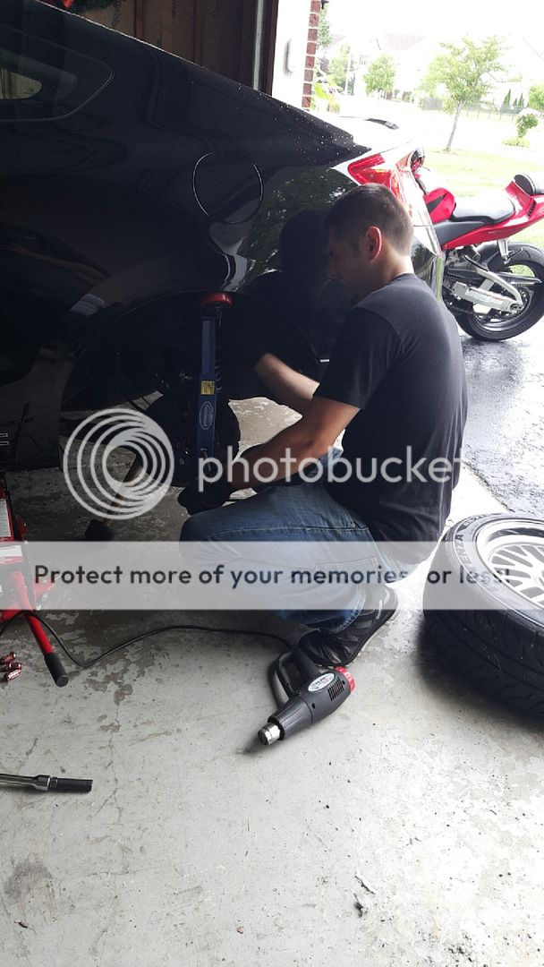

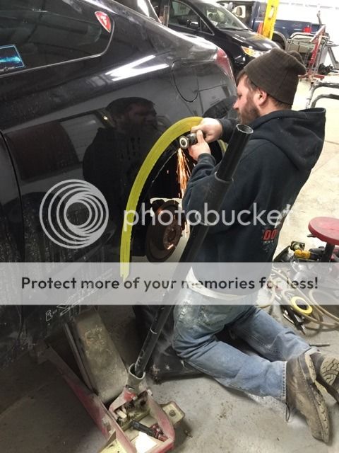

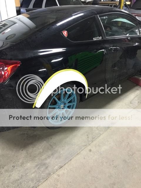

They were nice and smoothly rolled, and my 235/45/17 17x9 +35 kept rubbing, so i told the guy to hella roll and pull them... he told me "are you sure?" I told him yeah, after he did that i was still rubbing on this>
So i cut that bish so good, she wish i hadn't cut her so bad knowuyimsayin' ?

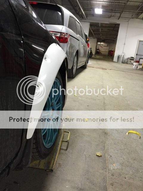

Zipties are to replace that bolt holding the bumper.
Eventually i plan on getting ribbet on fender flares .

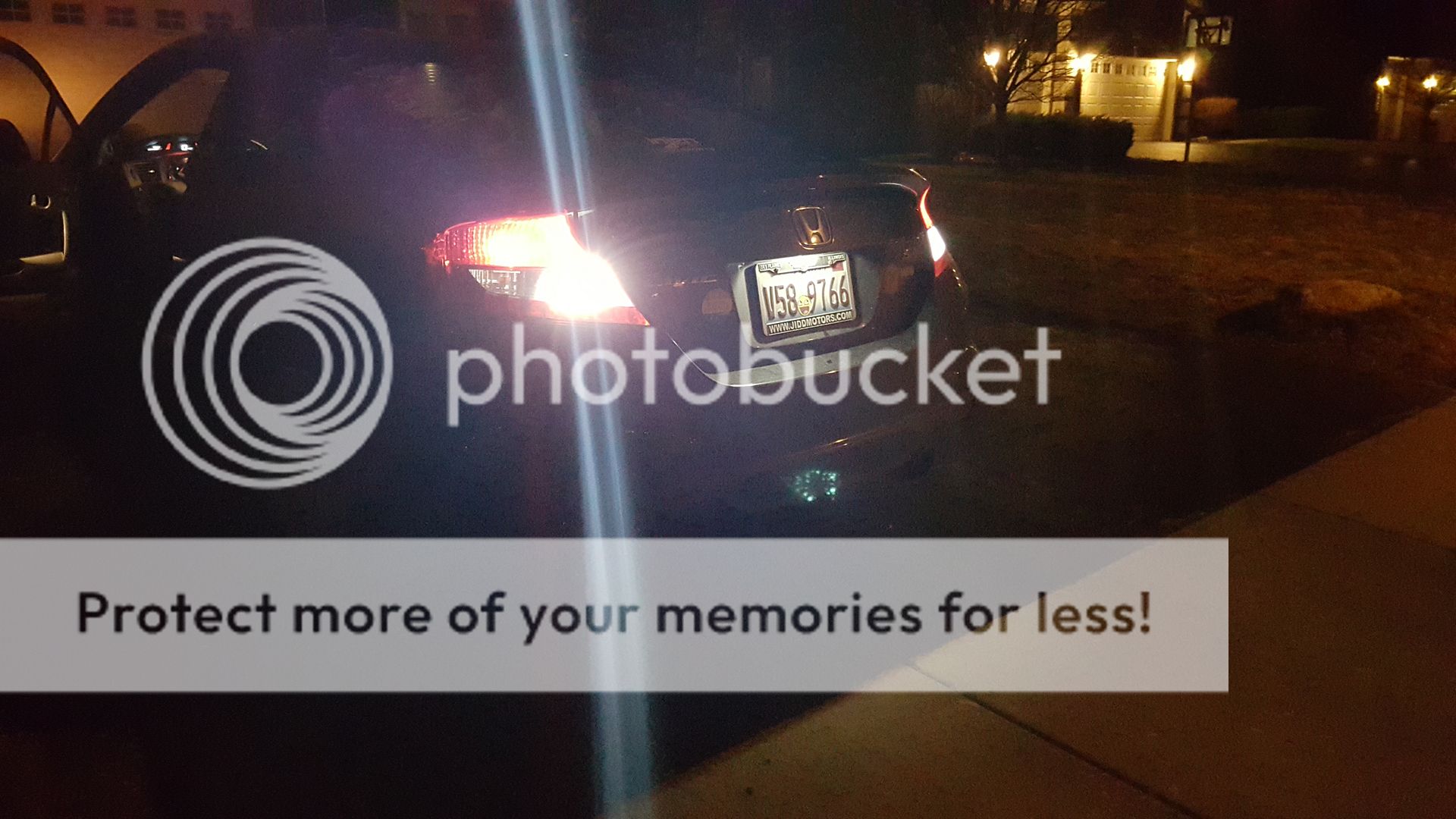

I havent done much lately. On December 2015 i put on white Samsung leds from ebay on my license plate and reverse bulbs.

Yikes. I'm confused. Aren't the wheels are only 17 x 7? Why not reduce the drop so you wouldn't need to cut the car?
What happened here?....

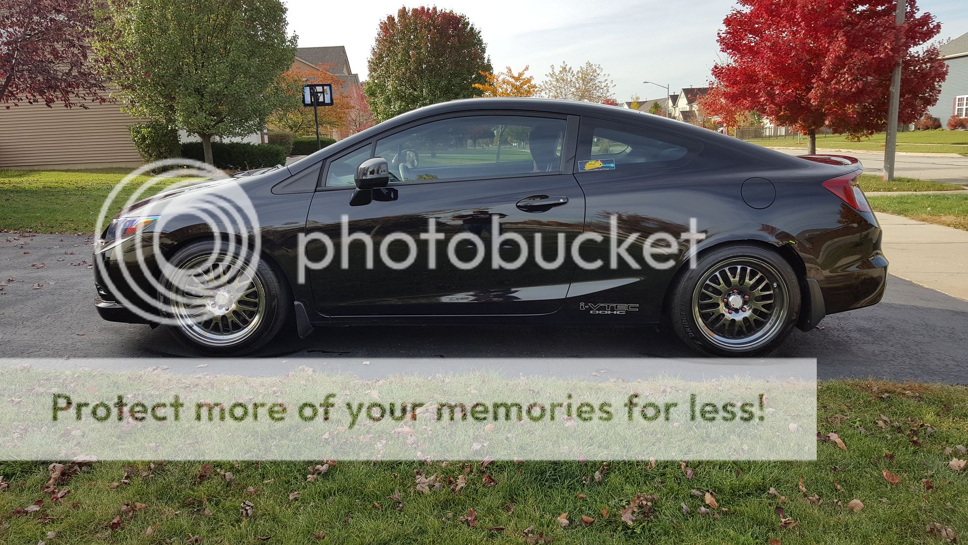

My summer settup is 17x9 +35 so i was rubbing a lot during AutoX, eventually im gonna get fender flares.
I use my car for autox and track, now i need to buy a daily. My summer settup is 235/45/17 17x9 +35. I may get 255/40/17 17x9.5 +15. I need to test fit

I would hope they cleaned the salt off your fenders before they installed those. It does not look like it from the pictures. They also need to get in there and seal all those cuts they made or you are going to have rust eat its way up both fenders and quarter panels.
This image is particularly disturbing as there is visible salt and bare metal on all those tabs and relief cuts.
