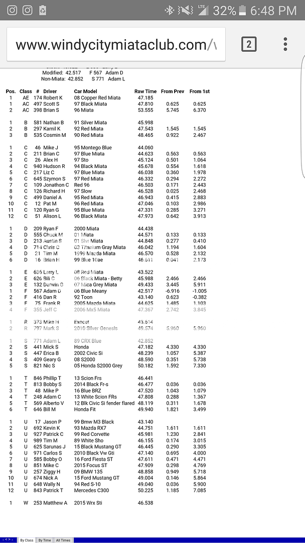

At tire rack i ended 5 out of 6 (in my class) got beat by FRS and BRZs... but they run their car alone, my gf comes with me and rides with me every single event lol.
I should've ran class S instead of T...would have been faster than s2000 and that EP3, but i like to run class T (2.5L and under)

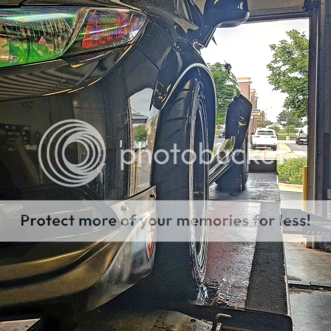

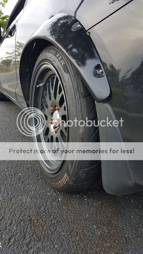

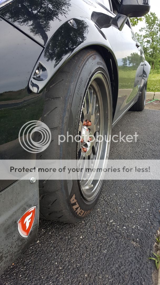

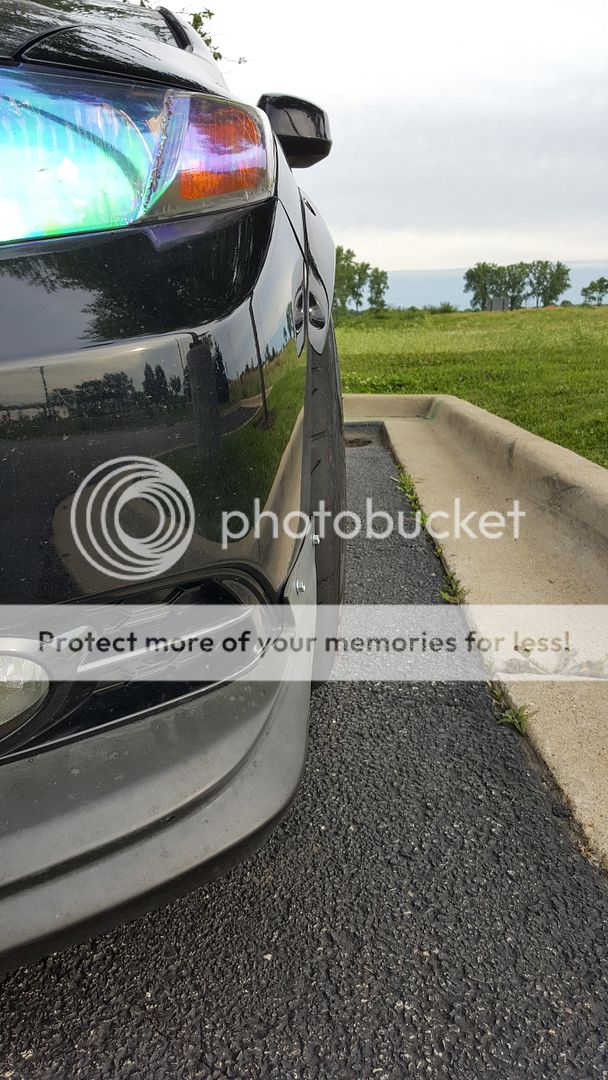

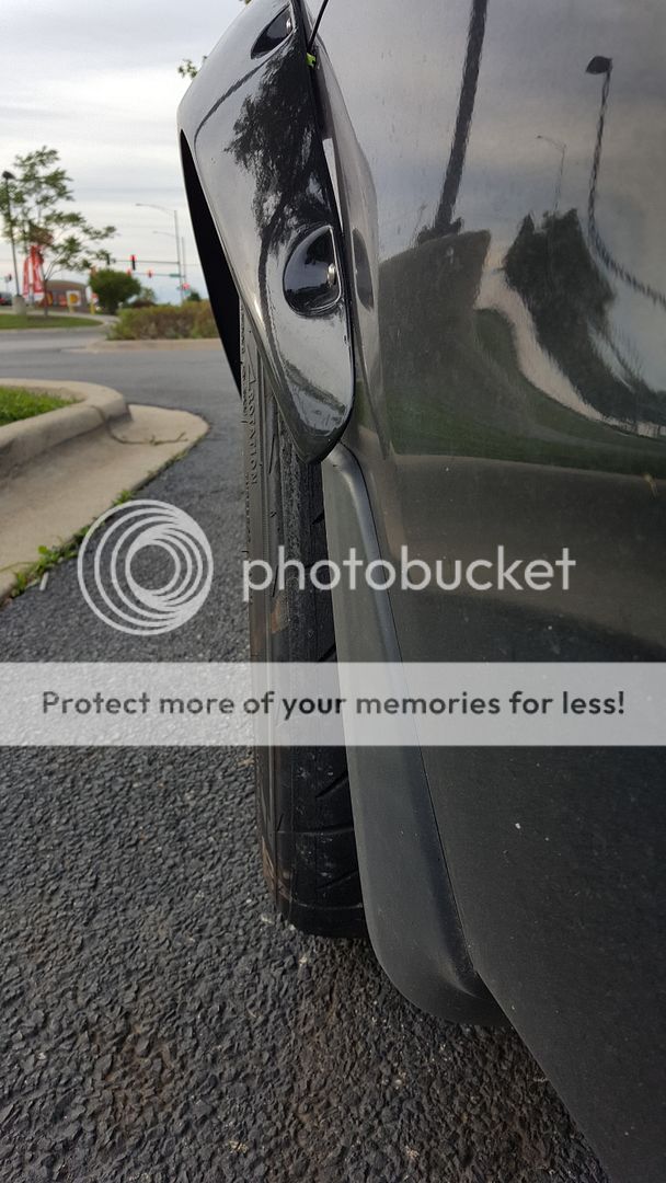

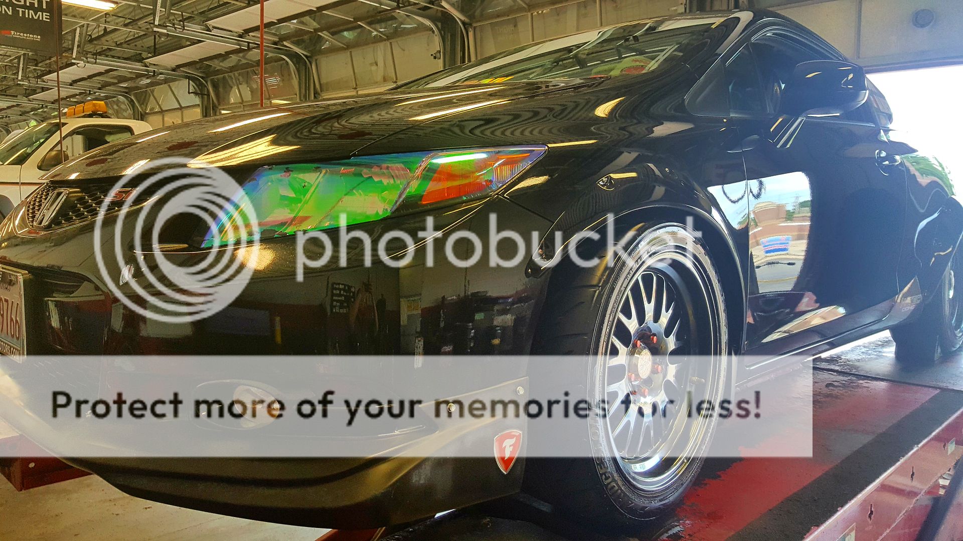

And in case you're wondering what my stance with fender flares is right now here is a close up.
17x9 +35 (+25mm spacer, so +10) on 235/45/R17
Front flare (3.25in)
Rear flare (3.75in)
