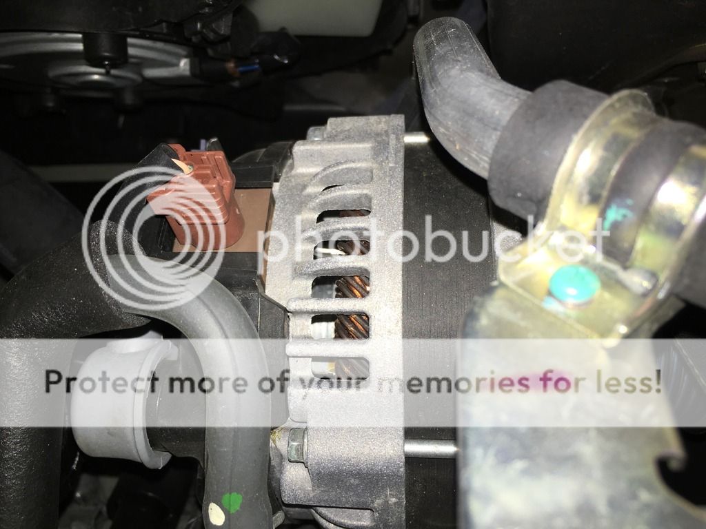

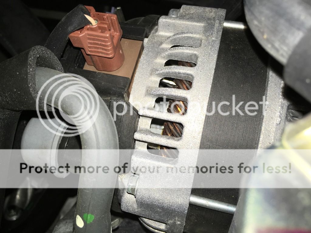

Yeah im going to try autozone tomorrow, and its the stock unit on my 15 Si, im not sure about the lights dimming with loud bass I will have to check on that tomorrow, ok It looks black so I thought it was burnt or something and yeah I dont know its stupid weird how its only happening in reverse, oh another thing I had these LED projector reverse bulbs, I swapped them back to stock today after all this happened maybe thinking its the led bulbs making that happen since its everytime in reverse? So Ill see how the stock ones do tomorrow
I wouldn't think it's the alternator with just 600w... Maybe something with those reverse lights... U have to remove the alternator to get it tested. I would take the reverse lights out and try that first. I have been running 500w + for nearly 16 months and have not had any issues
