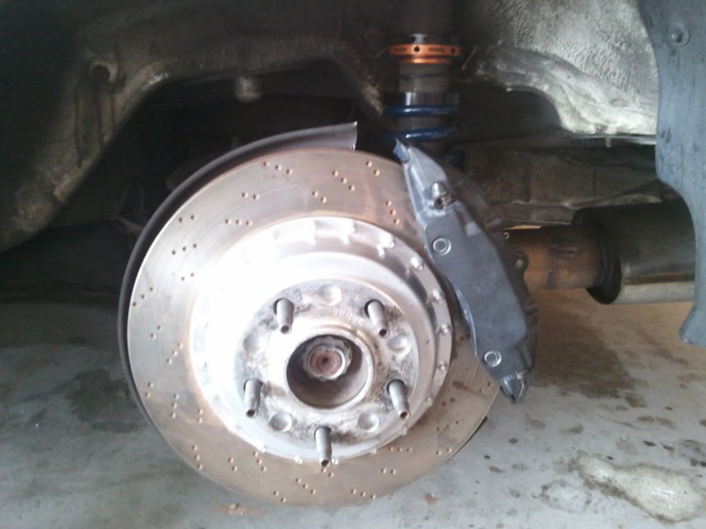

Got the rear calipers on. Still waiting for the front brackets. Hopefully they arrive today or tomorrow as I'm scheduled to be at Road Atlanta this weekend. Cutting it close :facepalm:

The caliper is fine - the rotor is loose ( no set screw), so when the wheel isn't on it just sits on the studs at whatever angle gravity decides.
The finish of the calipers are temporary.. Whenever I have time/funds they'll be refinished properly.

The rear caliper looks like you used a black magic marker on it. LOL
I'm going to see how they look once heat cycled.. then probably refinish early next year. I have the paint and clearcoat for them, just stripping w/o media blasting has been rather problematic.

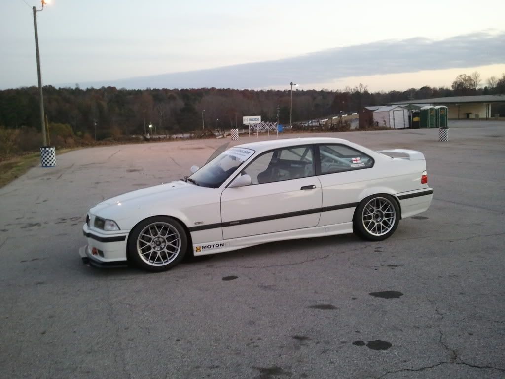

Road Atlanta:
I ran a 1:38.5 in the second session on Saturday w/ a 160lb passenger.

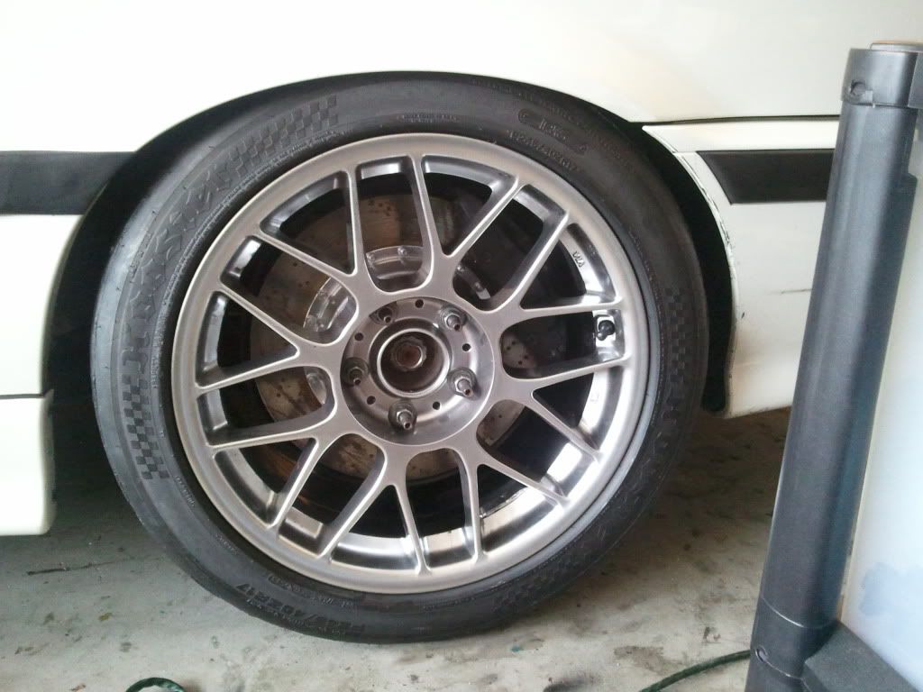

3rd session, I made the decision to put the BBS RK's on because I didn't fancy putting a useless heat cycle on the Hoosiers. Did one slow session running around in the low 1:5x's on RE01R's and came in. THREE of them had cracks on numerous spokes where the spoke meets the barrel. - I bought them used, they were fine, and this was the first time I'd driven the car with them on.

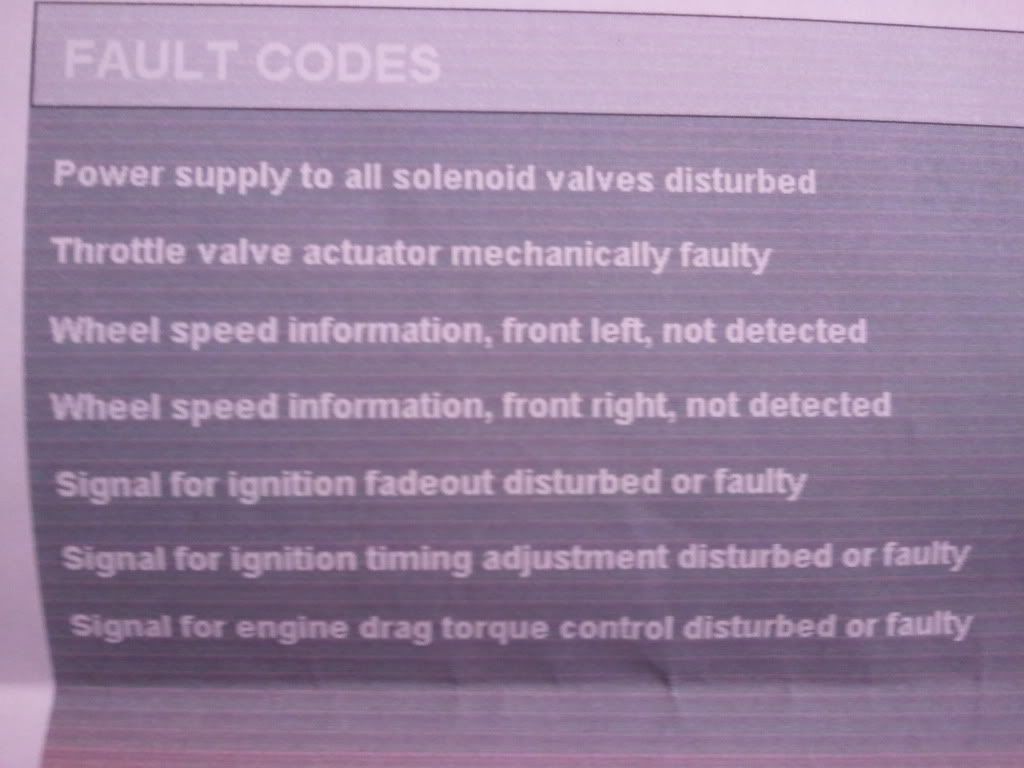

Taking the car to the BMW dealership sometime to hook it up to their main computer system to fully diagnose the issues.

Xray cracked wheels and diagnose. Hopefully fixable.
Diagnose ABS problem. Possible a ribbon connector failed and I'll have to open up the ABS unit and solder some wires.

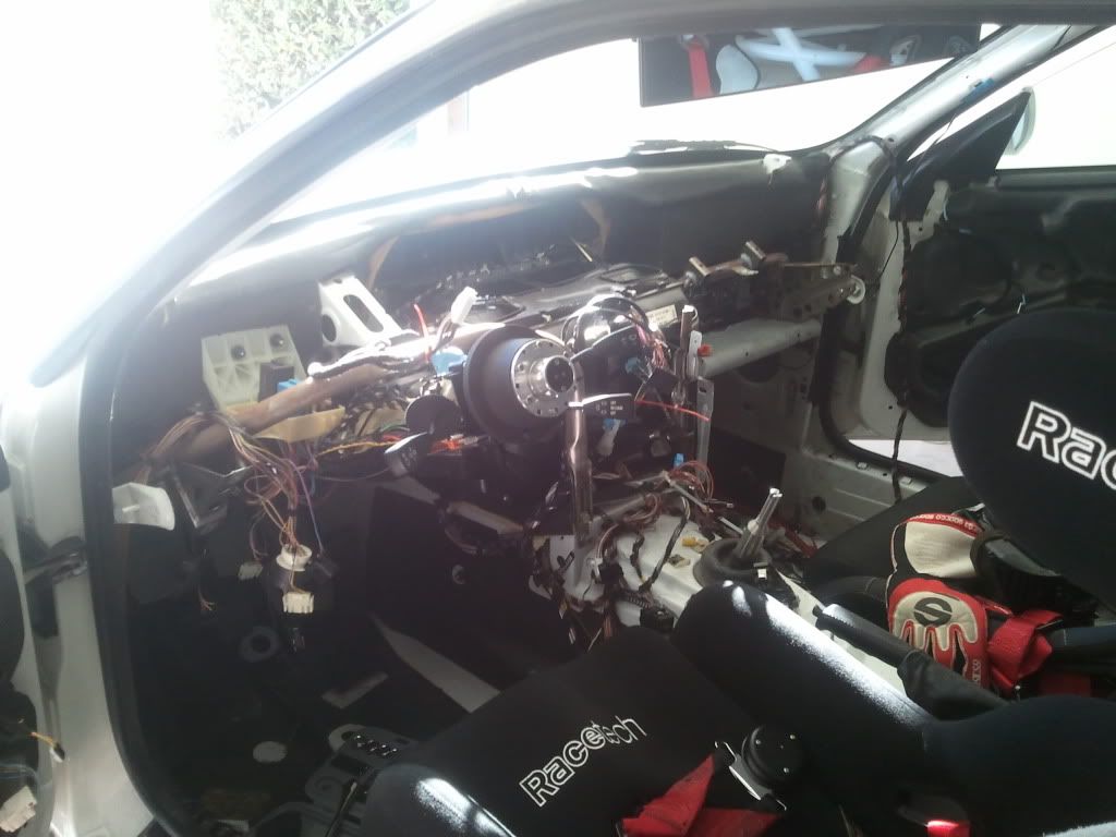

Remove audio harness & tidy up interior wiring.

Straighten SSR's and sell
