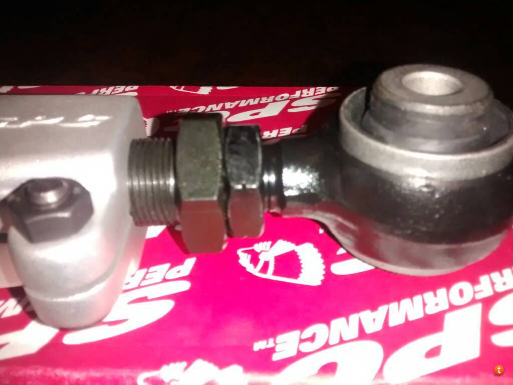

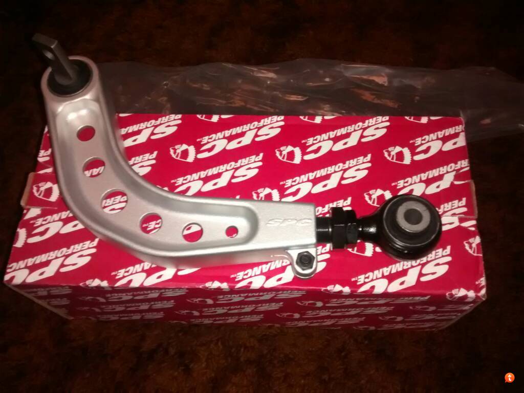

Quoting SPC: "Double sleeve adjuster easy to access and allows for on-car adjustment"
Mine just came in. :woot: if it looks like this, then you can adjust it without disconnecting it from the rear knuckle.
V2 vs V1
I believe they redid the end so you could turn them while they were on the car instead of having to undo everything.
Also, get some really good anti-seize and coat everything that moves. Especially the part where the steel end threads into the aluminum arm. You don't want to get galling and corrosion there. The dis-similar metals will cold weld themselves together.
