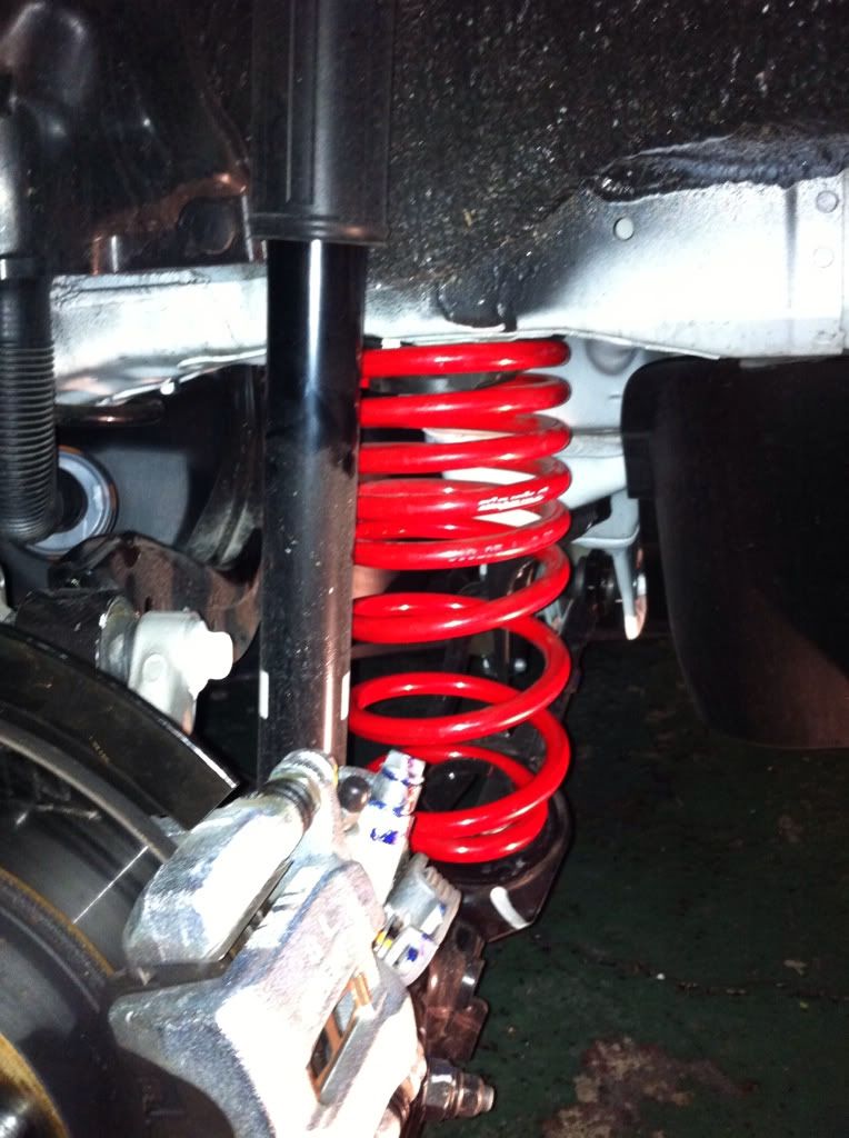

what springs off an 8th gen did you use>?

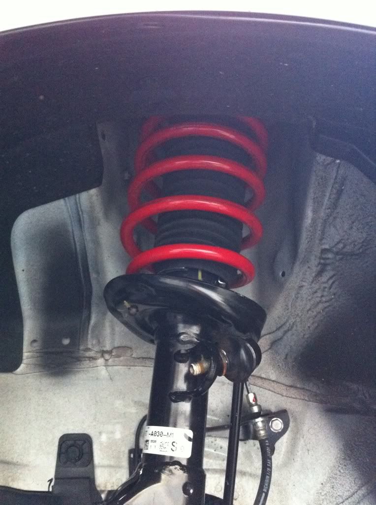

You should use the rear upper spring isolator (rubber) from the 8th Civic on your 9th Civic if you install 8th Civic springs. If you notice in the picture above, the upper spring diameter is too big for the perch, and the 8th Civic isolator fixes that....and is cheap. Find it at our local or online dealer for just a few bucks.

hey papi fly----so the 8th springs fit and work with no problems? even using the 9th gen top rubber piece worked also? so would coilovers (not full coilovers) work on our car?
I personally didn't use rubber pieces at first I only used the 9th one for top and it was only making noises on hard potholes but besides that it was good , you CAN'T use the 9th bottom one , but you CAN use the top 9th if you take the time to sit spring properly on rubber without it rubbing on the chassis
