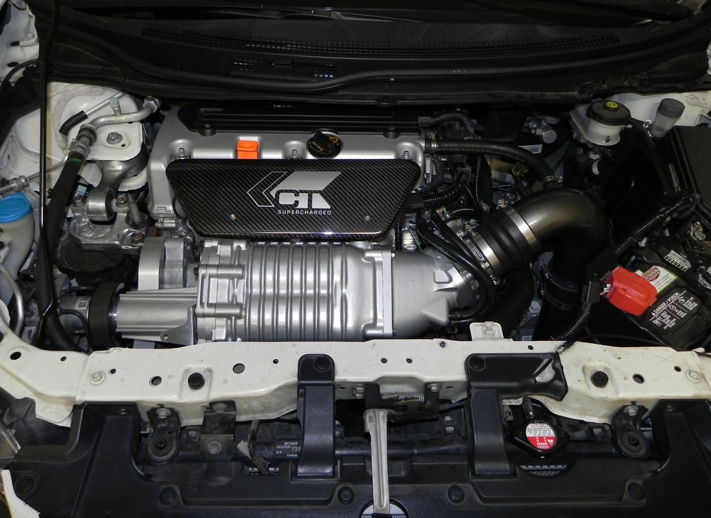

Ct-e supercharger wait
im tempted to peel mine off...verrrryyyyy carefully
i don't think you can. It seems to be clearcoated over the sticker cause you cant feel any edges lol.

@Civi9 looks awesome! You're also running the 3.6" pulley right? Stock clutch?
Yes 3.6" and stock clutch. I doubt I'll need to upgrade the clutch with this setup.
