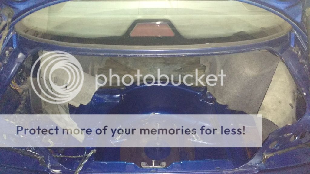

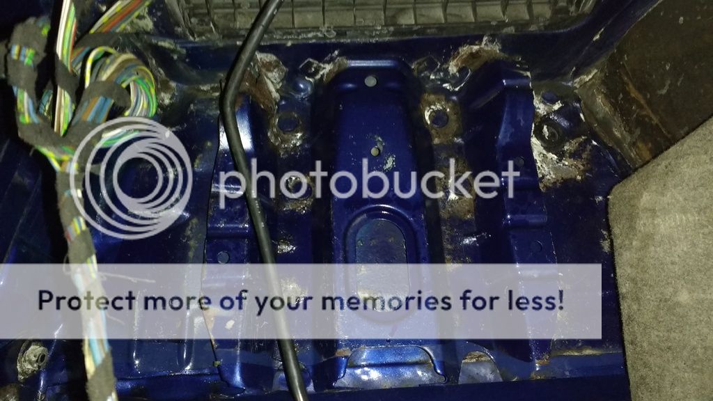

So I inspected the trunk area and there is rust everywhere! I removed the battery, spare tire, all the padding and saw a pretty good amount of corrosion. Luckily, the rust hasn't eaten through. I had to do something about preventing any further spread.
I started with a lot of cleaning and degreasing to see what I'm dealing with.

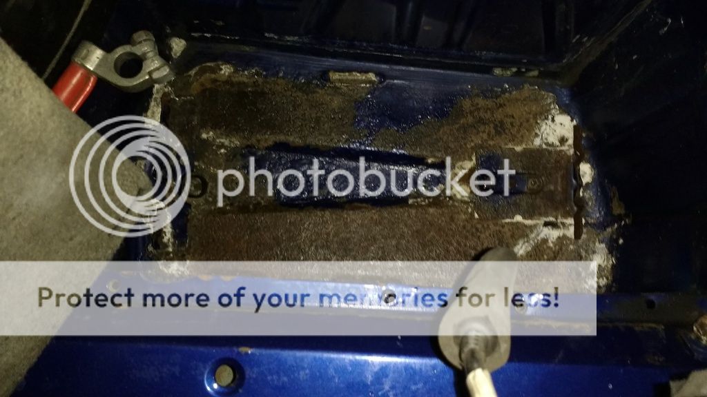

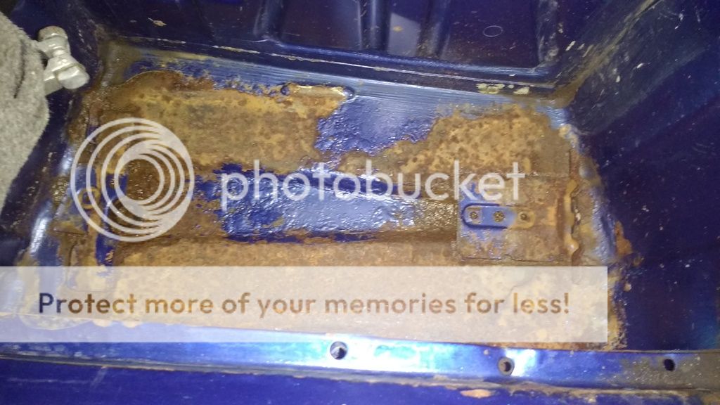

Whoopsie. There's a lot of rust underneath the battery!

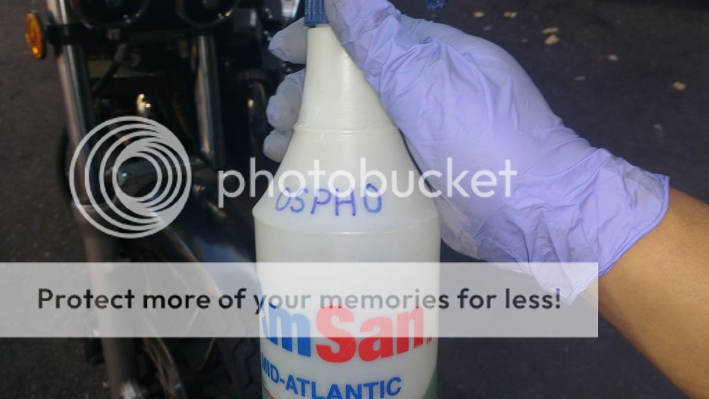

I sprayed the rusty areas with OSPHO, a rust converter than changes the chemical property of corroded metal.
After spraying and a few hours of waiting, the rust changed color.
Here is another spot in the trunk that was sprayed.
I then sanded the treated areas with a steel brush. I vacuumed and cleaned the trunk space to be prepped for applying POR15.
And this is what the trunk looks like after coating the treated rusty surfaces with POR15. I also coated the strut mount areas since I noticed some surface rust.

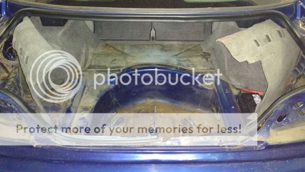

I installed the battery reinforcement plate and riveted it. I also coated it with POR15.
I then sprayed the area with 3M Rubber Underbody Coating.
And the trunk area.
Nice job man. Is the 3m stuff similar to bed liner? Or is it removable and can be peeled off later?
