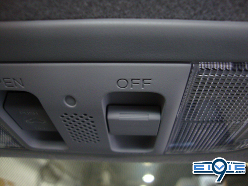

2. Turn the light switch to off, or close yourself in the car and wait for the lights to go off. Its pretty hot around here, so I chose the former, plus no one likes to be blinded while working on a car....

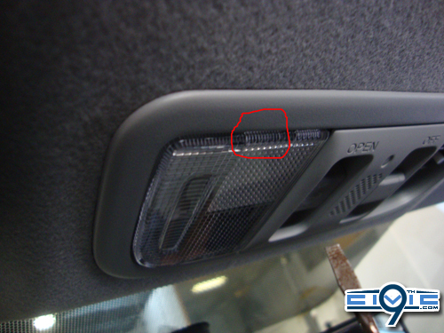

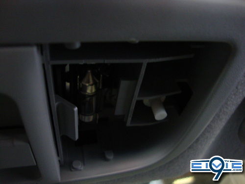

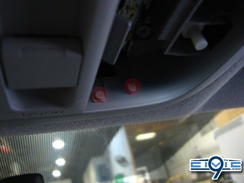

3. Cover the tool and insert it here to wedge the map light covers out safely. Just a little bit of pressure because the tabs holding it in are pretty thin.
After you get one side out, gently pull it the rest of the way out...

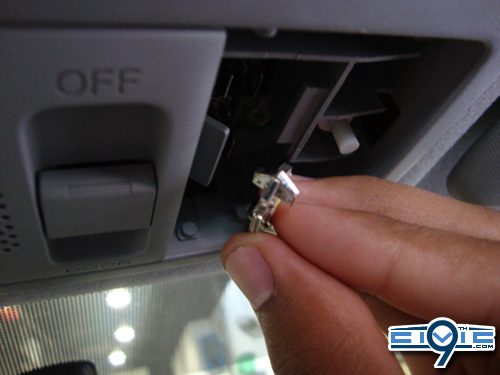

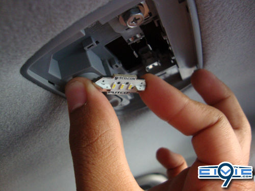

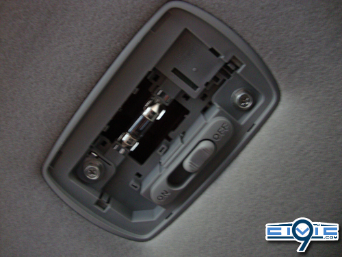

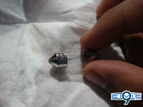

4. Heres the factory light bulb. Remove them. Keep them, throw them away, give them to your mom, donate them to charity.

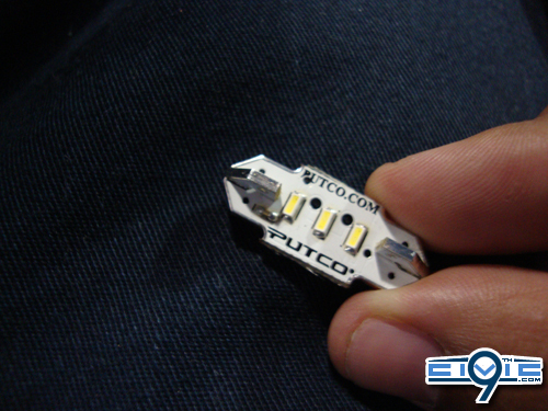

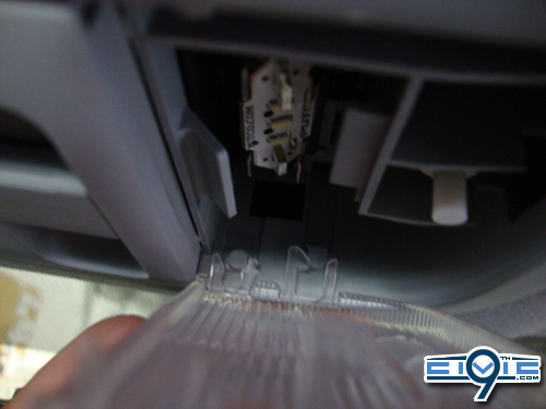

5. Here's your shiny new LEDs. These three yellow rectangles are the lights.
Face these down and wedge the light into the socket.

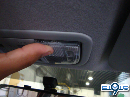

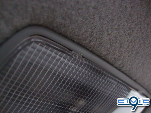

6. Line up the tabs on the light cover with the nubs in the holder on both sides.
Give it a good push and it'll lock into place.
7. Repeat for the other side.

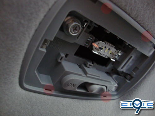

8. For the back dome light. Turn the lights off.

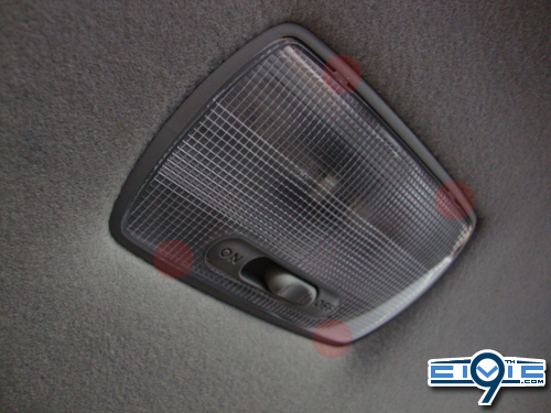

9. Locate the 4 tabs on the lens.
Gently use the tool to pry the lens out by these tabs.
Remove the lens
10. Remove the light bulb. Replace it with the LED

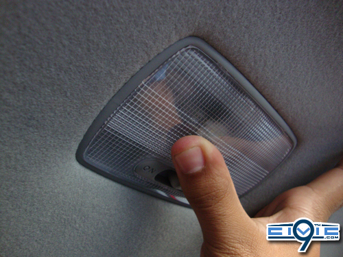

11. Line up the tabs on the lens with the slots in the holder. Press the lens back into place

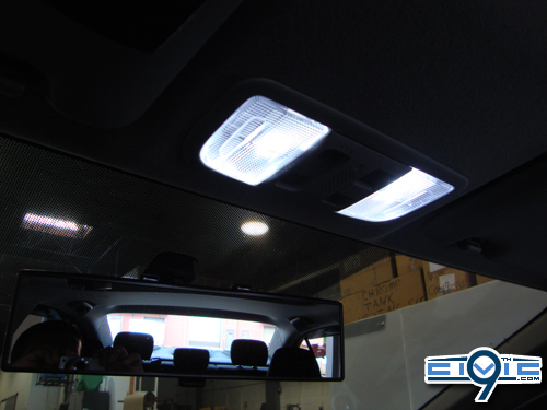

12. TURN THE LIGHTS BACK ON and enjoy!
Awesome write up! I especially like the added humour =)
Any chance you could take some night time shots to see actual light and colour output?
Steve
Not a problem! The white light really looks good with the black interior, and really cool at night
