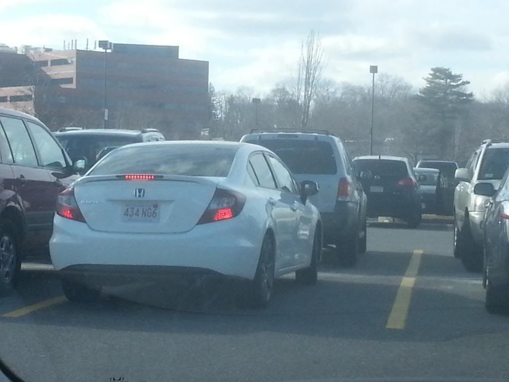

My Si spoiler came in today :woowoo:
did you order the honda harness for the 3rd brakelight?? its not the same as ours... ( i didnt) i went to my local hardware store, bought some wire and spliced into the 3rd brakelight harness from the seat and then got some connecters and put them into the 3rd brake light on the spoiler worked like a charm :)
Yeah I ordered the harness. How's it not the same, different connectors?
yeah that... any luck on the template from the dealer ????
I forgot to ask when picking up my B pipe :pat: I asked CHH about it, but they haven't installed a Si spoiler on a non-Si yet. I'll probably design my own template lol.
what sucks is that you cant get markings if you dont put the clips in .... but if you do put the clips in then you cant position the spoiler correctly...it was a pain in the ***..without a template theres no way of perfectly doing it.. i put a mugen spoiler on my 8th but that was easy.. i just put nailpolish on the holes and pressed down to mark the spots... but on with this spoiler that dont work... i kinda did it by eye.. but i only made 5 holes... its supposed to be like 10

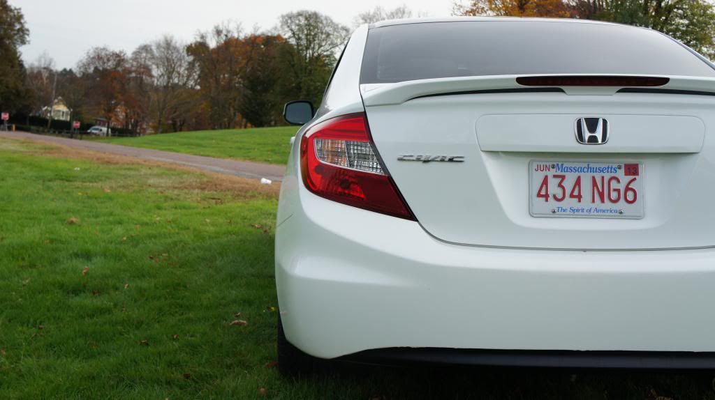

can you notice how this is not perfect perfect... its about 3mm off :)
haha notice this is me outside installing it in an alleyway ( no garage :( womp while my girls play)
hahaha youll be fine then... im more ocd than you.... look at the H emblem and notice its a tinyyyyy bit more to the left then it should be... not perfectly centered
Now I see it. I was looking at the spoiler before, not the emblem lol.
