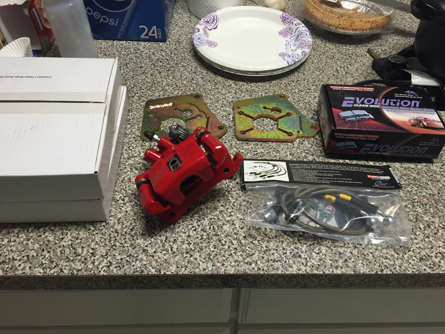

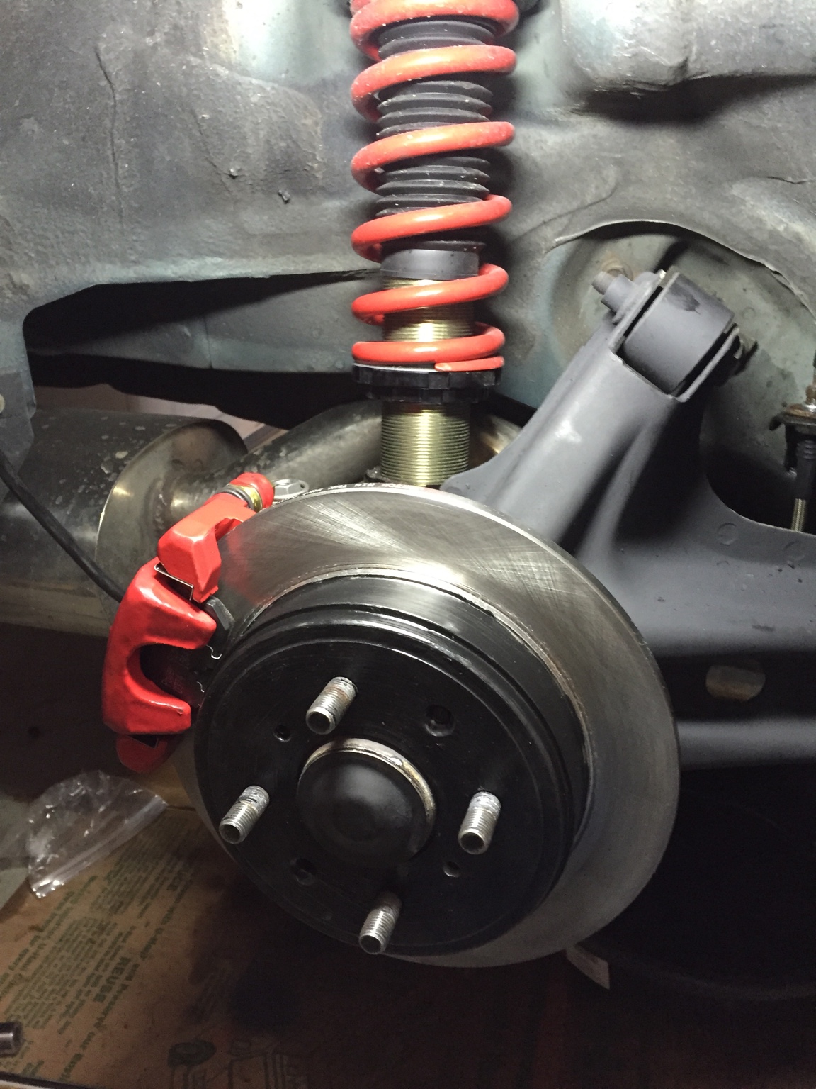

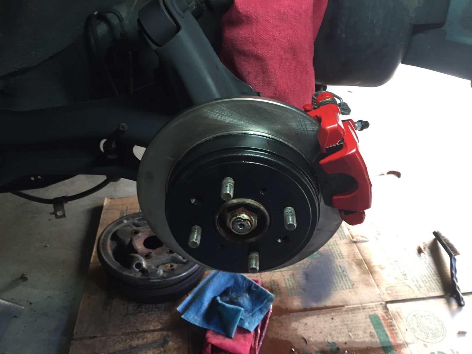

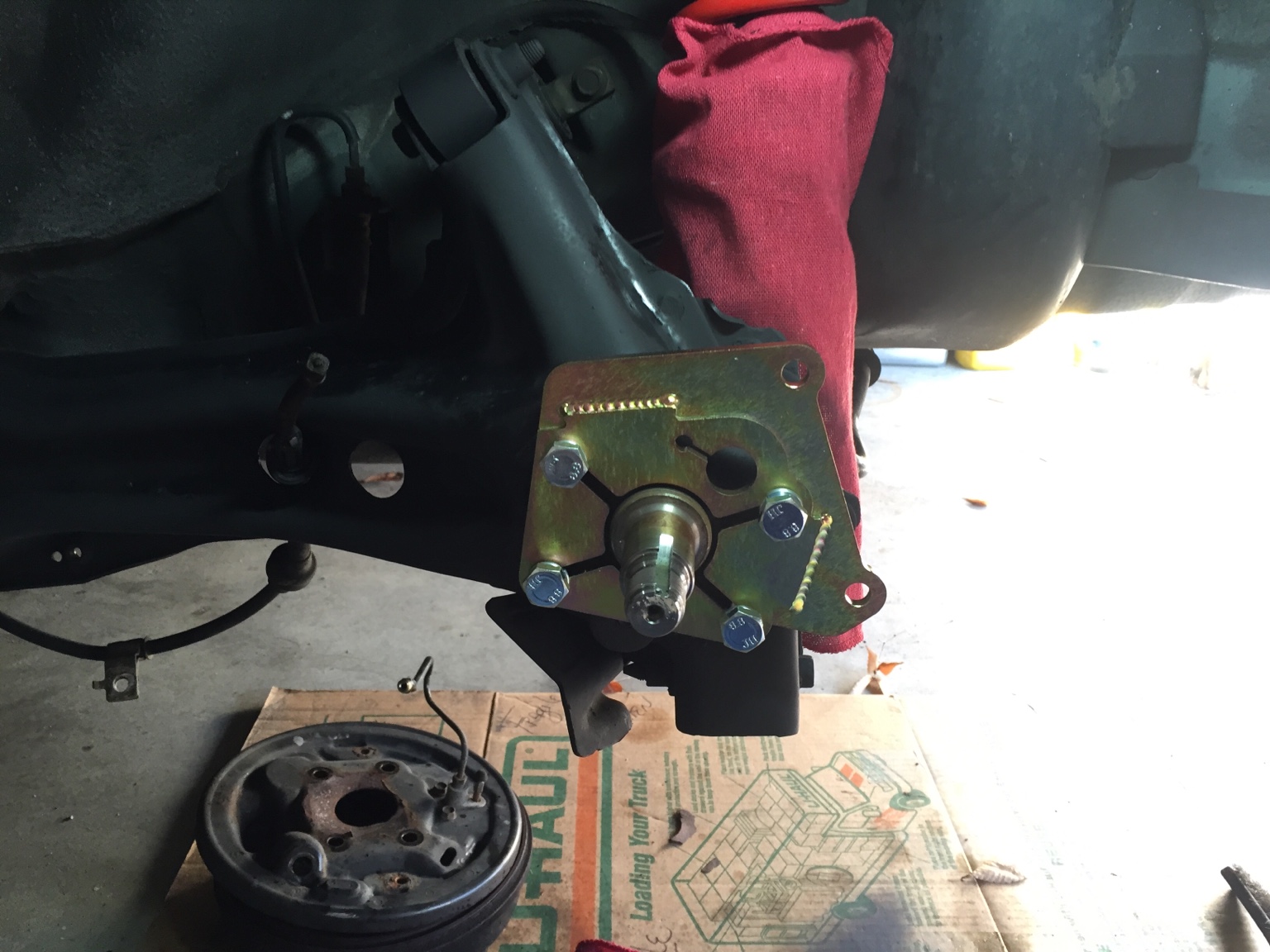

Disk only came on 99-00 si trim. Ex got the crappy drum brakes. It's a relatively straight forward swap though. You can either swap the whole trailing arm or get an adapter.did the ex's have disks or are they off the SI or?
yeah I just realized yours is the EX....for some reason I thought it was an LX in my head
Have the prop valve on the shelf in the garage, just forgot to grab it for the pic.Don't forget to change the prop valve or you will not get the full benefits of the swap besides the added weight.
