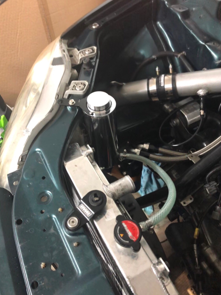

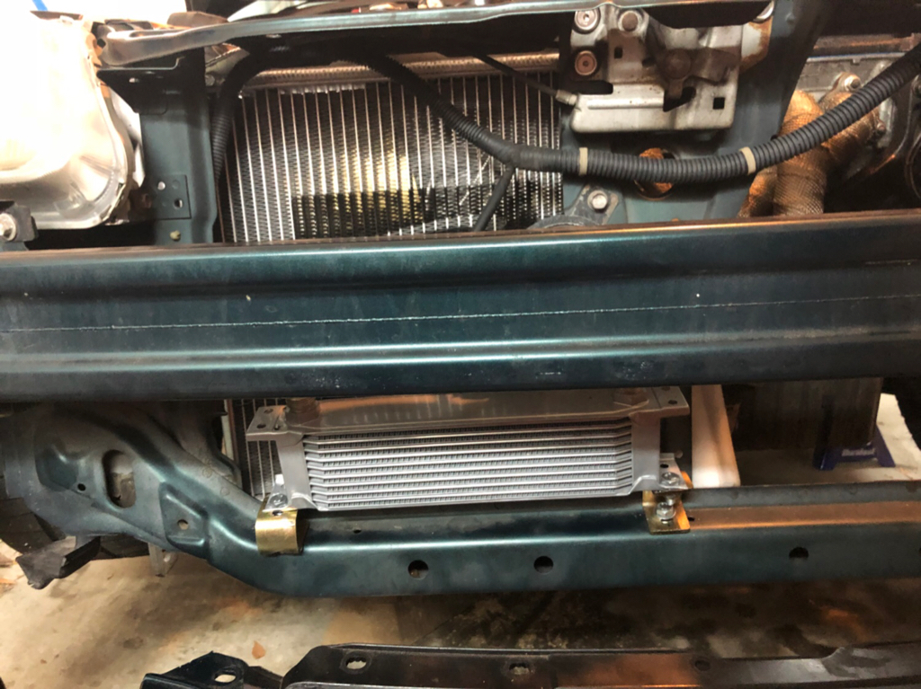

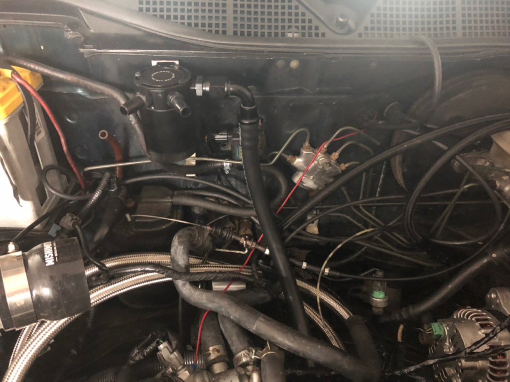

Started installing a universal thermostatic oil cooler kit but ran into an issue where the sandwich plate won’t fit on the back of the block because of clearance issues with the supercharger.

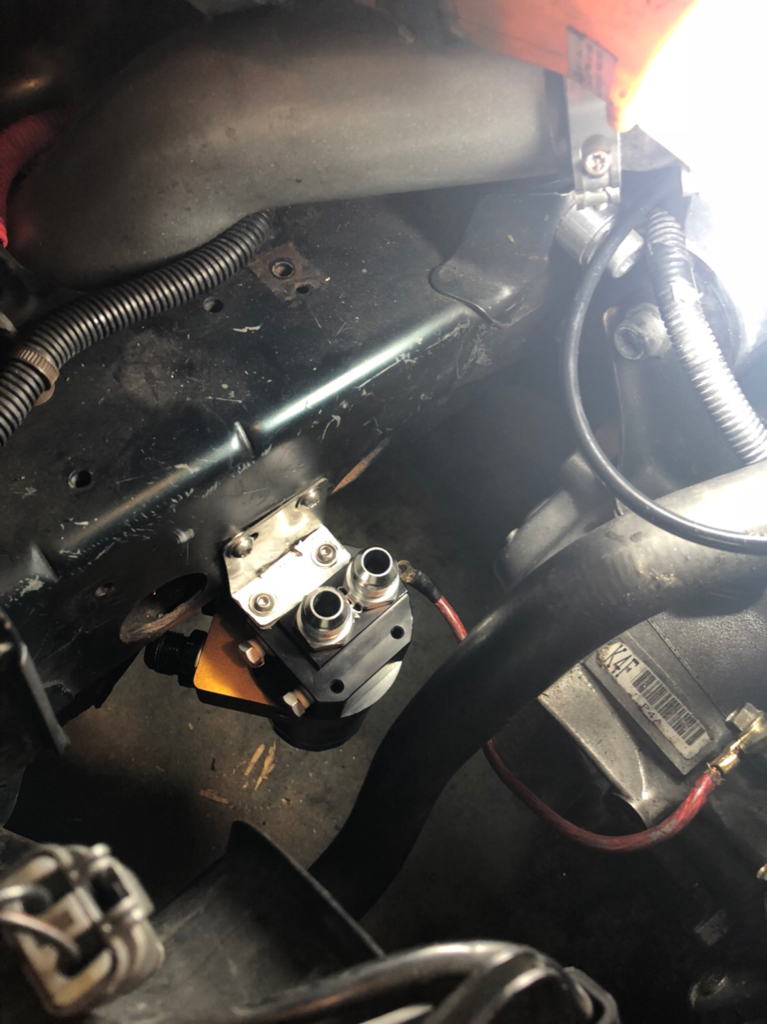

Now I’m pairing it with a remote oil filter relocation. This is my first time dealing with AN lines as well. Waiting on some fittings in the mail to finish up the install but I have my locations for the adapters chosen. The rivnut tool has been coming in handy.

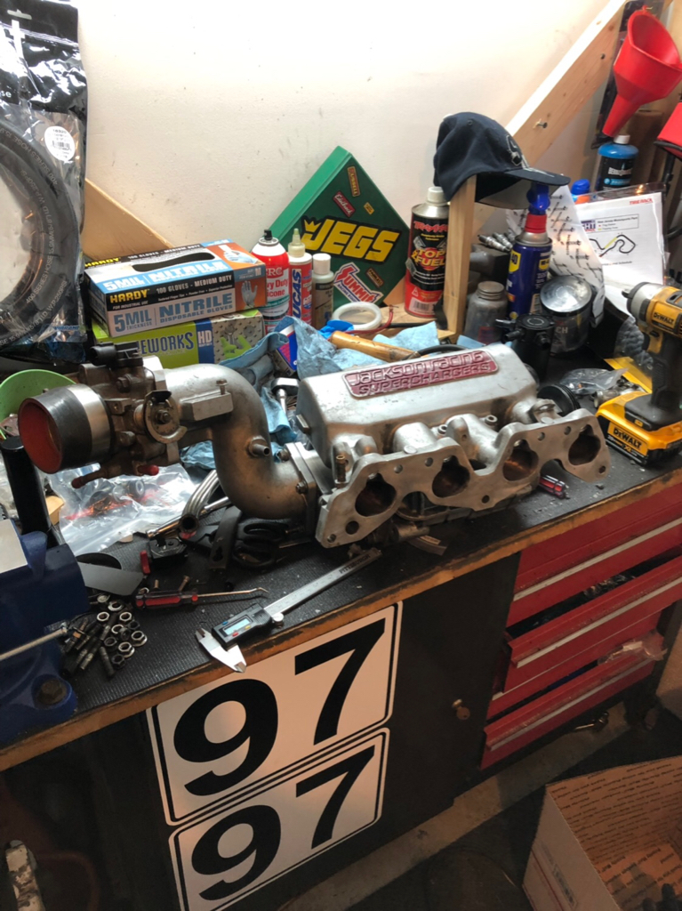

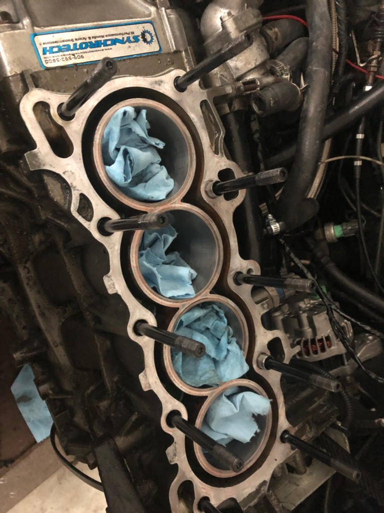

So i should have some updates with this car in the near future. I ran some tests and it seems im leaking about 20% of my compression past the rings. So i;m going to be pulling the pistons for a quick rehone and a new set of rings to see if that makes any improvement. I also may have some parts an services lined up depending on what i find when i pull the head.

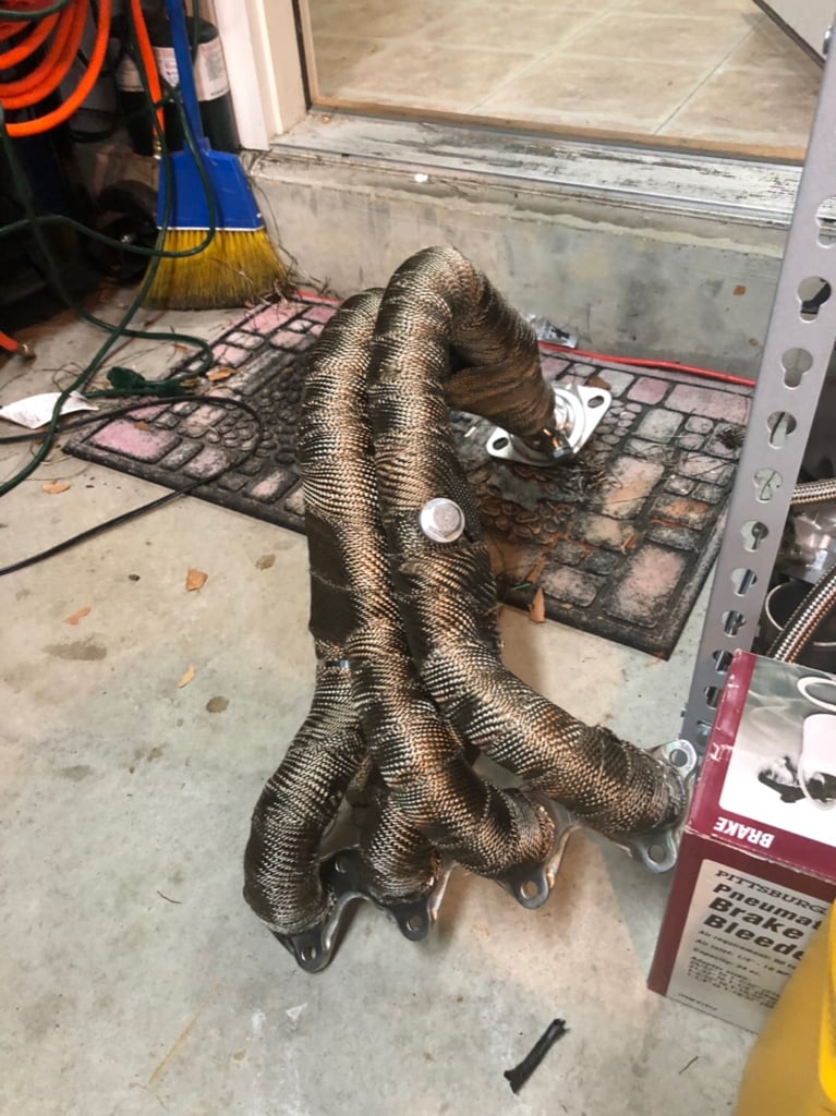

I ordered a new set of injectors to swap out my rc440's that i got from some random guy on craigslist. I also ordered a new skunk2 header to replace my $50 ebay special from 8 years ago that is probably bottle necking the crap outa the exhaust system. Parts should be in next week sometime.
looks like you did a nice clean job on the header wrap man.
