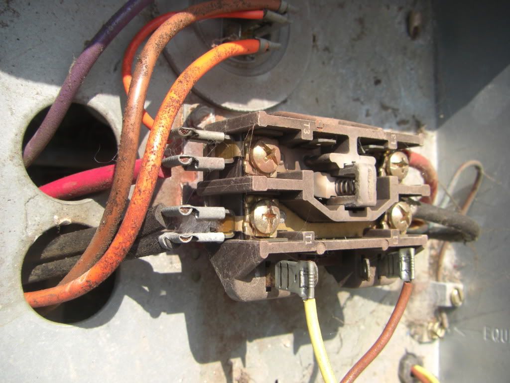

The contactor and the fan motor are bad. To fix it and clean out the unit it is $900. :facepalm: had a guy from the same company come out to tell me a new unit would be $6770. That was a special price too.
After some searching and suggestion from friends I have found the parts to fix both on my own for roughly $250 (internet price) but no parts stores are open on the weekends. So I will have to wait till Monday to go see about getting parts. Maybe, just maybe I might be able to get parts from a friends brother and get a special price on the parts.

Here is one of the parts I have to fix....
This is the other....

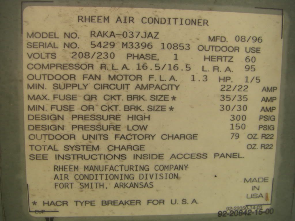

and this is the A/C units tag on the outside....notice the 1996 Manu. date :pat:
