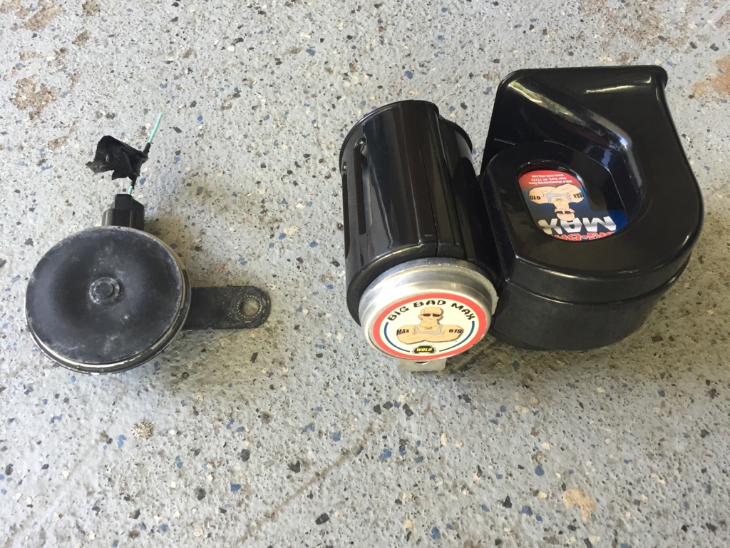

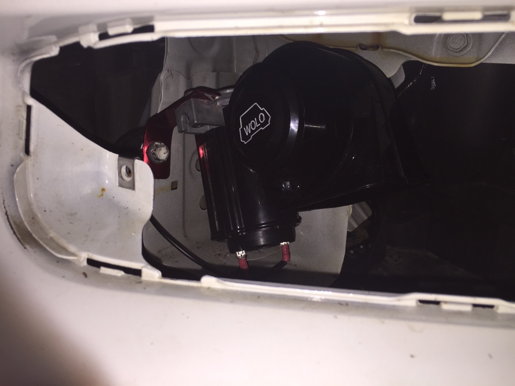

You do not need to take the bumper off, or grill. I unplugged the top (high horn) and spliced in my new horn on the bottom. All you have to do is remove the driver side fog light on the si. I'll post I pic
