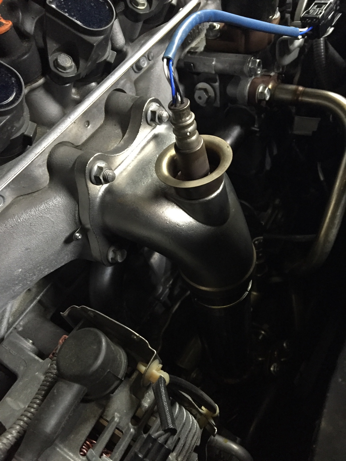

For the top sensor you need an o2 sensor removal tool. I rented one from autozone. I tried to buy one and stripped it. If you have an autozone close go rent one.

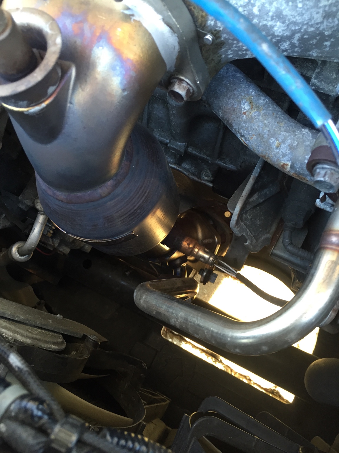

I got the top o2 sensor off, but I'm still not seeing this o2 sensor? I only have 2, one that's before the cat and the other that is at the end of the mid-pipe
I'll get it tomorrow, i ended up using an old o2 sensor from my old Mazda and i used some channel locks to twist the top 02 sensor out...thank god i got it in lol
2014, I got a plug from the auto parts store but yea I'm gonna shoot them an email..i was so confused when you said the hole was for the o2 sensor...i looked far and wide in my engine bay to no avail lol

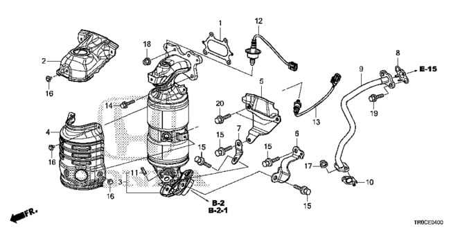

That's weird. If I look up a 2014 sedan this is what I see for a converter.
It should have an O2 sensor there....
Maybe it being an MT would change that? My secondary o2 is way back at the end of the mid pipe
Hmmm I don't have one there. I wonder if there is a mistake in the drawings online and Honda changed something.
