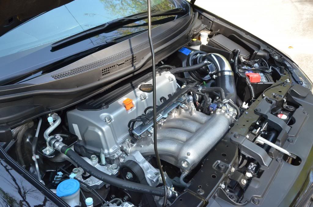

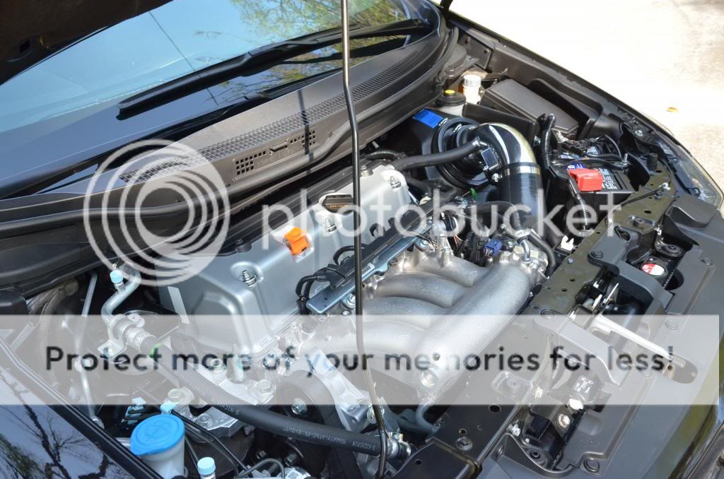

Btw JAYBLS. I'm pretty sure you can make more power with that Takeda intake because it seems like the filter can use 3.5" piping. The inlet of the pipe looks like a 3.5" diameter.
Dar-Dar the ID of the filter is indeed 3.5". It even says it on the filter. That's going to happen first. There will be a 3.5" intake tube with the AFE box and filter first as it shouldn't be too much money.
Kelford 179-a cams are calling my name. I'll bet they'd work very well with this engine.
Just ordered an Airaid 4" UBI tube. It has an inside diameter of 3 5/8", so well see if it makes any difference to switch out the 3" ID metal elbow provided with the AFE intake with a thick-walled, plastic, ~3.5" ID intake tube pretty soon.

By the way, VitViper, the car is running great! Do you think I'll need a new calibration for the larger diameter intake elbow I'm installing?
You might need a small fueling tweak for the intake -- nothing major.

The car is looking great. It seems like a 45 degree silicone would be a better fit to the intake and tb. Or maybe the pic is messing with me. Lol.
The problem isn't the bend; it's the fact that the inside diameter of the coupler is smaller than the outside diameter of the ZDX throttle body inlet.

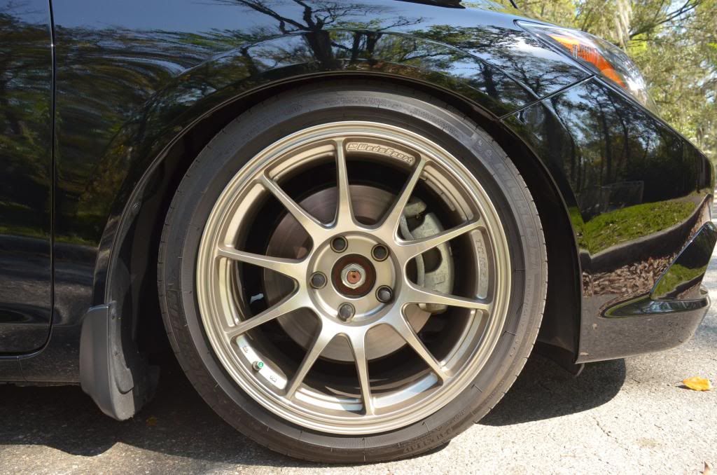

The ride height is absolutely perfect. I like the slammed look as well, but I think it is equal in its aesthetic appeal as my ride height, but my ride height is much easier on the car. I don't like destroying my nice, new shiny things.
