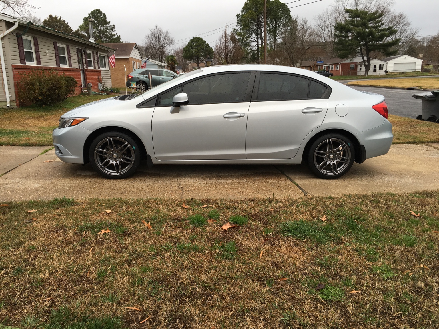

Just put new shoes on her yesterday and had the windows tinted. Going decision is how I wanna drop her and how much.
That is correct.Thanks lol Tapatalk is suppose to be the mobile version of the forum? Is that correct?
Clean. I like it. Congrats on purchase and welcome.
Ya, classy and clean look. That's what I like.

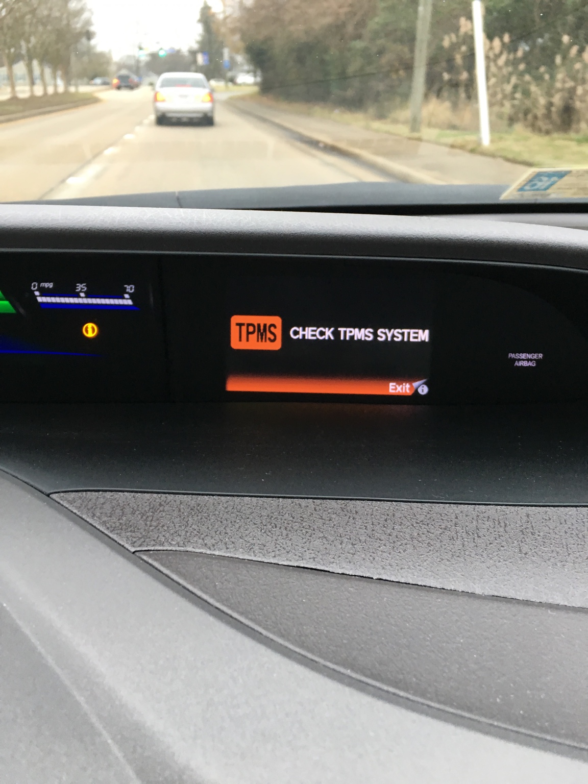

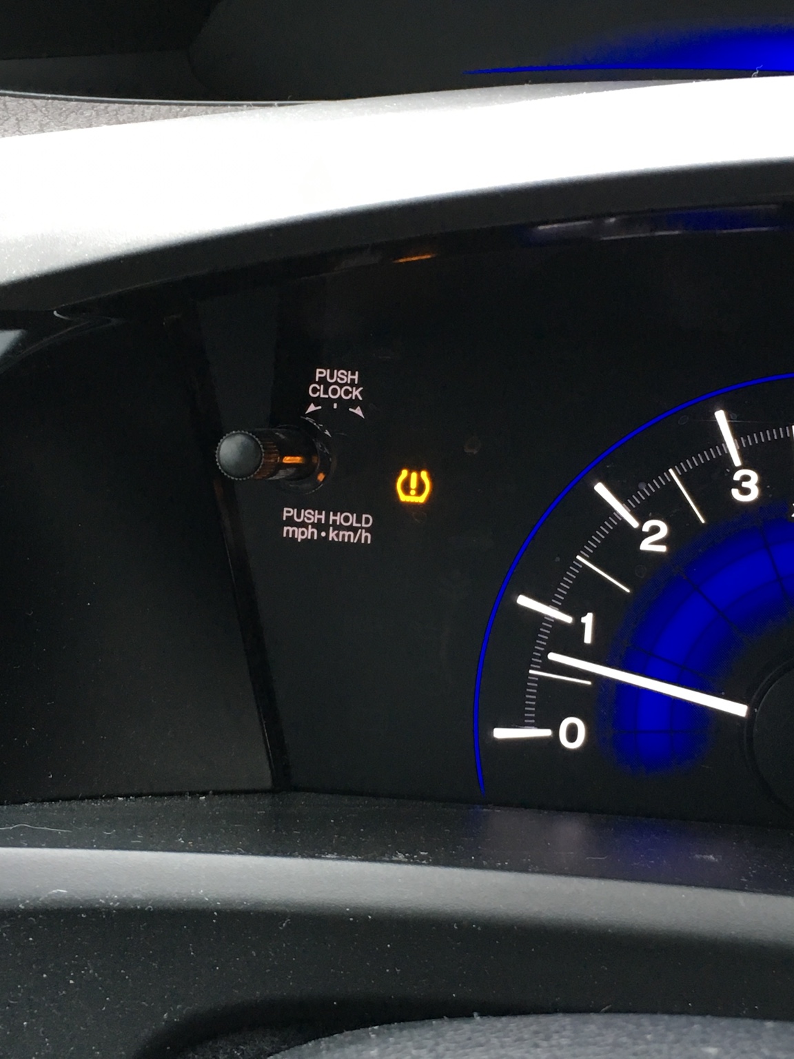

ALREADY!!! first day with them on
Have you gotten them programmed? Whenever you get new sensors you have to get them programmed to the ECU. Just bring an old sensor (in the tire still is fine) to a dealership or a cheaper option would be a place like Firestone (call ahead to see if they can do it) and they'll program the new ones.Bought with new sensors. Is this going to be an on going issue??
You're definitely not the first to have issues with those sensors. Luckily I live in Canada and we don't have those.No I didn't lol goes to show what I know. Thanks for all the help
