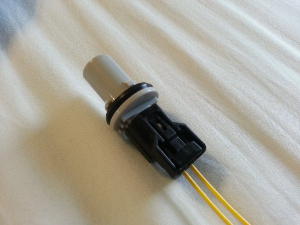

Picked up 04321-s5a-307 and 04320-saa-a00 today. The clip DOES fit the outer turn signal socket but does not fit the inner socket by the DRL. The socket could easily be modified to accept the pig tail by lightly shaving down the small alignment rails on the sides.
Perfect fit!

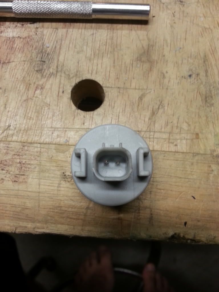

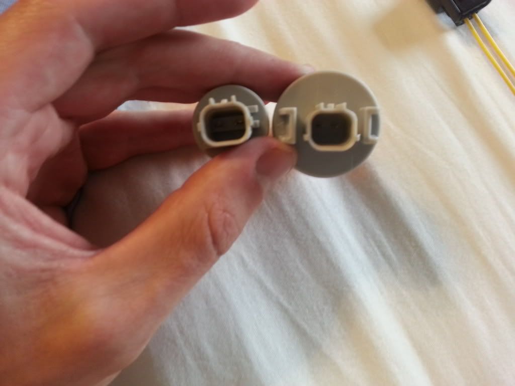

As you can see, the sockets are slightly different but it can be modified to work.
I was able to get the clip to fit both sockets!

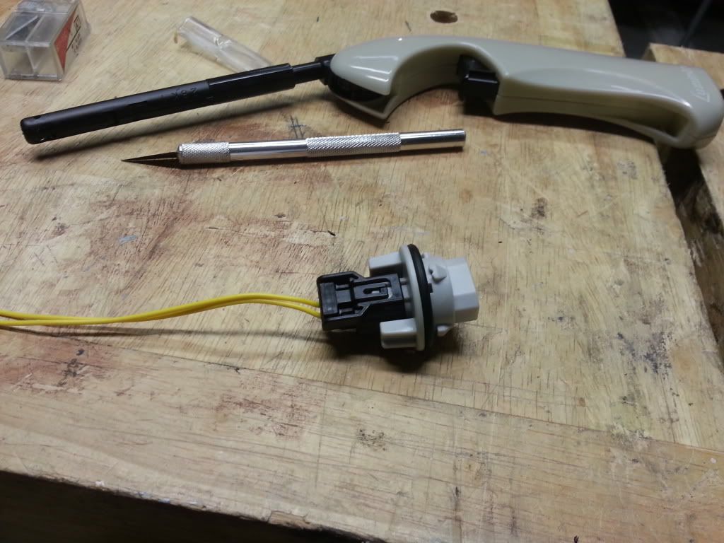

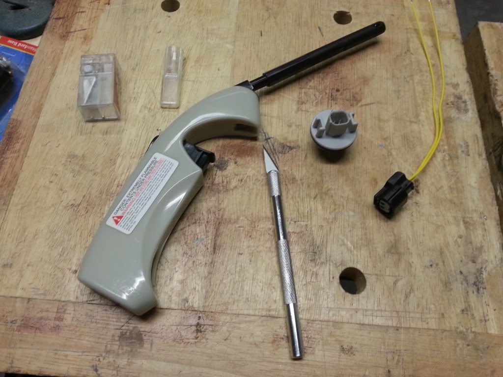

Grab a lighter and an art knife
Heat up the blade so it shaves the plastic with ease and shave down the side rails
Bam!

So I got my connectors. Josh's sockets look different than the ones that came with my lenses.
My outer turn signal is A 3 pin socket, similar to the socket you order for the harness (part# 33303-tr0-A01), but they're NOT interchangeable. The connecting plugs (part# 04321-S5A-306) is a 100% perfect fit. When you order the connecting plugs, you get 5 plugs and 5 of the inside of the plugs you have to fit together with the pins.
The inside parking light is a 2 pin socket. The connecting plug I ordered (part# 04321-S5A-307) is very close, and like josh said above, the rib on the socket needs to be shaved down. You can sand it or cut it with a razor.
You also need the wires/pins/seal (part# 04320-SAA-A00). Put them all together, and you've built your harness!
Very strange that our lights had different sockets :spinning:
