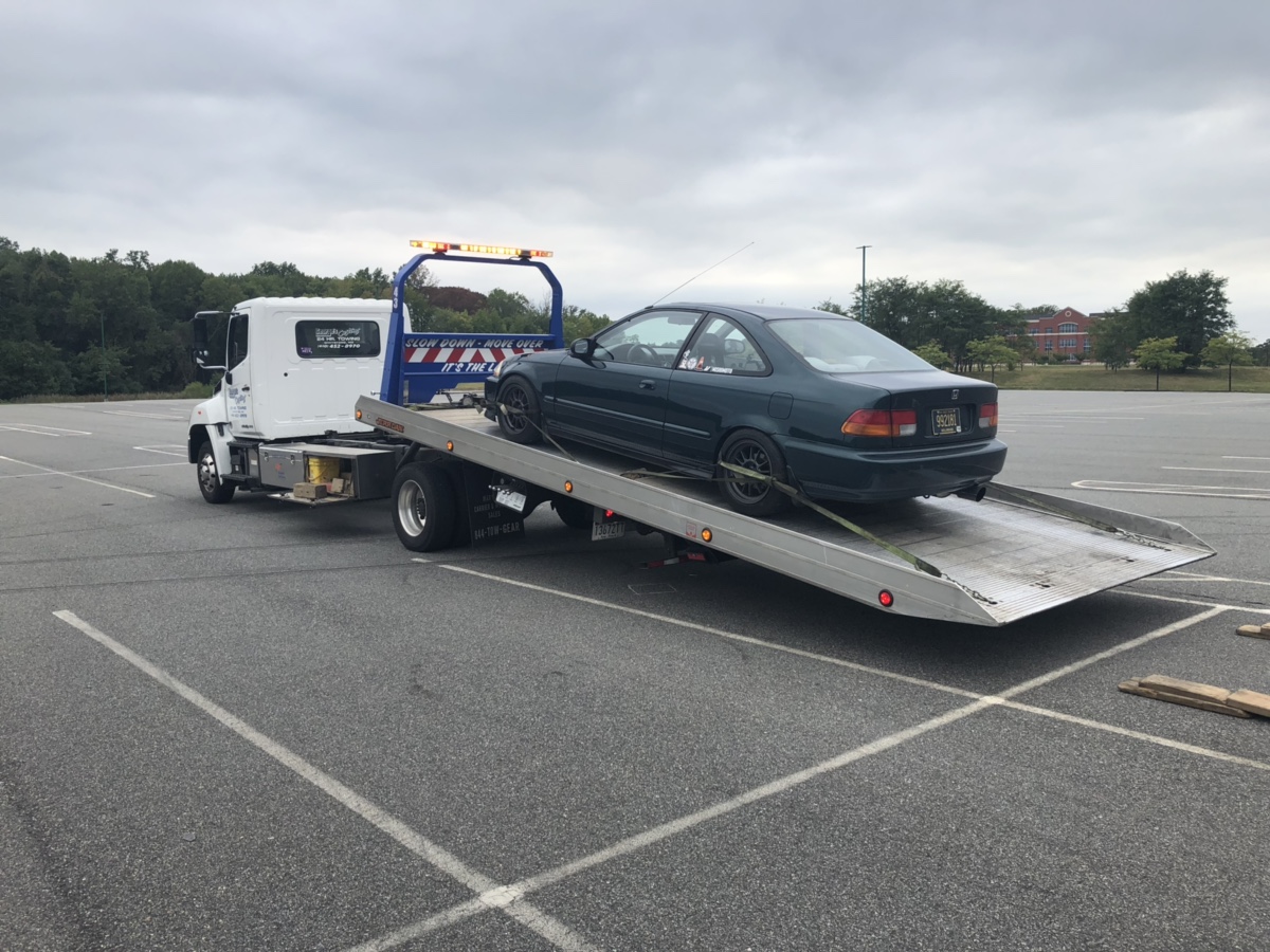

The voltage regulator in the alternator died on the way to the event and was pushing 18v straight to the battery. The battery got stupid hot and exploded as I was pulling in to the parking lot. We ran to the parts store and put a new battery in and it fired right back up. I disconnected the alternator charge wire and ran the car straight off of the battery for my runs. Still managed 1st in SMF but I wasn't gonna push it and attempt to drive highway speed home for 35 mins off just the battery.Story?
Wound up running the Si today instead of the supercharged civic.
