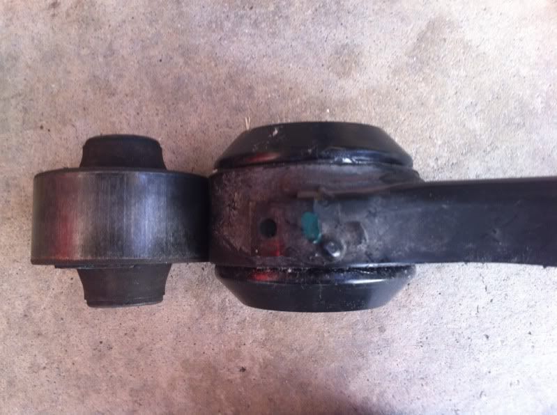

If you're launching hard and you get wheel hop you need to get stiffer poly bushings in the front lower control arm. I don't know that an LSD would improve that. With wheel hop all the suspension and mounting bushings are flexing and getting wound up like rubber bands. When they compress enough they unwind and cause the wheel to lose traction and then momentarily gain it again. Thats the cause of wheel hop. The big LCA bushings on the front are compliance bushings and are meant to be soft and make the ride nice. Energy suspension makes a kit that presses in. The poly bushings can be used in place of a true spherical bearing traction ball.
I have a set. The ride is not pleasant unless the road is smooth but I've not and an issue with wheel hop/slip at all. Better tires can help a ton and is usually cheaper than installing an LSD or the hassle of putting in new LCA bushings. This set from energy should fit the 2012+ front LCAs
http://www.energysuspensionparts.com/8223
Comparison:
LSD will improve 60' in the 1/4.
Edit: should also just beast out on the bushings and go full solid [emoji6] idk if Full Race is still making them but I have those on the car.
