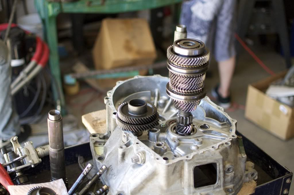

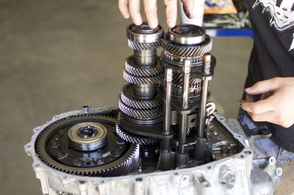

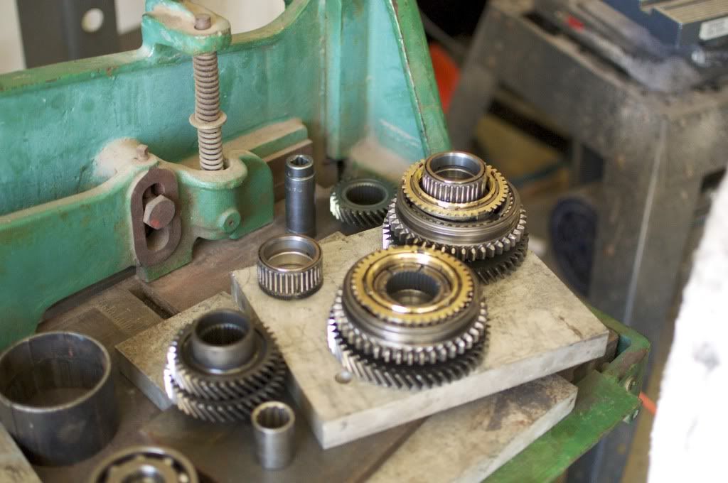

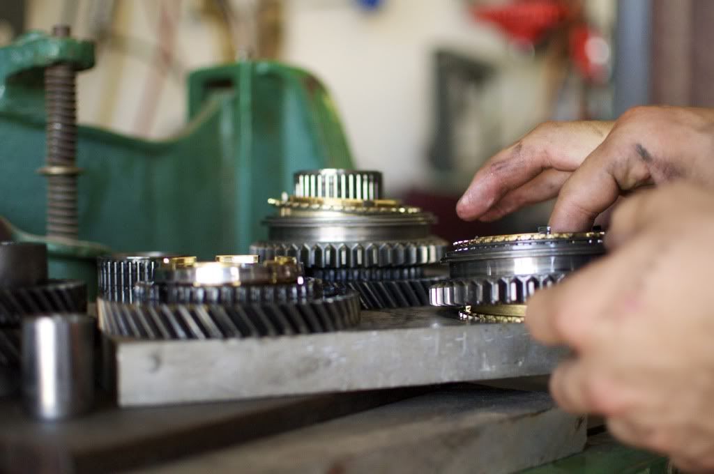

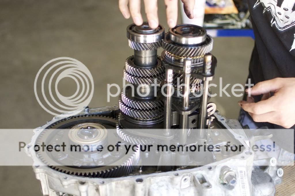

well my tranny has finally broke, time to rebuild it this weekend
yup the final drive and 4th gear are the weak points in the tranny. i would like to switch to a 4.3 fd but then my bbg setting would be all messed up

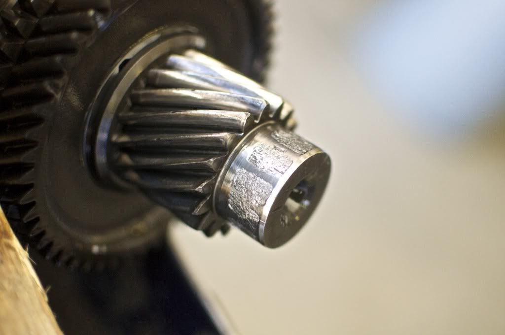

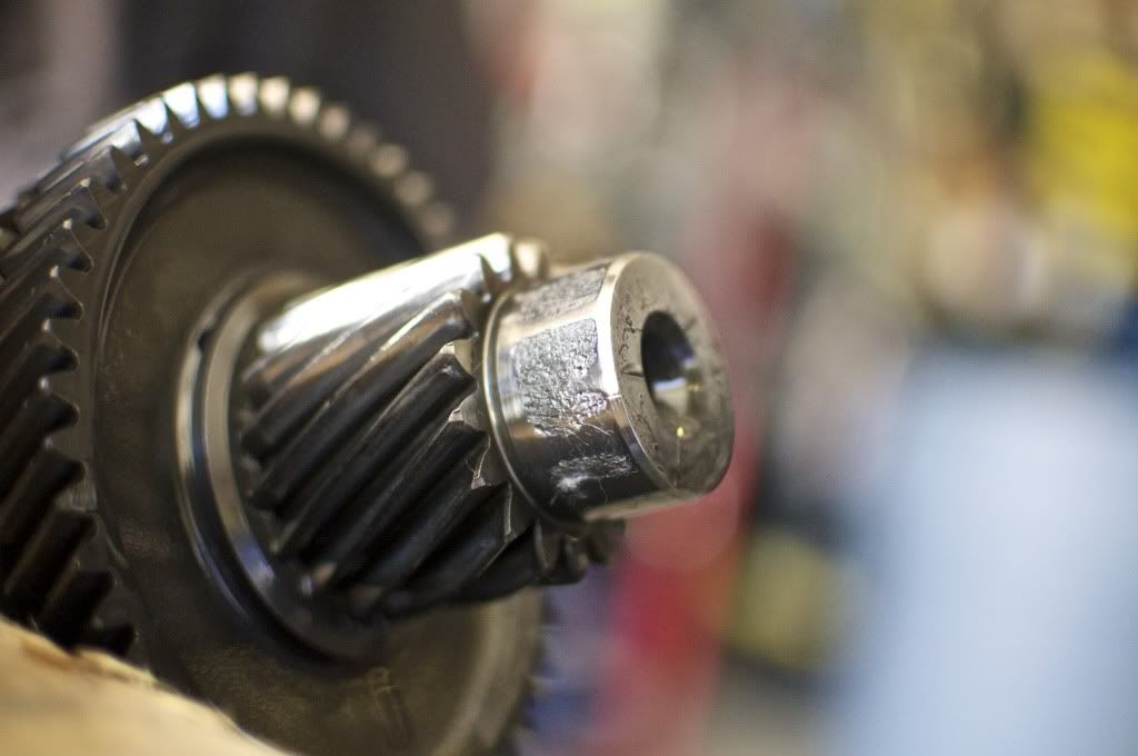

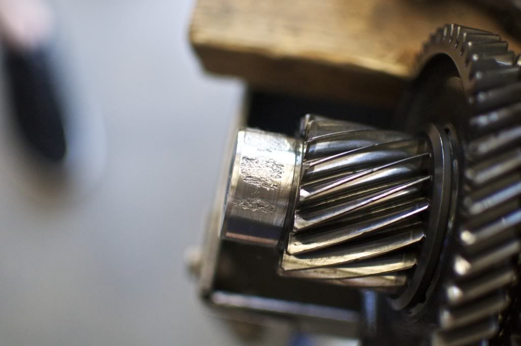

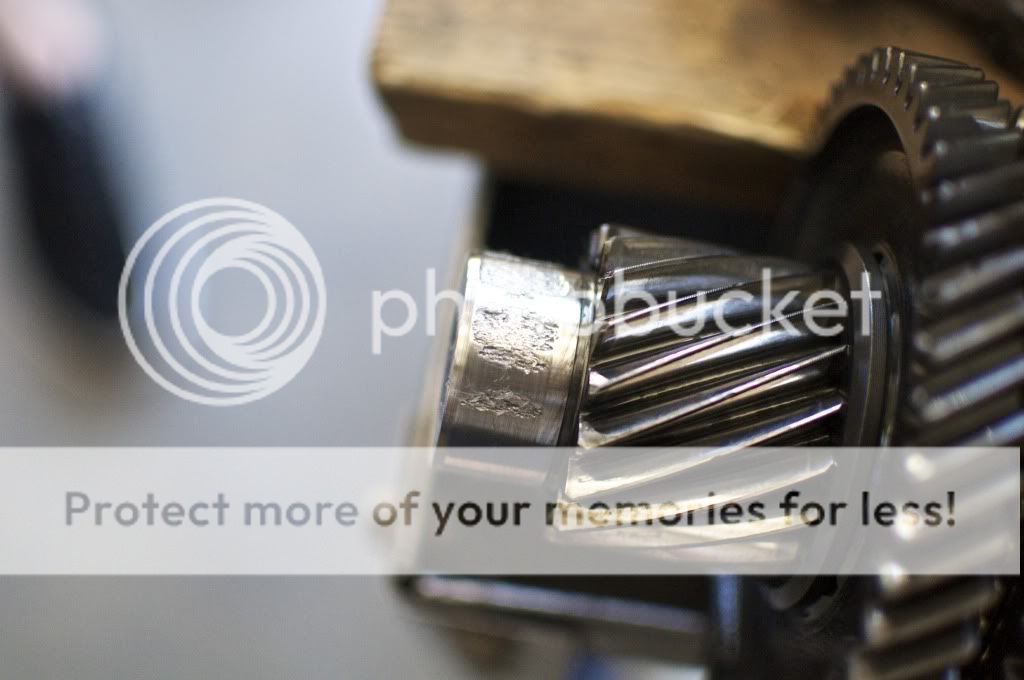

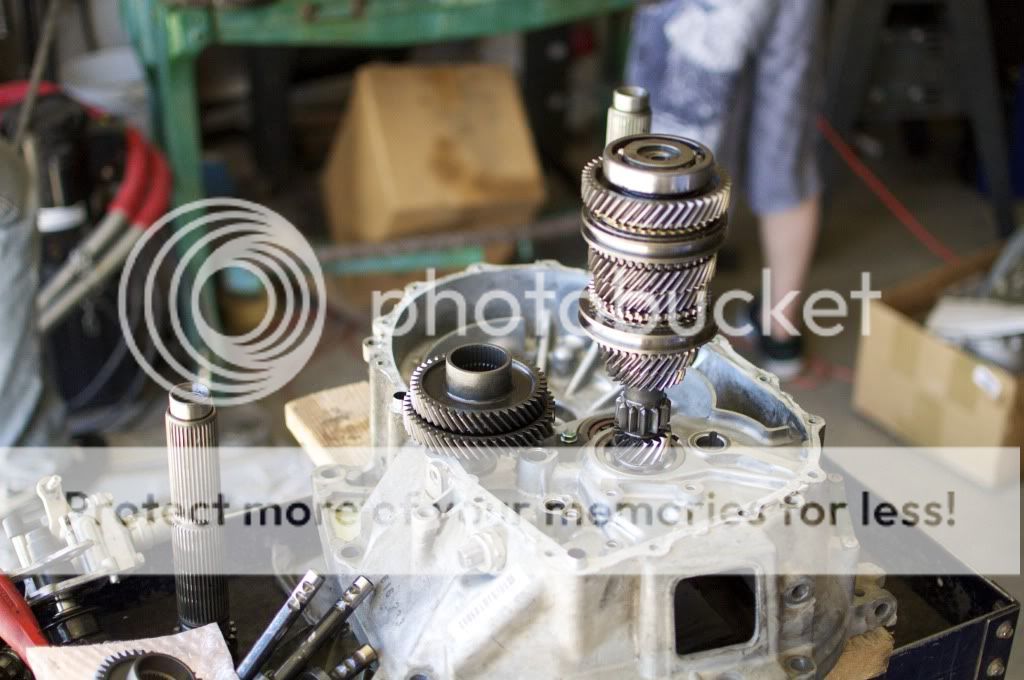

it turns out it was my countershaft that got destroyed. it almost seems like the bearing that it sits in seized up
yea thats what broke and was making the awful sound i was hearing good thing i had an extra one laying around
