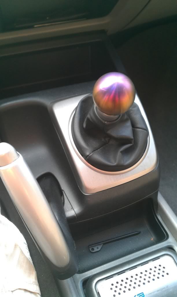

ARC Titan Dull Finish
This knob is actually about to be going up for sale

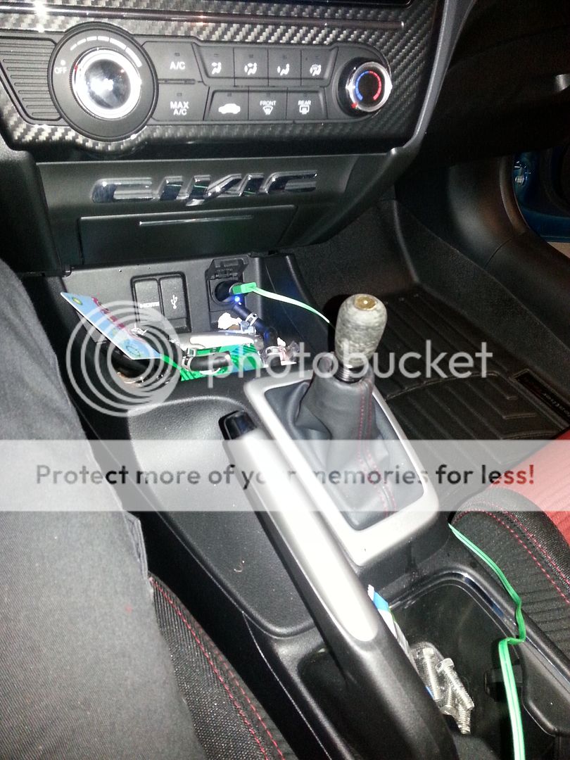

I finished another original handle with the factory knob incorporated in it to make it weighted. I call it the "Microphone" for obvious reasons lol. Very simple to make, used another handle like the first one and trimmed the top slightly (maybe 1/2-3/4 inch of the top) with a hacksaw. Then used a drill press and a hole saw bit to hollow out the top, the bit was slightly bigger than the base of the factory knob. Was trying for a press fit but I didn't have anything small enough so i just took FIPG(Toyota's RTV/silicone for engine work, amazing stuff realy) and filled the hole I drilled with it and stuck the knob in. Whipped away all excess RTV and let her dry. Still need to sand it to get the finish how I want but here she be!
You can also see where i relocated my civic badge and want to put blue LED's under the over hang that's above it to light it up and the storage underneath. I think it'll look nice

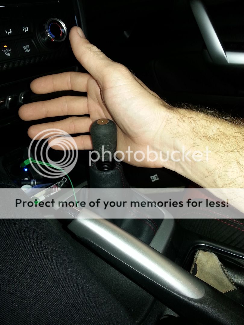

Took the microphone and chopped it real good! Lol, it's the "Nub" now and it's growing on me for such a direct/solid linkage feel it gives.
