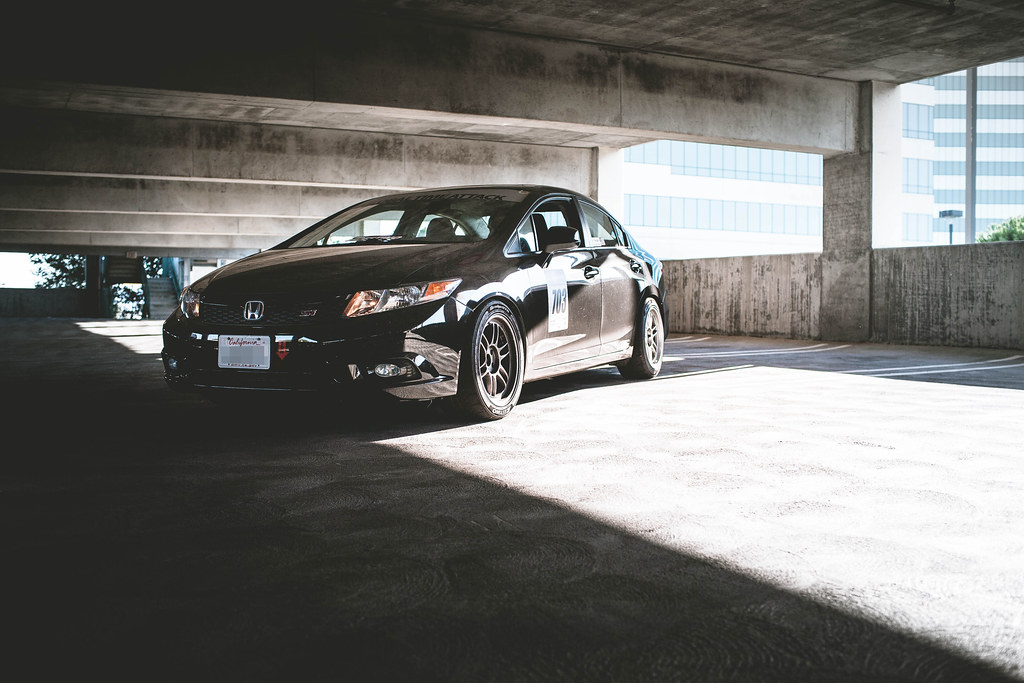

Has anyone got a picture of say.....a +20 offset on a coupe? I've got some...ideas. I know I'll have to run flares, so I'm ok with that. Just having a hard time finding pics
Here's a 17x9 +22 with a 255 tire. No flares, just pulled fenders.
