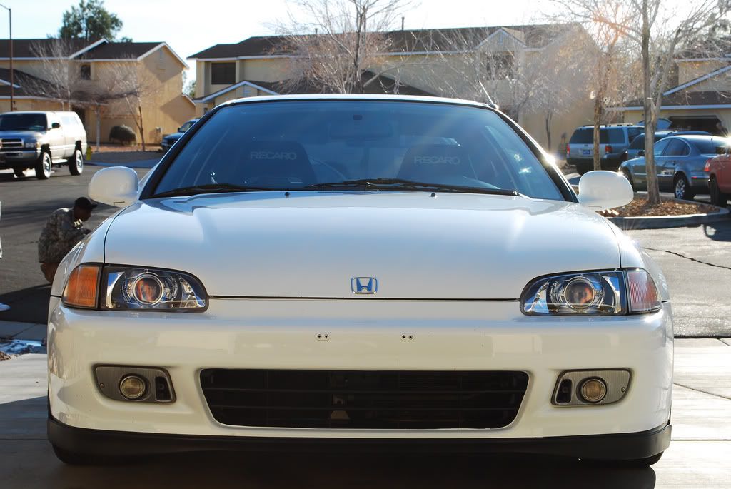

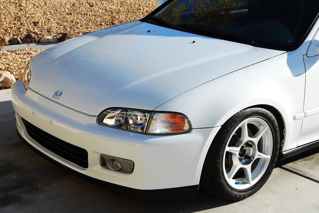

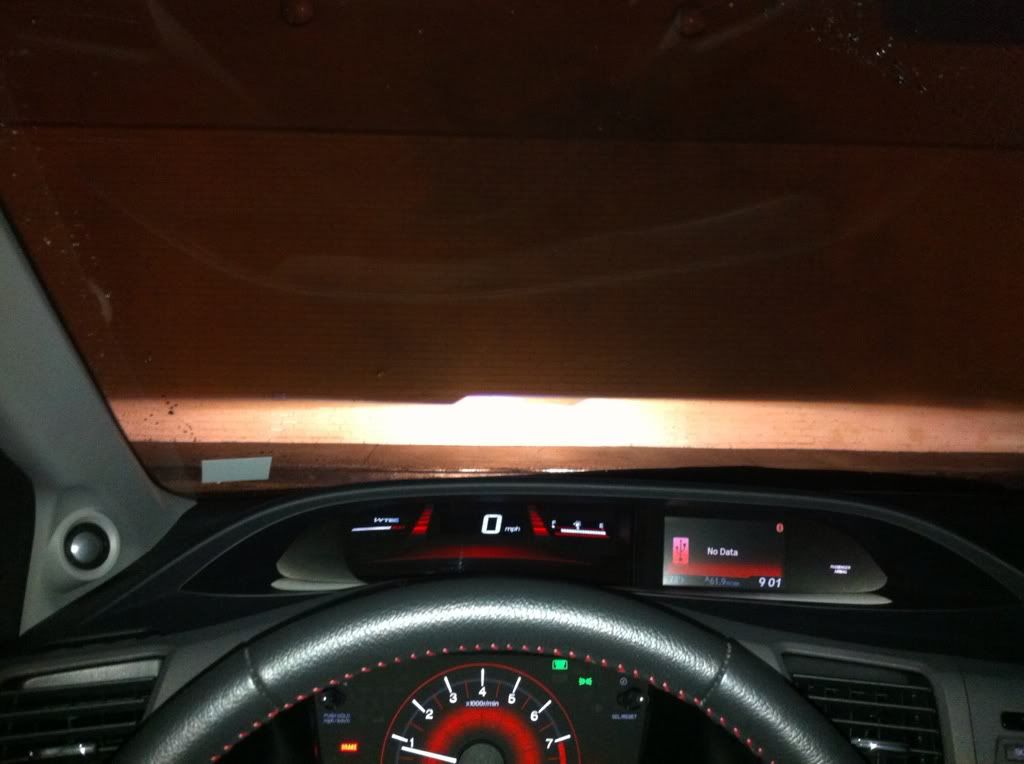

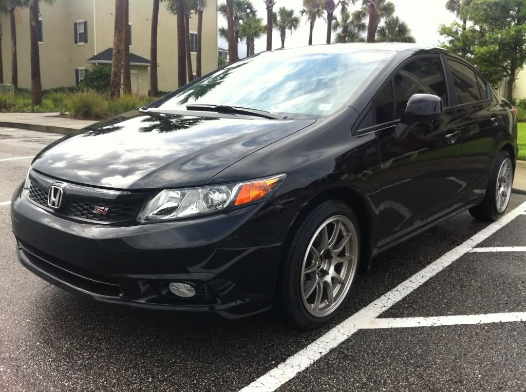

'95 EX coupe - TYC clear lens headlights, Infiniti FX projectors with clear lenses, Matsushita ballasts, Philips 85122+ bulbs

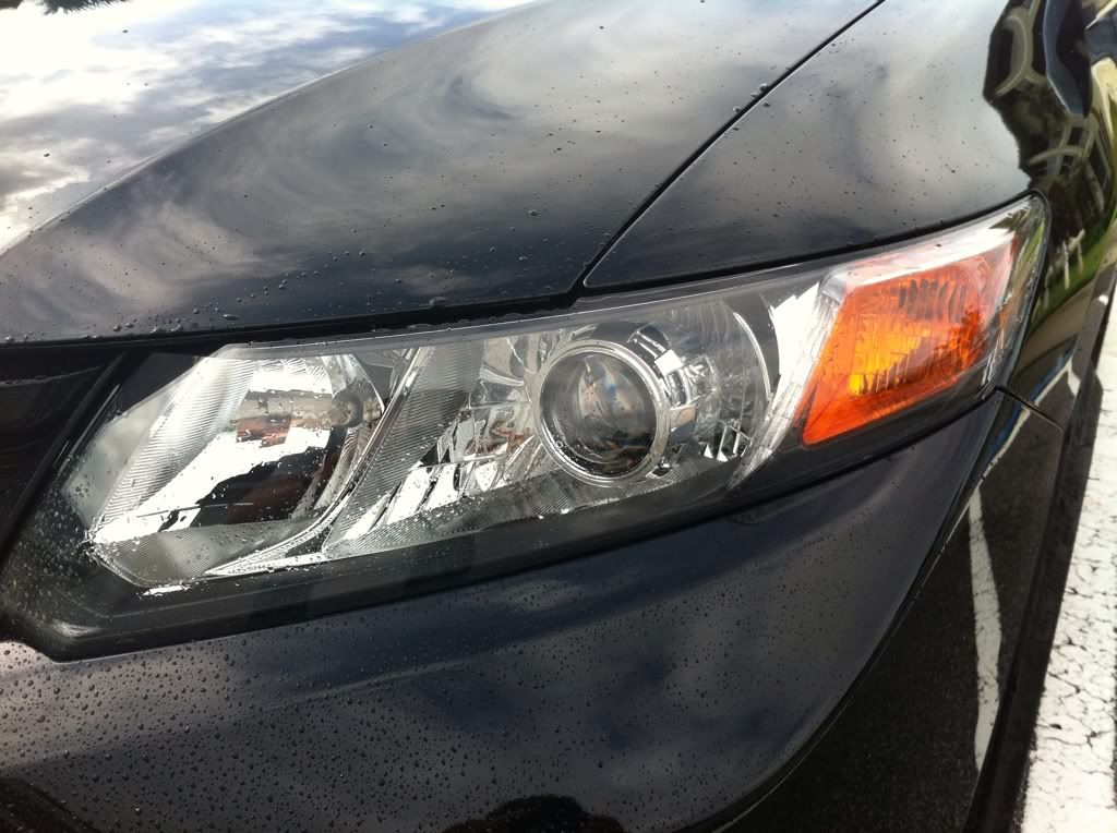

'12 Si sedan - Morimoto Mini H1 projectors (no high beam relay harness), Morimoto 3five 4300K bulbs, DDM Tuning 55w ballasts (I'm not impressed with the light output, but it this retrofit was cheap and SUPER easy)
