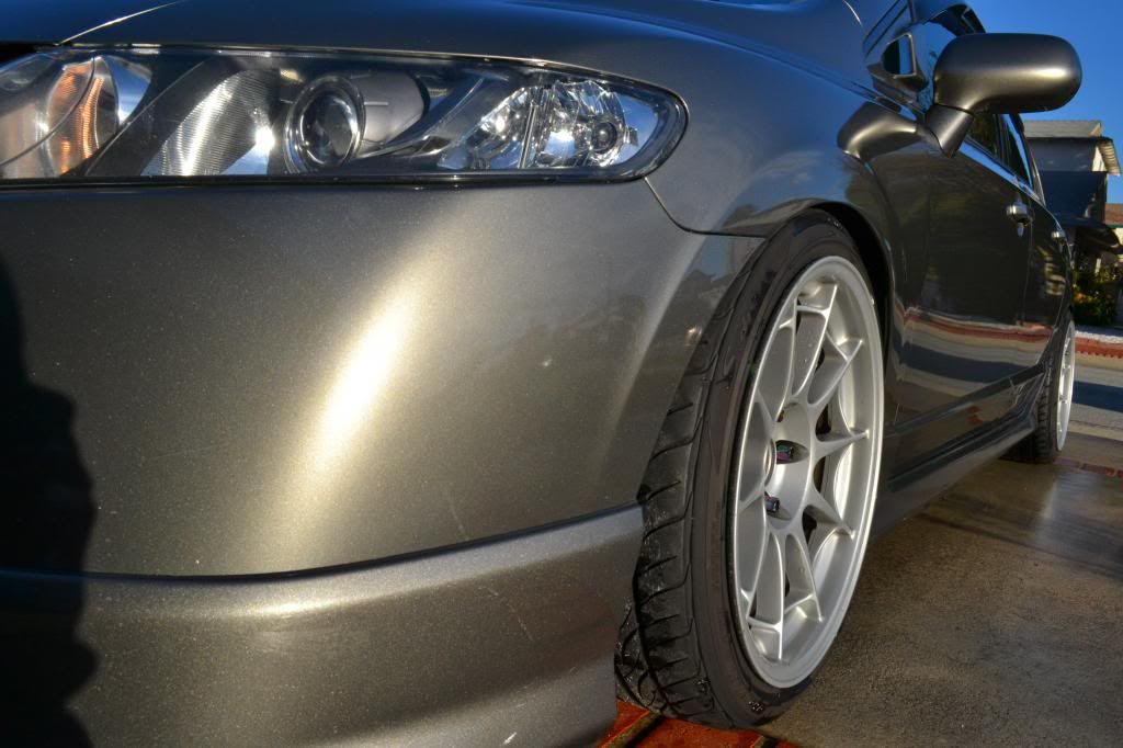

cutting depends on what projectors you use, if you use something like the mini h1s, its just bolt it in, if you use projectors from another car then you will probably have to do some cutting and fitting to get it sitting right.
I have retrofitted two 9th gens and haven't figured out a way to get the Mini H1s in there without some minor Dremel trimming. Just putting that out there in case people were thinking it is just a bolt-in job: from my experience, it's not.
I trimmed the plastic that holds the factory bulb. The nut for the projector could not fit if I didn't.
No, the part that's molded into the back of the reflector where the stock bulb goes. It's not black from my recollection. The area where the threaded part of the mini h1 comes through the back of the stock reflector, the nut will not thread on without trimming the little bracket-kinda-thingies that hold in the stock bulb.

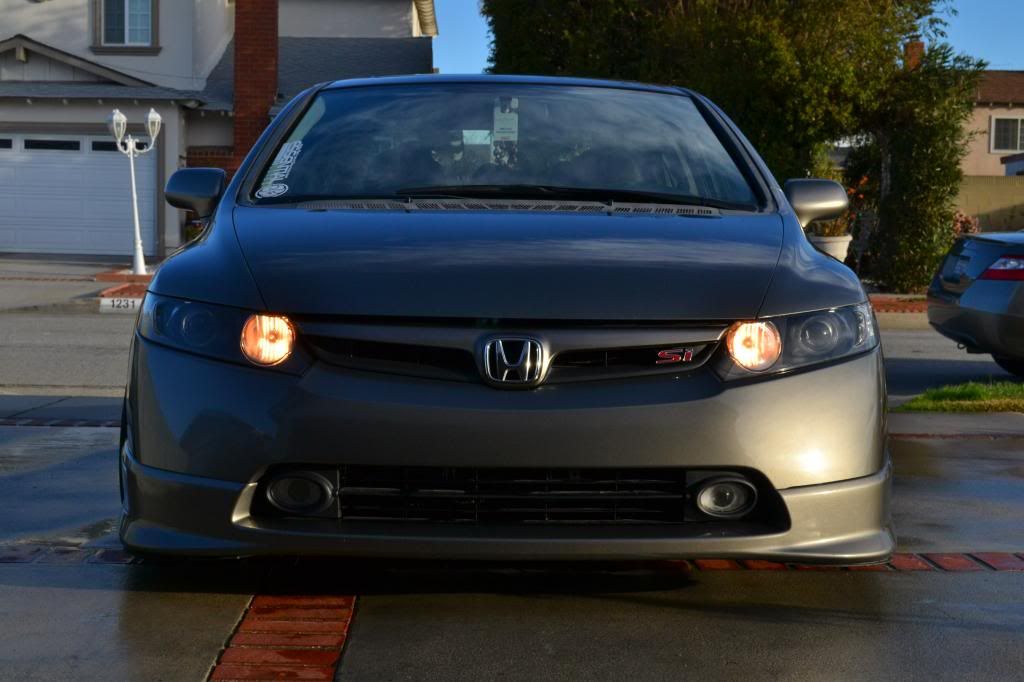

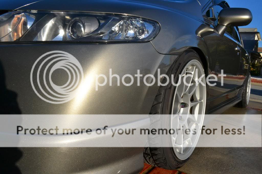

this was taken by the function/form guys
Was anything done to the amber reflector? Looks a little darker than normal.
