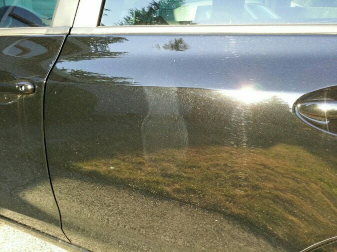

There is an area on the door that is lighter/reflects light differently as you can see in the picture. For a long time I just thought it was a reflection from something, but finally realized it isn't. This is only visible in direct light like pictured, otherwise it looks fine.
Any opinions on what it is and how to deal with it? Should I go to Honda, or is this perhaps something I could correct myself?

It is possible I'm wrong about that being some kind of reflection. I think it may be a window on my house since I always park within six inches of the same spot... Unfortunately I just lost the direct sun...
It does look like a reflection of light, but that could just be the picture. Try and see if you can replicate it at a completely different place and if so, hopefully you can replicate it at the dealer because a paint defect would be under warranty
Yeah, it *really* does look like a reflection and that's what I was sure it was, but I got convinced it couldn't be... I'm almost certain now that it is and I think I know where it's coming from, so when I get home tonight I'll back into my spot instead and see if it's still there... And grab a big piece of cardboard to see if I can block the source just in case it for some reason doesn't show up. I kept telling my spouse it was just a reflection, but she got me to second-guessing myself... ;-)
It looks like they may have done some PDR on the panel. Often they have to compound off the mark/glue they leave, and if they don't finish it down it can look hazy like that. See if you can get a few more pics from different angles and in direct light. If that's what it is you simply need to polish it....

As is usual these days, I've been really busy, but I was able to verify that this is definitely some kind of paint issue. I reproduced the issue in a different location...
I can take some more pics for sure, but before I spend too much time on it, do you think it'd be better for me to just take it back to the Honda dealer and have them look at it, or are they likely to just make it worse? If I had more experience polishing (okay, any experience at this point), I'd consider trying it first, but my main concern is that if I attempt to polish it out and it doesn't go away, they may think that I did the damage... Of course they're also the ones who put 90% of those swirls in the paint with their crappy car wash...
