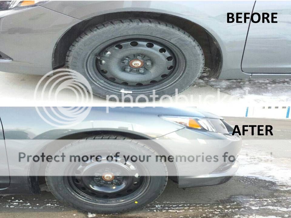

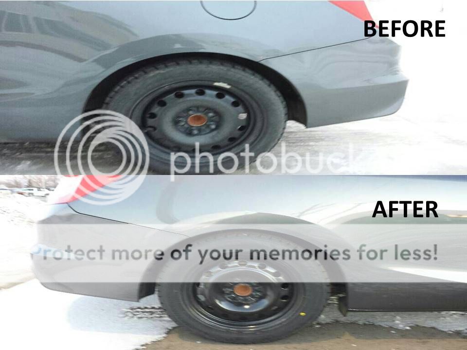

Today I had my suspension installed. Holy cow! MIND BLOWN! I feel like I have a different car now. I can feel a symphony of bumps on each of my four tires now. The chassis is stiff and ridged. I know it is not possible, but my acceleration seems like it was impacted as well. It appears to take off quicker now. The drop was only an inch or so, but it just...feels different in the driver's seat now. One word describes this. AMAZING! I am extremely happy with my purchase. Here are the much awaited photos!
