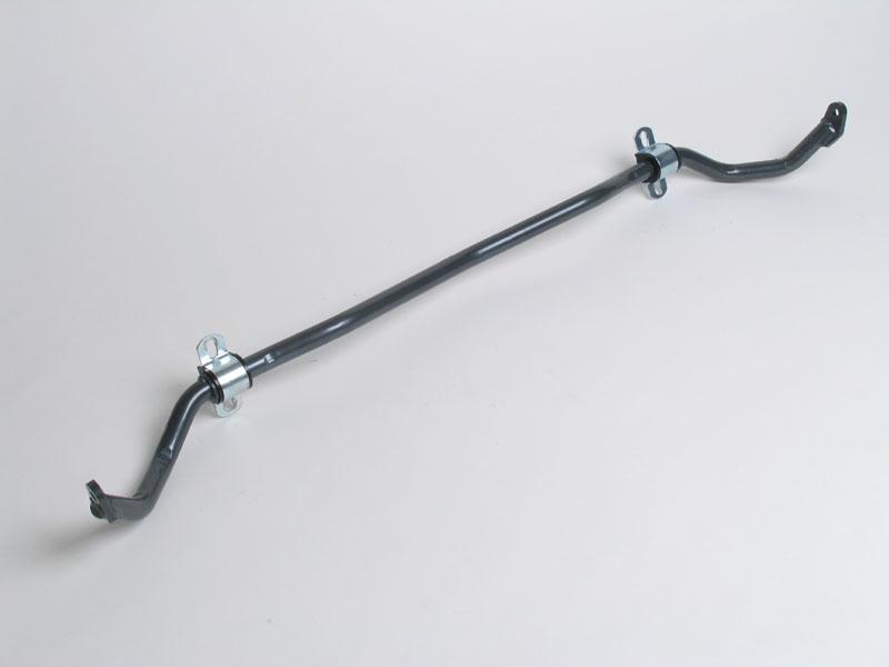

is it the piece under the silver clamps ^ ? That's the pic off the progress website for the 8th gen.
Yes, the Progress kit contains new bushings and new c-brackets (the metal around the bushing).
Now it also includes small adapter plates that make it a direct bolt on to the 2012 Civic EX/LX. That's very cool. :) A customer told me so, and I just looked at our inventory...sure enough, Progress is ahead of the game and making it easy for non-Si customer. :)
