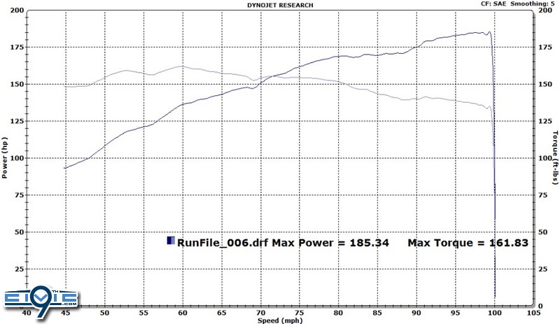

20120503- Reflash Dyno
Vehicle: 2012 Civic Si Sedan
Location: Rio Rancho New Mexico
Altitude: 5400ft
Dyno: Dyno Jet
Mods: Hondata Flash Pro
Owner: Royce

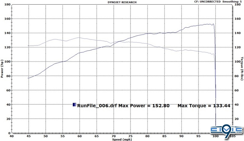

Dyno with the Hondata re-flash. Not much gains, especially being at high altitude. Hondata claims there will be a zero performance gain however we saw a minute gain of 5hp and 1tq. I still am impressed with the torque gain down low though, if you look at the 2 graphs side by side in comparison to stock theirs a good diff. And the graph is smoother even on the same smoothing scale of 5. Correction factor of 1.20 Same as first Dyno
Corrected-
Uncorrected-

I'm actually fairly impressed with the gains, given the high altitude. With the 8th Gen Si, the reflash essentially gave better mid-range performance (i.e. increased the area under the curve on the dyno graph). There was not much to be had at higher RPMs just with the reflash. However, it looks like this 9th Gen Si reflash does have the potential to give some top-end gains.
