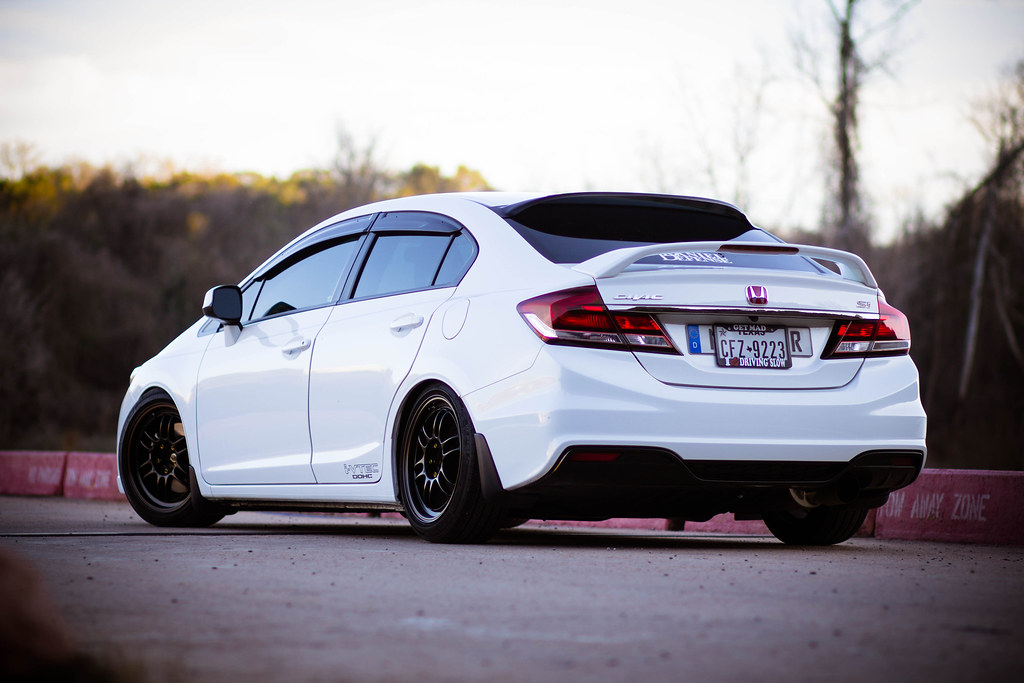

i like them both! i understand the difference and the pic of them on that type r look really good for the 8's. 195/50 is that a track tire?
i should take into consideration that the 17 incher will probably look more small on a 14 sedan.
i actually love the wheel fitment and the way the car sits. these are 17x8. almost makes me regret getting the alabaster silver. thinking im gonna aim for this setup!
i decided 17x8 35mm offset in black like in the pic above.

the photo above is running on the stock tires from a 2013. doesnt look bad in my opinion
